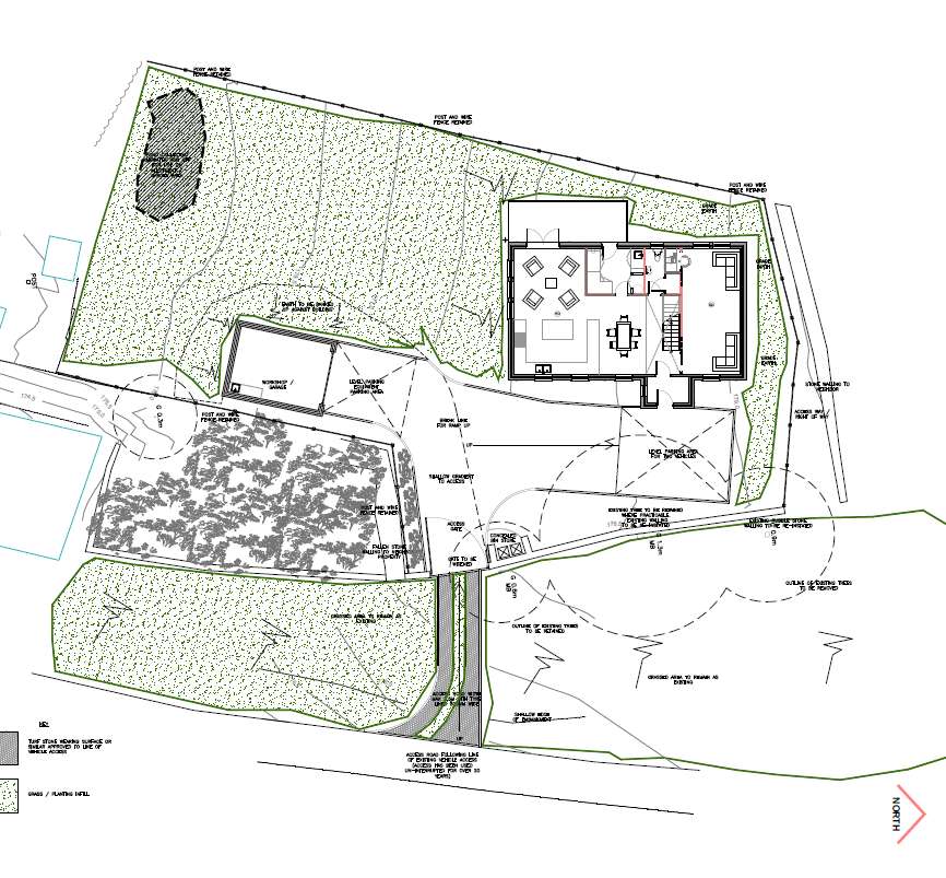

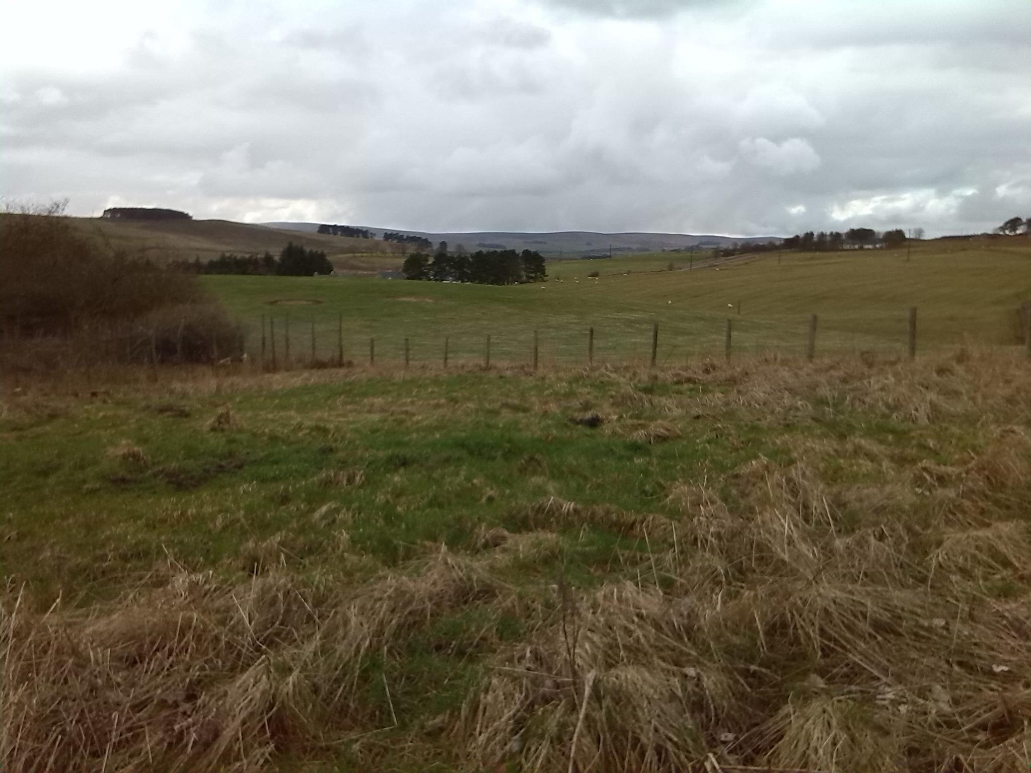

Definitely my biggest ever project, we are about to start a self build. Unlike the Grand Designs stuff, and not being rich, a lot of this really will be a self build, ( a term often misused to describe custom build I feel) though with working full time and not being an expert by any means, naturally we will be using builders for the walls and roof, but all the internals will be done by me, my father and the occasional friend hopefully. The main structure is to be SIPs (https://en.wikipedia.org/wiki/Structural_insulated_panel ) and the outer is natural stone (we're in a National park, but also nothing else would really look right near a Norman church and fortified medieval tower).
Looks amazing, hope you've got a good lawn mower!
What stage are you at? Got planning and a start date on site?
Well after 3 years of to-ing and fro-ing, we now have both full planning permission (more complicated because it's in a National Park with a very strong restriction now on who can build a new house, and of course, what it must look like) and building Regs Clearance to start. Finalising the finance now and one last builders quote for foundations etc awaited next week. After such a long haul, now we're finally there I veer between excitment and moments of terror at the thought that once we start, that's our life savings committed... and if it over runs, unlike those Grand Designs and self build programmes where they suddenly find another £50k or whatever, with us there's NO more money! :LOL: But you only live once eh? I hope to put the first spade in the ground within 3 weeks...

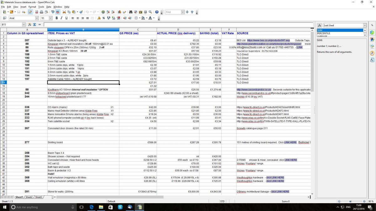

Today I am working again on another spreadsheet - this time for the building society who want you to tease out the exact costs - so for example we know the total quoted roof price for the guys to do it, but the building society wants that teased out into the costs of slats, laths, leadwork, membrane and so on. What's interesting is we've had a proper costings company go through the plans, done a very detailed spreadsheet ourselves, and currently doing the building societies one - and they all come out at different sums! With the same data put in but broken in different ways and different contingency sums automatically added to the various stages.
On the subject of costings, just 2 nights work going through the internet reduced the materials prices by several thousand. Here is just part of the spreadsheet I created. This is using the Quantity Survey costs (mostly they used Jewsons) with what I could get by shopping around, and a column showing the savings - they really add up!
