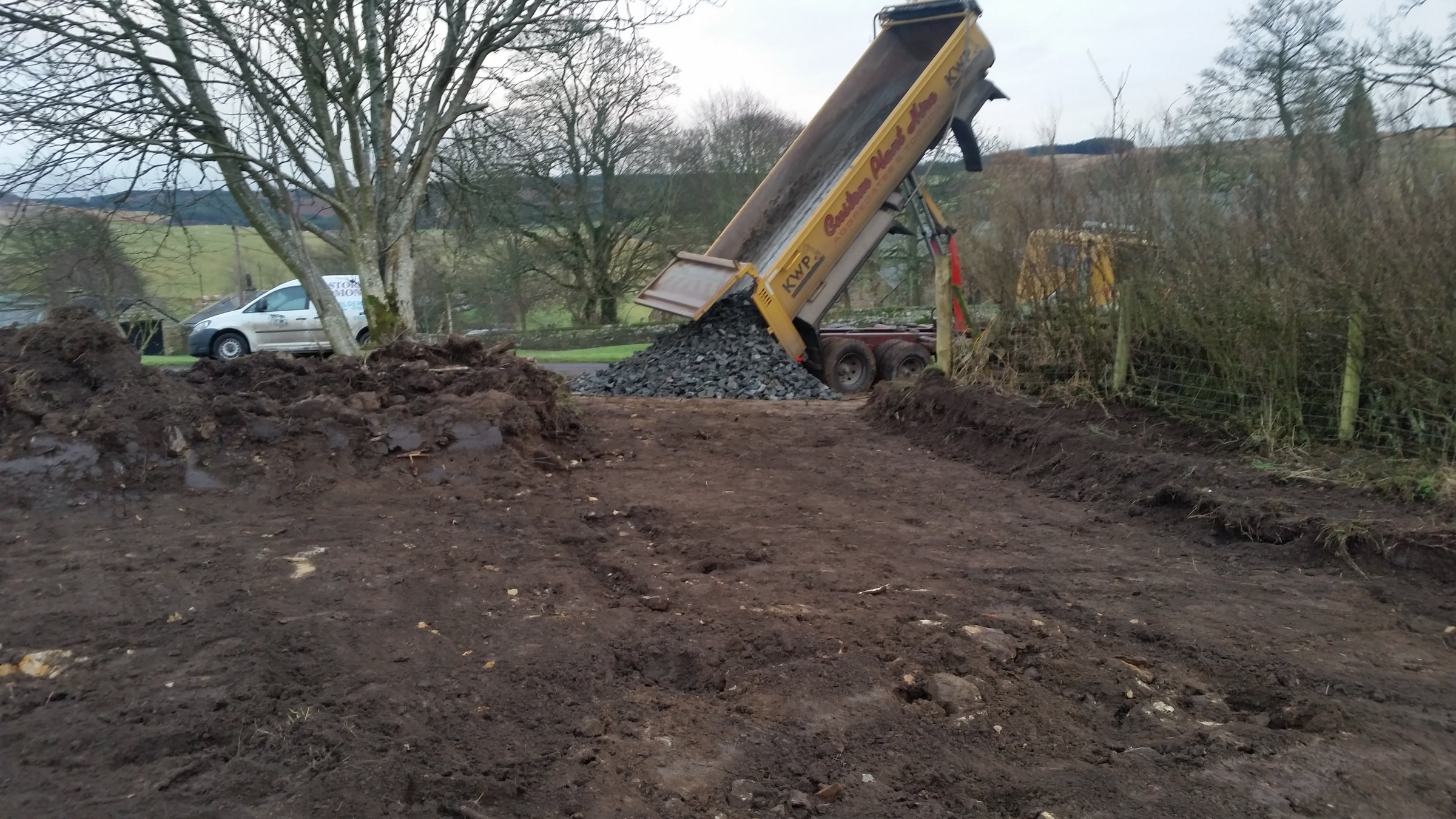

Well, start made on the practical stuff today with site clearing and the track putting in. Great to be finally doing real stuff after 3 years of paperwork and subsidising desk jockeys (notable exception to that being our architect who has been hugely helpful and kept our sanity at times).
Amazingly the site has been stripped and the levels done (a LOT of material to be moved due to us having to have part of the house set into the bank) in one day and tomorrow the foundations to be dug and Building Regs guy approving them, (fingers crossed, though no reason why he shouldn't really) possibly even poured the same day! After so long getting to this point it's quite amazing to see what can be done in one day. After the foundations we will have a delay whilst the timber frame (SIPS kit is made) but that's fine as I can be digging drains etc, so plenty to do. A good day today!
Well, seriously impressed with the builder, huge quantities of earth moved and foundations poured today. Currently we have our own Motte & Bailey castle at one end of the plot! Building Inspector arrived for our first inspection and much to my relief was a nice sensible guy who discussed some workarounds we'd done and had a good look at things but was clearly a very fair guy and keen to help us do the right thing. gave me some advice for the parts I will be doing too. Gave his blessing to what had been done and by 4p.m we had the foundations poured, only the 2nd day after it was all grass! Can't believe how lucky we've been with the weather in mid January too!
Luckily no less than 3 people came by today (a lot of dogs coincidentally get walked past when you start work on a plot :mrgreen: ) and asked if I could let them have some subsoil and some topsoil, so with luck I may end up not having to pay to have any taken away. I'm seriously impressed with the skills and work ethic of the digger driver and builder. I don't know if I'm allowed to name them on this forum so I won't but if anyone is having work done in Northumberland I'll be happy to pm you the name of the firm.
So we have a bit of spare topsoil and subsoil :mrgreen:...... But actually, there is some landscaping to do near the very end, a big pond and so on, so we'll not really know how much is spare for quite a while (the garden end of the site needs raising quite a lot to level the site fortunately, and a few people have already asked for several farm trailer loads for various jobs, so that's handy).
So from bare grass not even marked out on Monday to this by Friday:
