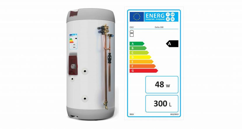

fuse blows after installing timeswitch
No insulation is perfect so it will start cooling down and switch on again. If you are not in during the day it is better to time if off when you leave and on again shortly before you get back.
Even better to switch it off before the shower so there is less heat to escape in the mean time.

according to the manufacturer standing heat loss would be 1.25 kwh/day at 65C, probably slightly higher due to loss on pipes but yeah, even assuming the cost of electricity will ramp up quite a bit in the next few years its likely not going to be a massive difference. the timer was around £30.

That timer is probably not designed to supply two elements, from what I can see - if you were to remove one of the two browns from the rightmost terminals and add a connector to make sure it is insulated, it would enable you to get one of the two elements working temporarily. If you can check and make sure it is the brown for the shorter element, even better, but...
so I've removed the wire on #1, the timer is on override always on. it shows to be powered and on from its LEDs without fuse issues,
but 3 hours later I can't tell much of a difference in terms of water temperature, I'm not sure if I'm missing something here. is the insulating connector necessary?
I'm trying plugging 1 back and removing 2, it might be too early to tell but doesn't seem to be doing much either..
say I wanted to temporarily reinstall the original untimed switch I posted earlier and have a shower, how would I go about wiring that correctly?
