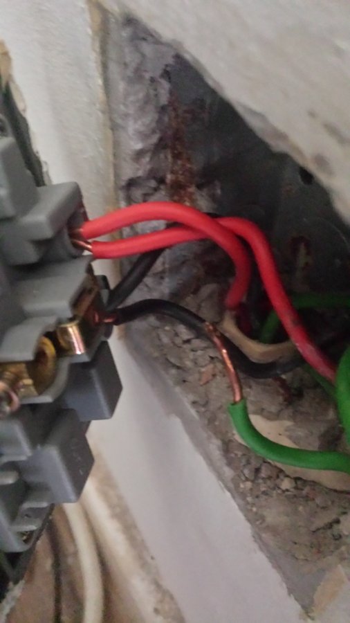

Hi I'm new to the forum. Yesterday I changed a socket in my house and things have gone wrong. Although I have done this before but this time it was unsuccessful. I first isolated the sockets from the mains and took the old socket off and proceeded to screw in the wires. Once I finished I turned the mains on but it sparked and now none of the sockets on the ground floor are working. I reopened the socket to check and realised that the neutral (black) wires had come lose and we're out of the terminal. I screwed them back hoping that would have fixed the problem but the main's switch for the sockets still sparked and turned off. I have called out an electrician who will come by the weekend but what I need to know is that would this be an easy fix like just changing the fuse or a major job as the electrician is charging me by the hour. Apologies in advance if I was ambiguous in any way any help will be greatly appreciated. Thank you.

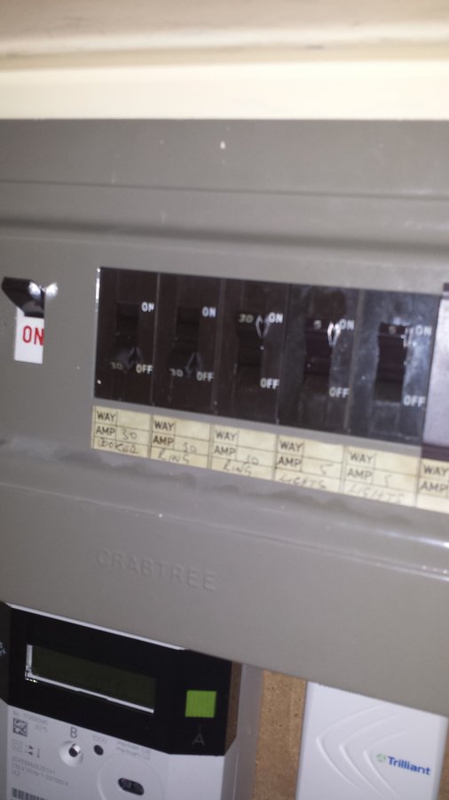

The actual circuit breaker for the circuit sparked? as in you could see sparks? Or it just made a loud noise? Is it the MCB (just for the sockets) or RCD (more than one circuit goes off).

Hi thank you for the reply. I checked the cables thoroughly and they are not damaged. The one in the consumer unit would be the MCB (Just for the sockets) and I did see the sparks once I tried to turn the mains back on.

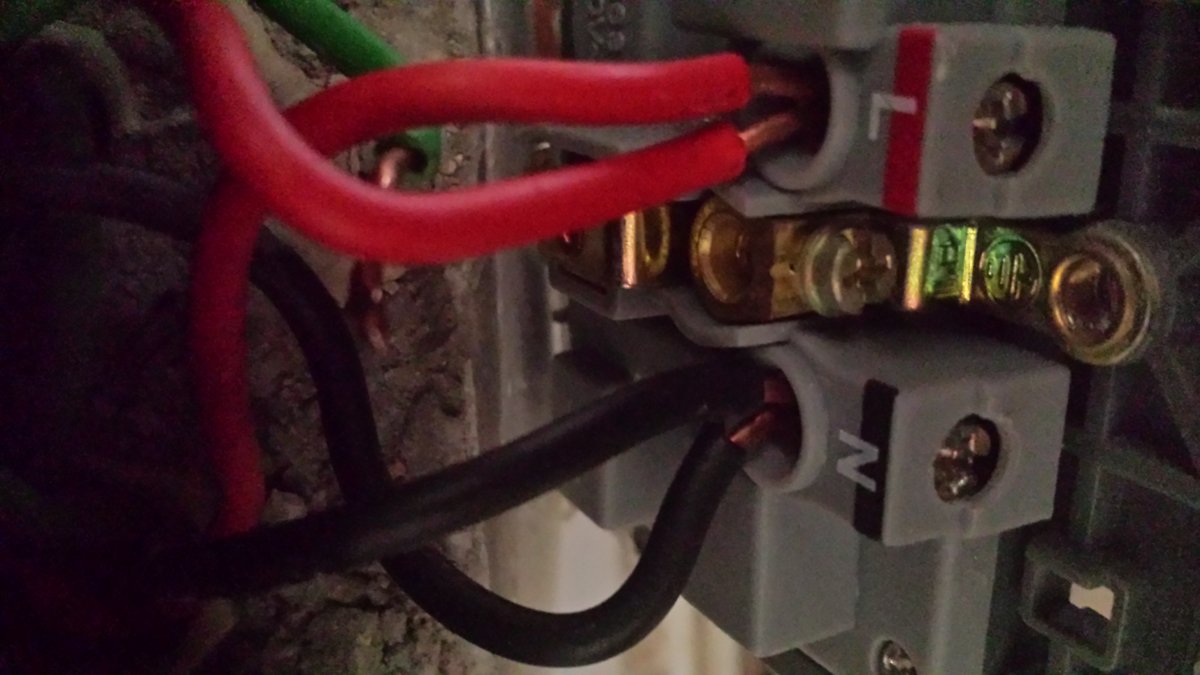

Would it be possible for you to provide a photo of your connections to the back of the socket?

Hi John thanks for your kind reply. I have uploaded some pics. The Green earth wire which is showing loose was screwed in while the spark happened. I have included the pic of consumer unit too. Thanks again for your help.

A shot showing the positions of both CPCs (earths) would be helpful. Can only really see one that is not currently connected - where is the other one and is either of them connected to the back box earth teminal?
Hi, you're wiring needs tidying up you have too much exposed copper on the L.
I would switch off the main switch and check that you are engaging the mcb correctly, some older boards require the breaker to be pushed fully Down then back up until it 'clicks' then switch the main switch back on. If you're wiring has caused a short i would expect to see evidence of that in the socket?

I cannot believe that its a fault with the CU that magically happened when you did some work elsewhere in the house!
I would hope that its not a fault with the MCB, I don't even think that the Science Museum has any of those.
