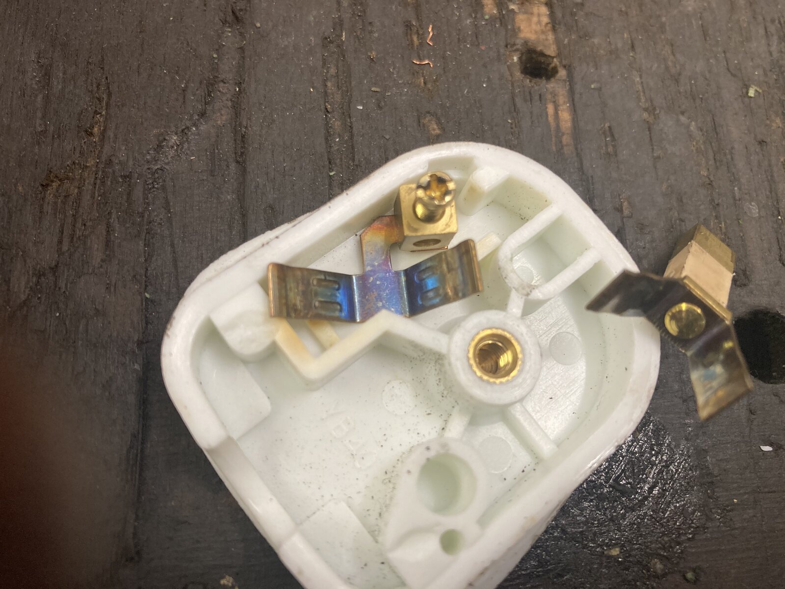

So select the biggest black plug you can find, which means greatest surface area to cool it and best colour to radiate heat.
Often those plugs suffer over-heating where the fuse clips are riveted to the plug's brass pin, but that one appears to have suffered heat damage from the fuse itself.
It does seem the 13 amp plug has been down graded, the necking of the live pins to put plastic sleeves on them has reduced the ability to transfer heat away from the fuse, black plugs are better than white, and clearly need to be in free air, the whole design of the ring final and 13 amp plug during the war was with the idea of powering heaters, so they should be OK, and with a thermostatic controlled oil filled radiator I have not had a problem, but 3 kW does seem today to be two much as a continuous rating. So as to if 20A switch or 13A fused spur depends what feeds it, from a ring final would need to be fused spur and with the down grading of cable from 7/0.029 (2.9 mm²) to 2.5 mm² one needs to be careful drawing over 2 kW from a ring final, OK near the centre but near the consumer unit can cause one leg to be over loaded.
