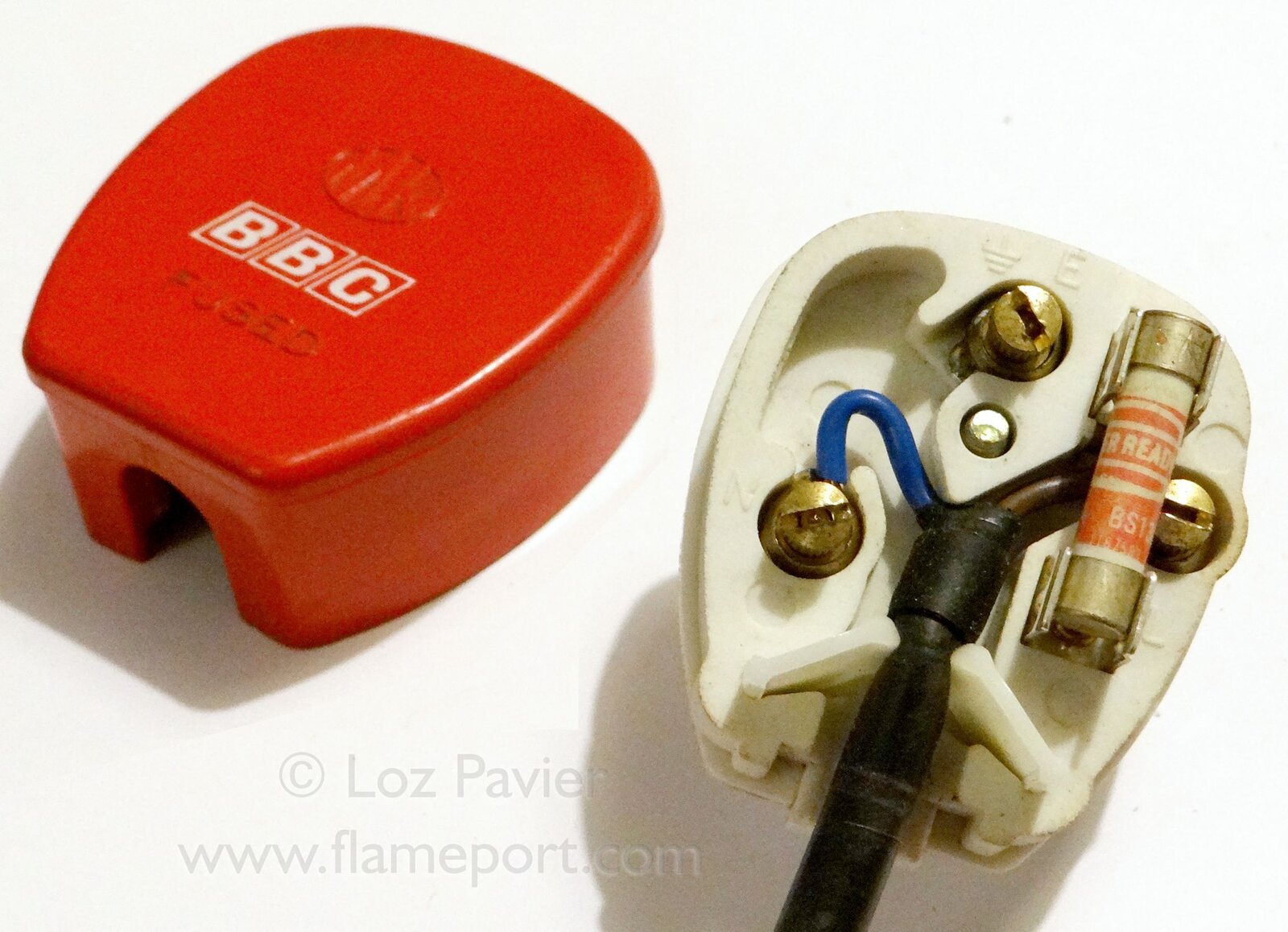

I seem to recall Red mk plugs with For Gpo Use stamped on them, or am i dreaming

Sure they were post office, never worked in BBC premises in my life, good plugs though and seems big companies thought so too
