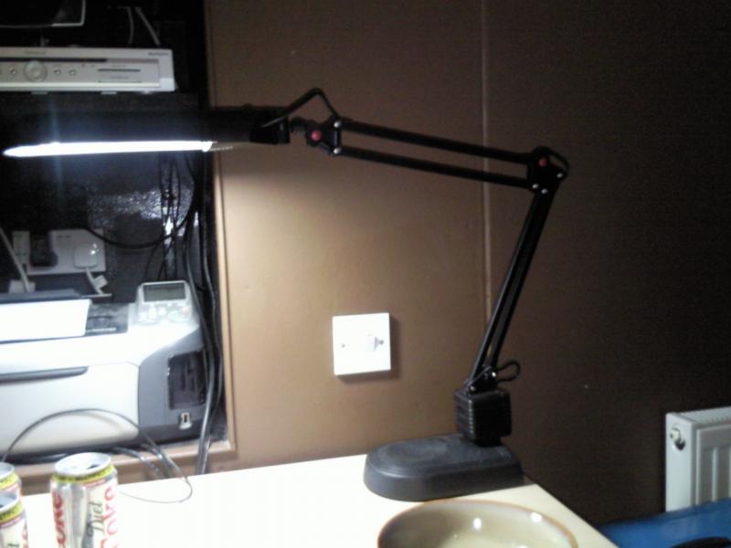

What went pop? Sorry if it sounds daft. The fitting is the whole thing - the light, with shade, arm etc.
This is my lamp, it takes a similar type of bulb to yours. Can you see its base? Just above the base is a black vented box, this is what strikes the bulb up. It is down there because it is heavy and the lamp would topple over if it were next to the bulb (electrically ideal). Does your fitting resemble this in any way? The equipment in there (commonly known as a "ballast") can go faulty.
By the way, mine was less than £20 and if it started blowing bulbs I'd buy a new one. :wink:

It seemed to be the bulb that went pop but the bulb is right next to the base box. It has a shade right around it so its safe for kids.
The lamp only cost me a fiver!
The wattage of all bulbs that have been used is 10w, not sure what you mean by rating, could be 220-240v?
Buy a new one. :wink: There must be something wrong with the base and at £6 a bulb and £5 a fitting, I know which I'd replace. :lol:
