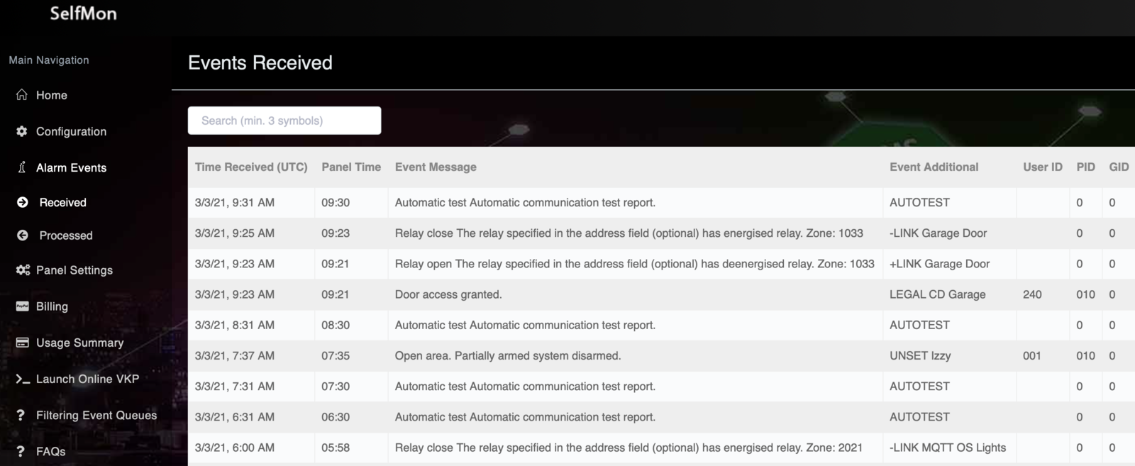

Here's what things look like when you have an active account:

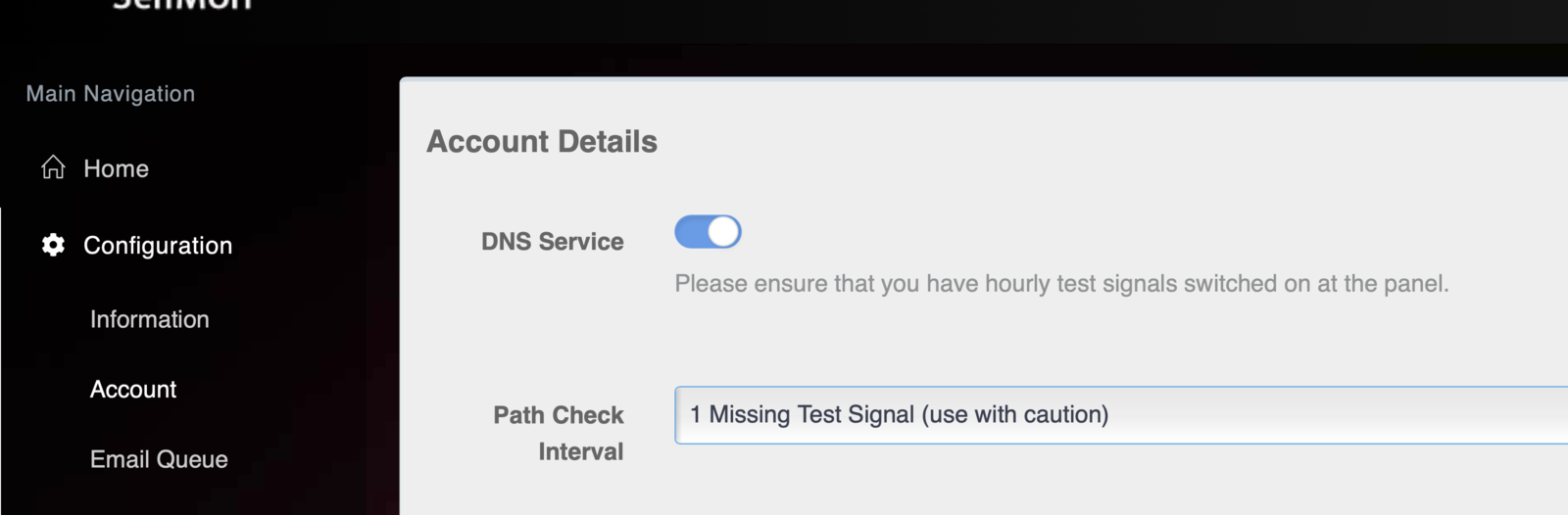

To enable the DDNS in your account, select the Configuration -> Account from the menu, then edit the DNS service setting. Note that you need to enable auto tests on the panel for this to work. See panel settings menu.
The path check interval can also be configured here. Note the caution on sending alerts on a single missing test signal - the default would be to send a path alert on a second missing test.

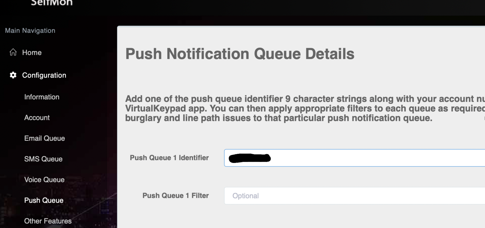

The push queue identifiers are a 9 character string (blanked out below). You use the identifier and the selfmon account number in the app. Once you do this, the app will register your phone to the queue. You can then optionally set up a filter to limit the events reported to that device. Eg. ==burglary,==panic,==fire,==line path
