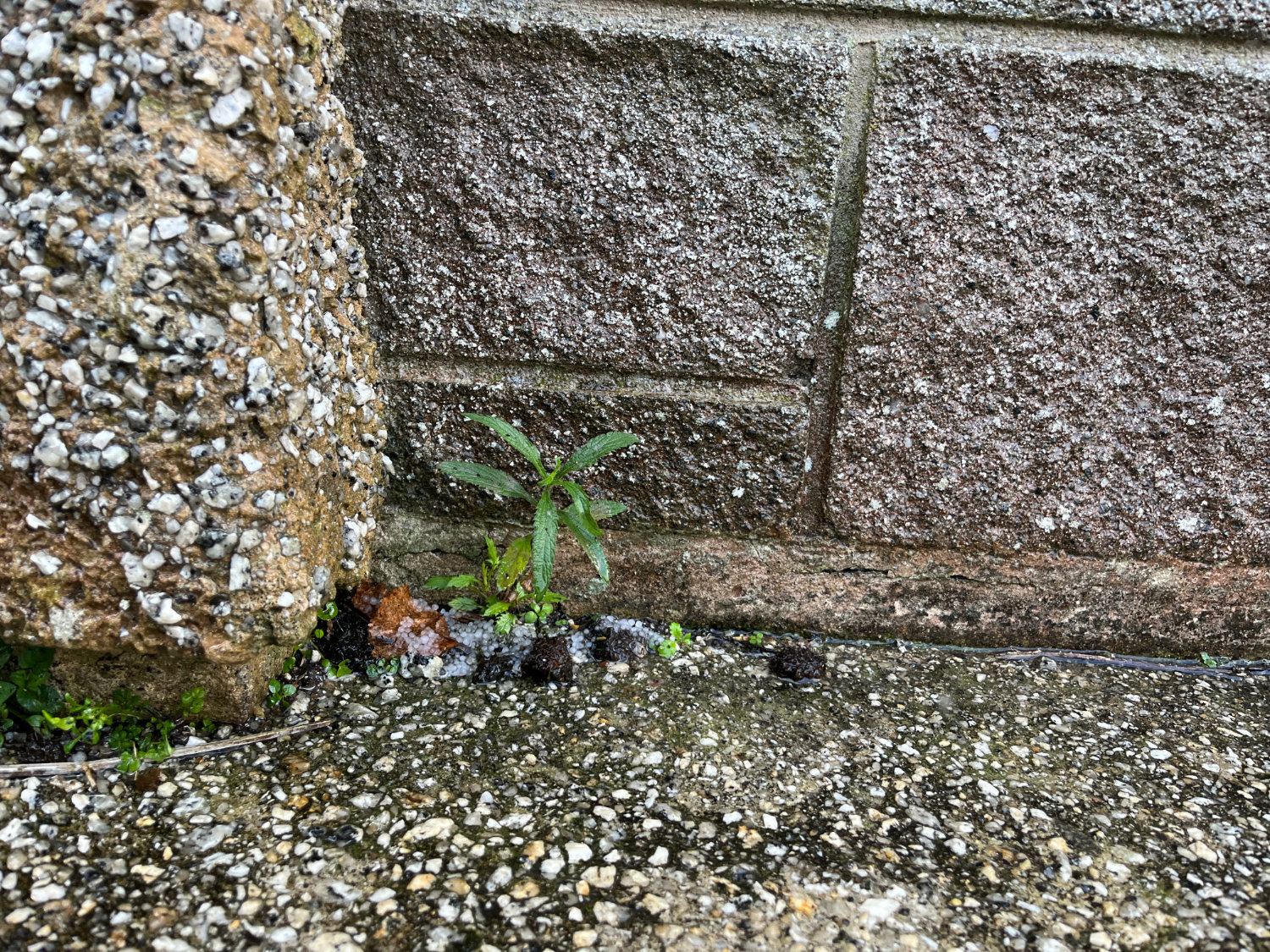

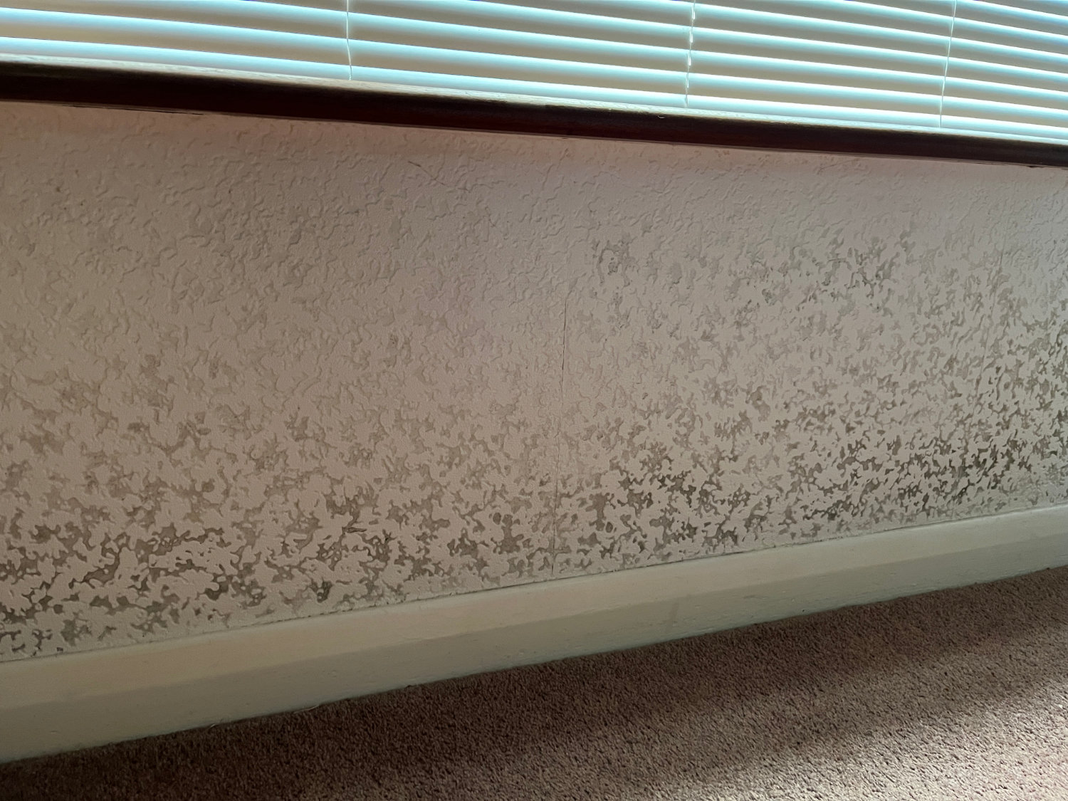

Thank you for the help, I really appreciate it. So I have dodged the rain showers and got some pictures (not sure how useful they will be. But the area is directly below a large lounge window and I am pretty certain it is not double skin as it's not thick enough. There also doesn't appear to be a gap, but I thought there was in the summer. So the first picture is the damp marks inside (it's not mold, but damp wallpaper (as it's a room that has not be decorated yet).

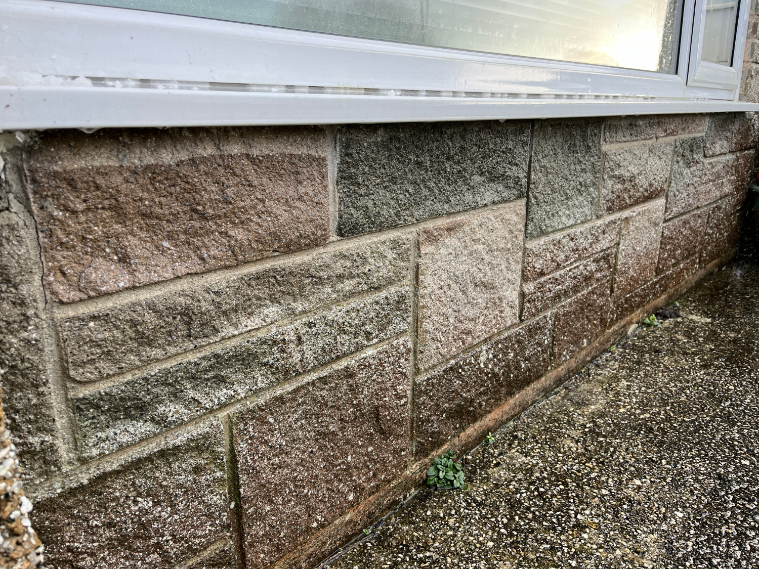

The next picture is outside outside and shows the bottom of the wall below the window.
The last shows how the rest of the pebbledash render appears around the rest of the (very dry) house (it has a pronounced lip), which under the window doesn't have.
Looking at it now it doesn't look like a gap at all, but I am sure there was when it was jetwashed.
60’s homes were commonly brick what makes you think it is blockwork.
The external cladding and render are likely causes of damp since they appear to have breached the dpc?
Splashback from the high paving. Jet wash the wall, then coat it with a silane water repellent.
