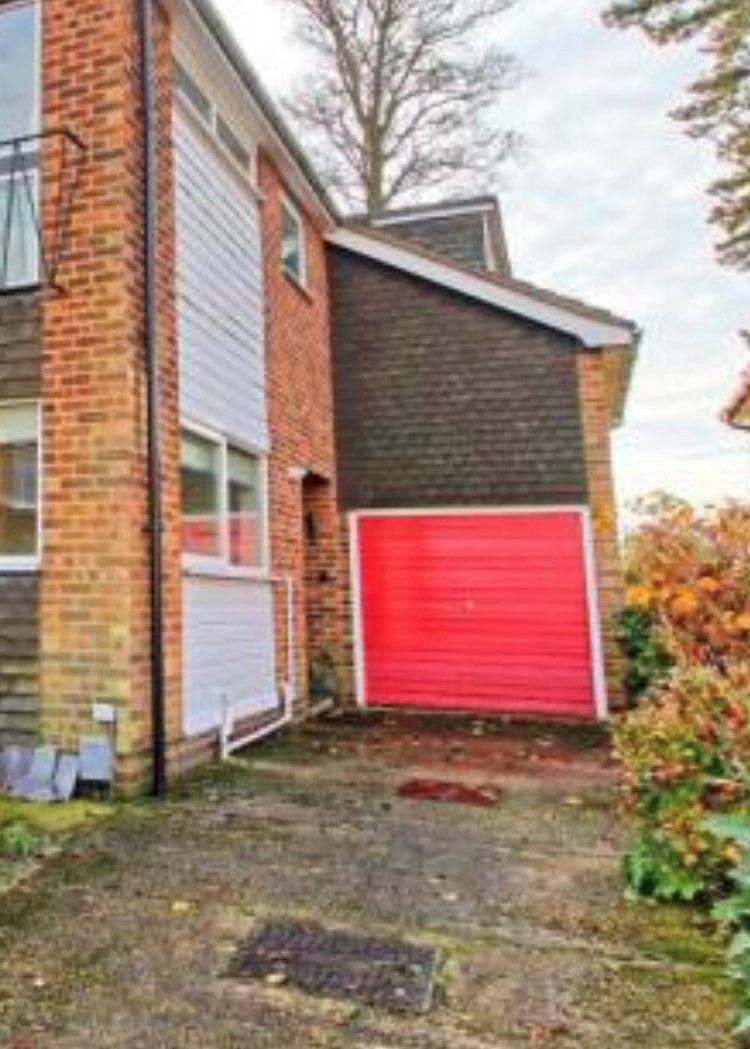

Hi all.
I'm in the middle of a wider refurb and starting to think about the garage conversion.
Above the garage door (amongst other areas) is a section of hung tile. my plan is to remove and replace all hung tiles with insulation/render.
Is it a really good/stupid idea to bring brickwork in the opening up to dpc only and stud above (then insulate/render over as above)? rather than brick/block up to underside of window?
Not a stupid idea, but if you where thinking of rendering the whole lot then it will have different expansion rates which might be problematic.
