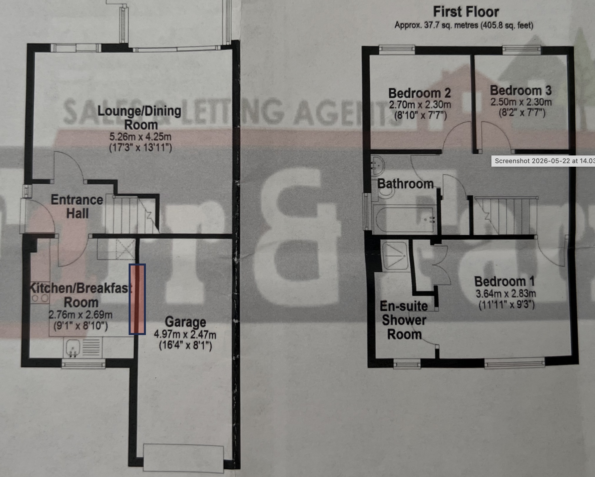

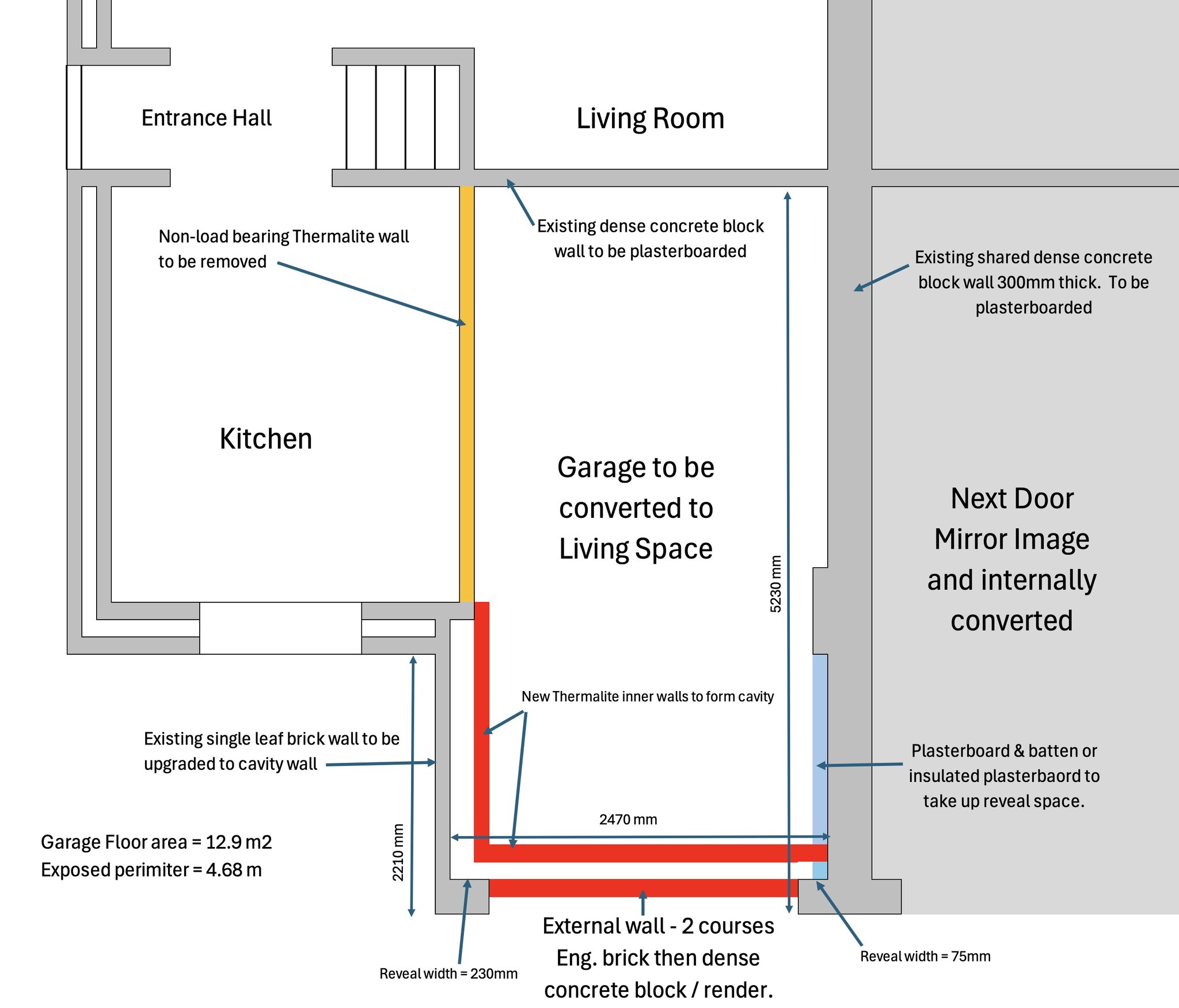

As per other thread the kitchen / garage wall is non-load bearing so my son is going ahead converting garage to a dining room and I would like to do as much as possible to help budget-wise. Have done 2 of my own in the past but not done the front wall before and was a few years ago.
Pics again below - is semi-detached so only a small section is external wall. Will be Building Notice and I usually get good cooperation from BC but want to do my homework first, and if I have to get a builder in to do certain parts then so be it but below will help me decide.
1) The garage slab is in good nick so the thought is DPM and PIR + floating floorboard but the floor height difference with the kitchen means there will only be 50mm for PIR taking in to account floor boards etc. Any issues there?
2) I'm assuming the front wall will need proper footings dug out, if so will we need 150mm cavity or as rest of house is 100mm can we stick with that?. Son also wants rendered wall rather than brick and full width window - which hopefully reduces toothing bricks and me thinking Im ok to do it with blockwork and a mate render, otherwise builder will have to do brick work.

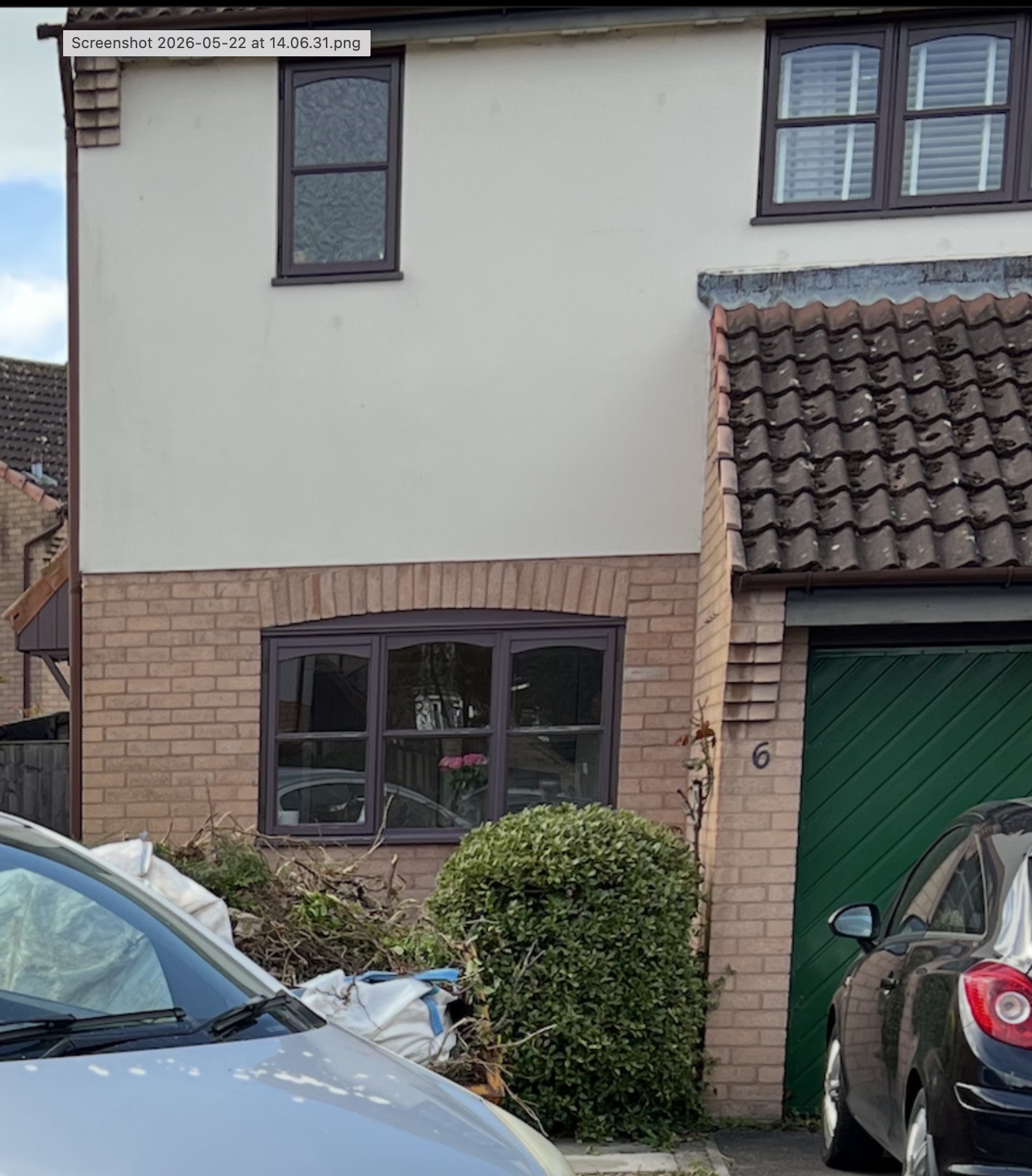

That's a modern house, so check if PD rights have been removed and conversion is allowed for loss of parking.

Half the other houses have converted and our understanding is PD were not removed. He has parking space for 3 - 4 cars anyway (corner plot) in addition to the garage so any objections there are very unlikely.

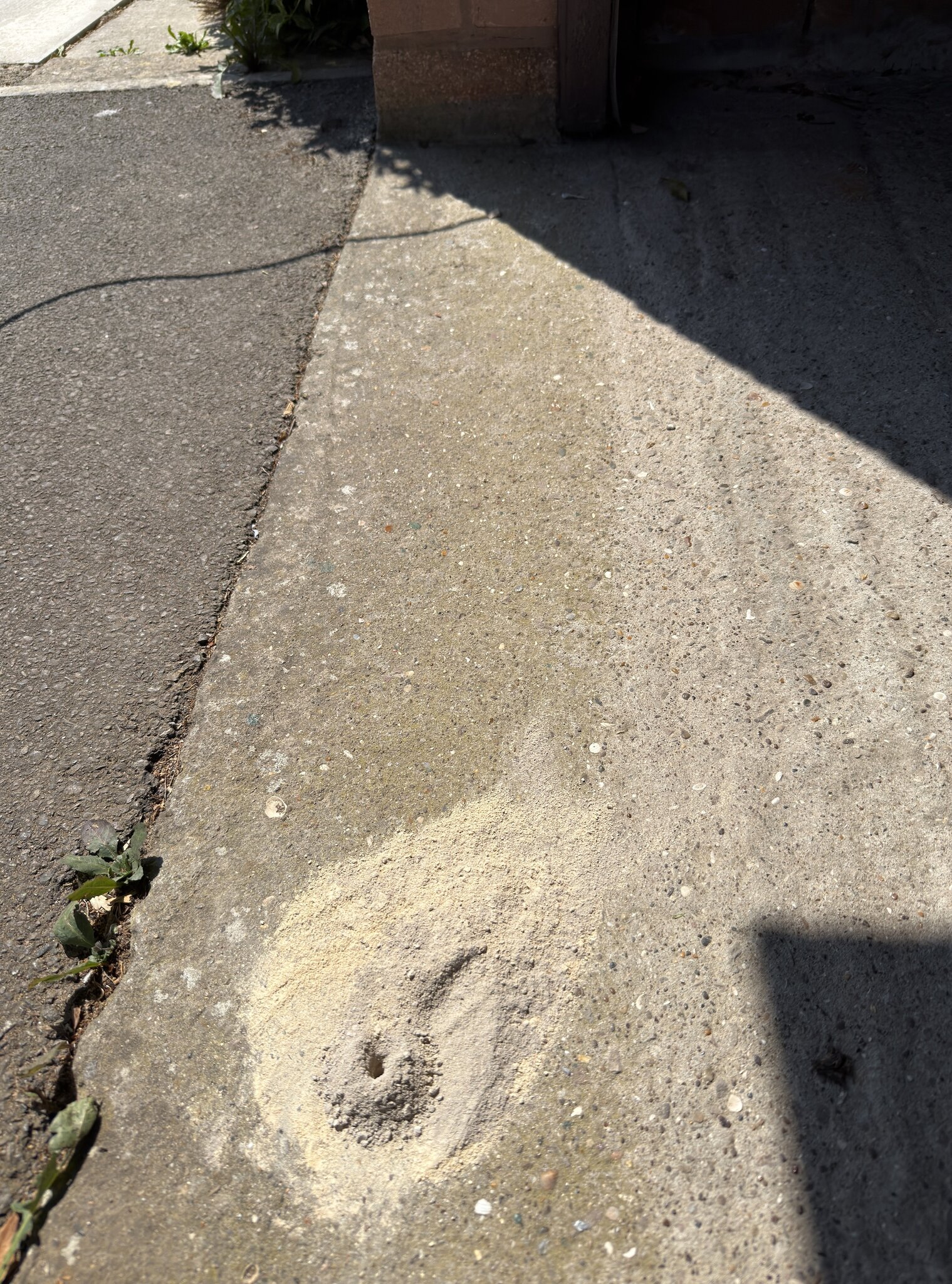

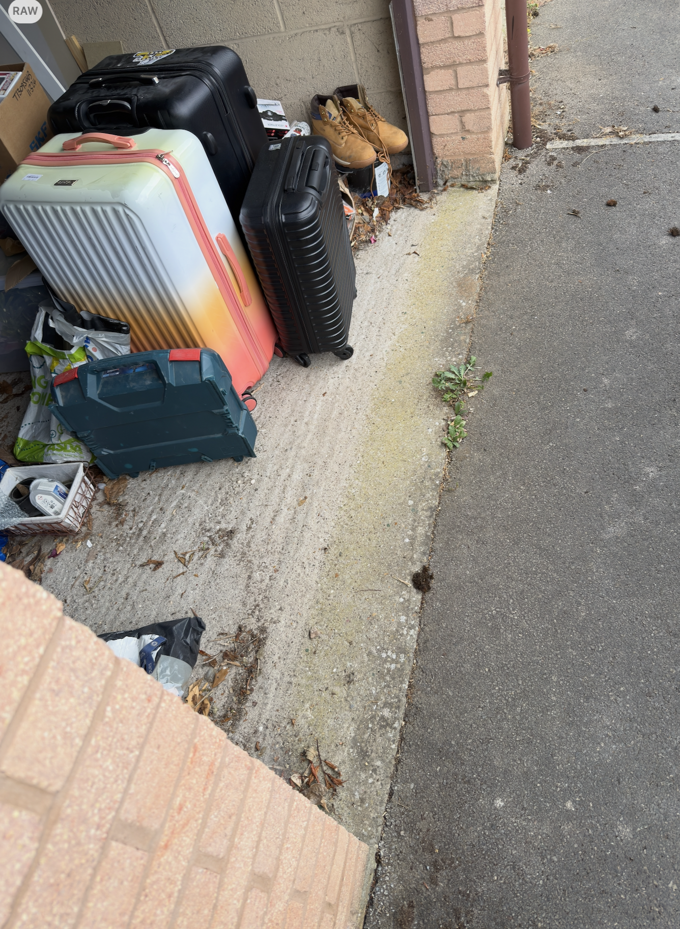

Just back from a proper measure and hopefully good news - Drilled in spot shown and it took all of my 400mm long drill bit and still didn't break through. Checked with a hooked wire and was nice smooth bore all the way down.
If this is therefore suitable to build directly on do I need to prove it further with BC and if so how? On my last conversion under Building notice there were no foundations as I kept the garage door and put in a thermal wall - there were no other structurals so BC didn't even turn up until work had been completed and still signed it off.
This is a different area authority though - I don't mind asking them the questions but just trying to get ahead of the game before I get on a roll.

You won't know what they'll want until you ask, they might tell you over the phone but then no guarantee you'll get the same inspector when you put the Notice it. In modern houses they typically carry on the strip under the garage door anyway as it makes building the footings easier.
More positive news.....Emailed LABC and they are happy for us to proceed building the mini wall with window direct on the slab as is (no foundations needed) and the floating floor will be ok with just 50mm PIR which was the max thickness we could fit in.
That gives us confidence to stick the building notice in and crack on.

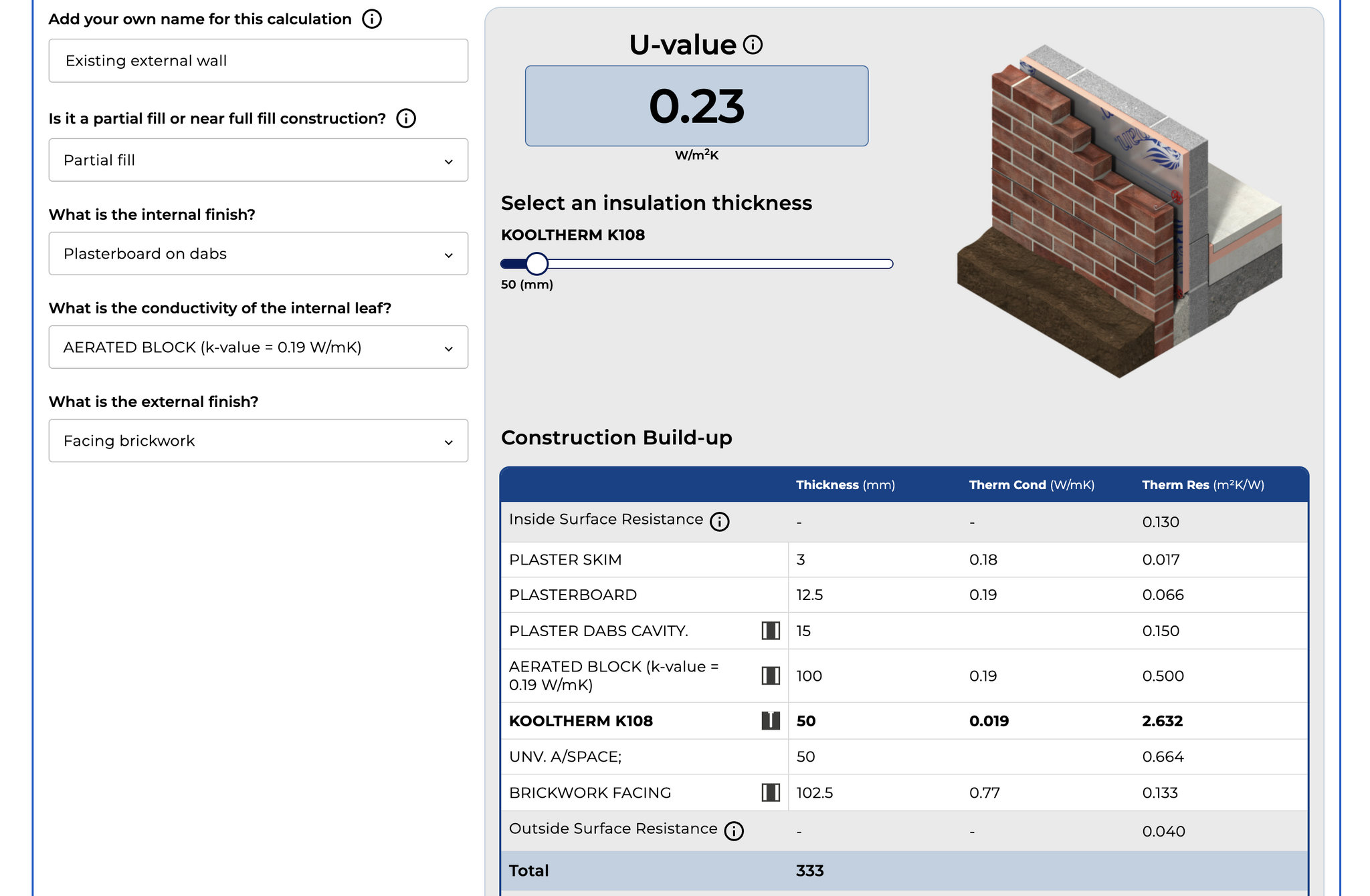

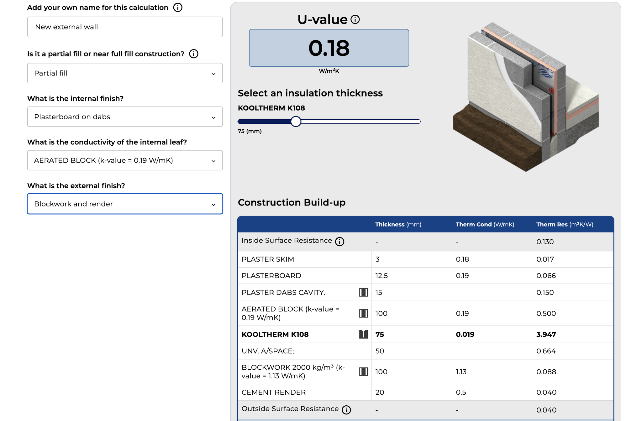

Now need to detail the new front wall and beefing up the existing external wall - hopefully I have done my calcs right as below - my understanding is the existing external wall needs to be 0.28 max and the new wall 0.18 max. The new wall is no prob as we can build however needed with no depth restrictions but with the 230mm reveal on the left hand side wall it looks like I can do it with a 100mm cavity, 50mm PIR and thermalite which will just keep things within the 230mm reveal? - but thanks just to see if I am missing anything.
