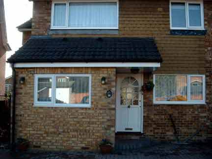

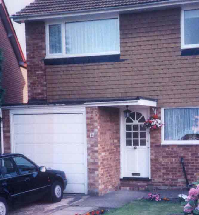

Here are some photos.
Before
After
I paid for the front to be bricked up (my brick laying skills are not up to this sort of thing) and the window put in (10 year guarantee if they supply and fit).
But I built the roof, all by myself. :D
Craigf, this is what has taken me 4 months!
The conversion looks finished from the outside because I have put up a net curtain. Shame about inside, however I did manage a few hours at the weekend and I am almost ready to sort the floor.
Pal
