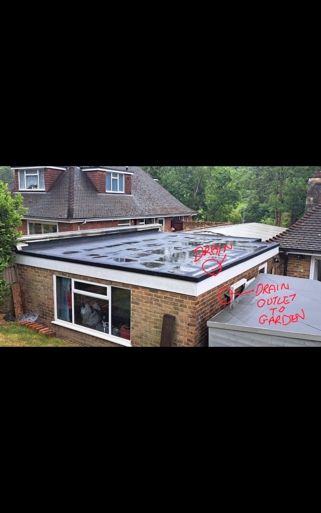

Hi all. I have used this amazing forum for years but never posted.
I want to convert my flat roof garage to pitched. Current height is 2.5 Mtrs. It's on the boundary. I know this is max height permitted development for detached building... but the garage is attached to the house at the front corner.. about a mtr. The property was built this way. Does that mean that I can build the roof higher. It's effectively increasing the height of a lower part of the house.. which seems to alter the criteria?
Just trying to get people's views, before planning.

Probably better to assume it's detached, then there's probably no building regs (if under 30sqm internal) as there may be if you extend the house. Just need planning.
