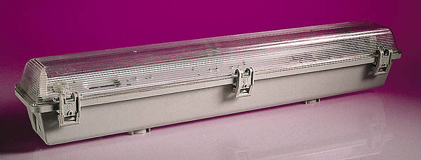

I presume by vapour proof fitting you mean this:
also known as a non - corrosive fitting.
I have these fitted in my (domestic) garage and shed, and find them fantastically helpful at preventing a glass shower when the fittings get whacked with a large lump of wood.
A full conduit install would look neater, but I would have thought t+e at high level and conduit or trunking for the drops is fine for a domestic garage. Its up to you really, and which you prefer, and of course which price your customer prefers.

Yes that is the type of fitting that I was on about, as it is obviously an unheated space and could get damp. Also good for protection against wood and ladders as you've said.
