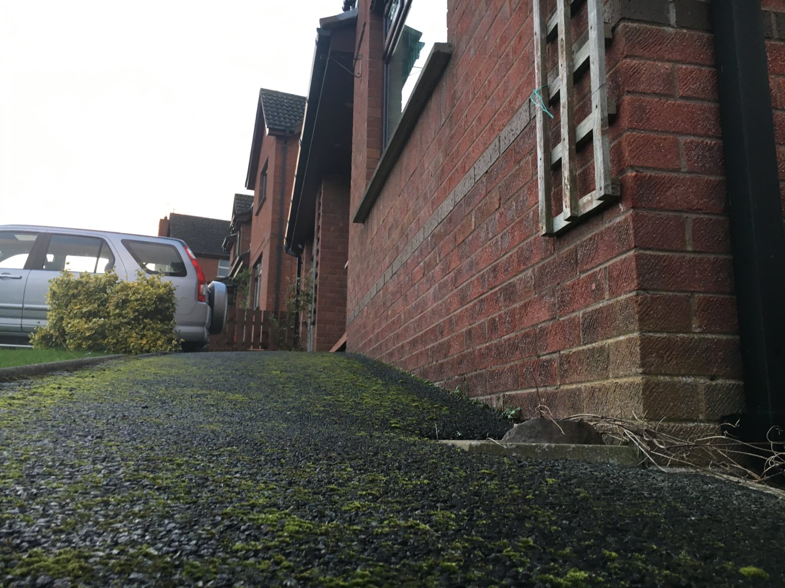

I have a space beside my house which I refer to as the 'blind side'. Useless space, can't grow anything except weeds with it's aspect but it would be wide enough to use as hard standing to extend the drive from the front. First I need a retaining wall and drainage to adjust the level bringing it up towards the other level across the front of the house.

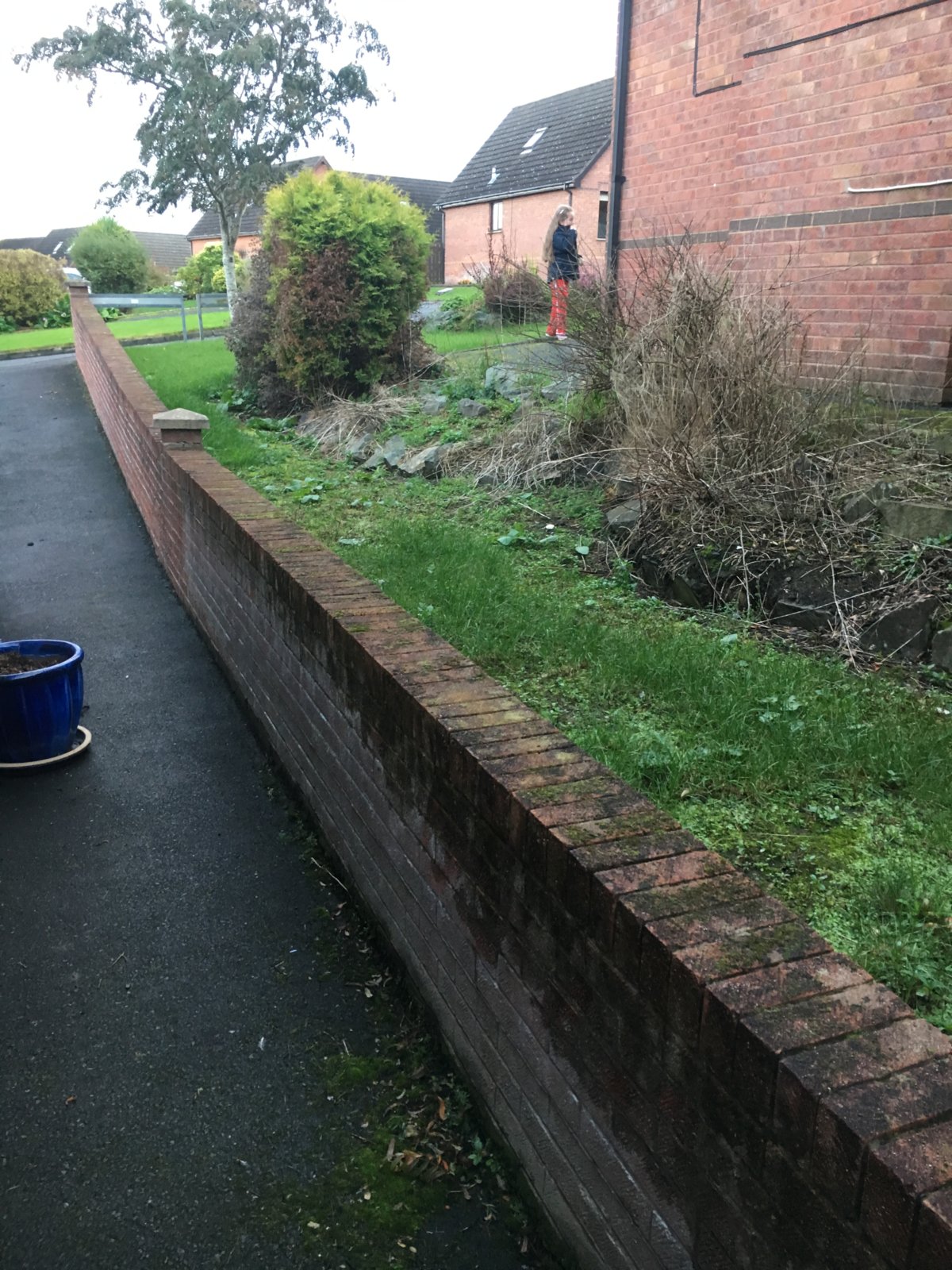

Currently there is a double brick wall 0.8m high between us (not really retaining but it has lasted these years although not in great nick) as can be seen below.
Blind Side of House
It's 16m long to the rear of my house. The house front to back is 8.5m and the wall is 3.8m from the house.
I would like to keep the small tree in the foreground with a kerb/bed around it and create an area of hard standing across the front (asphalt probably) running all the way up the side of the house for car parking/trailer etc.

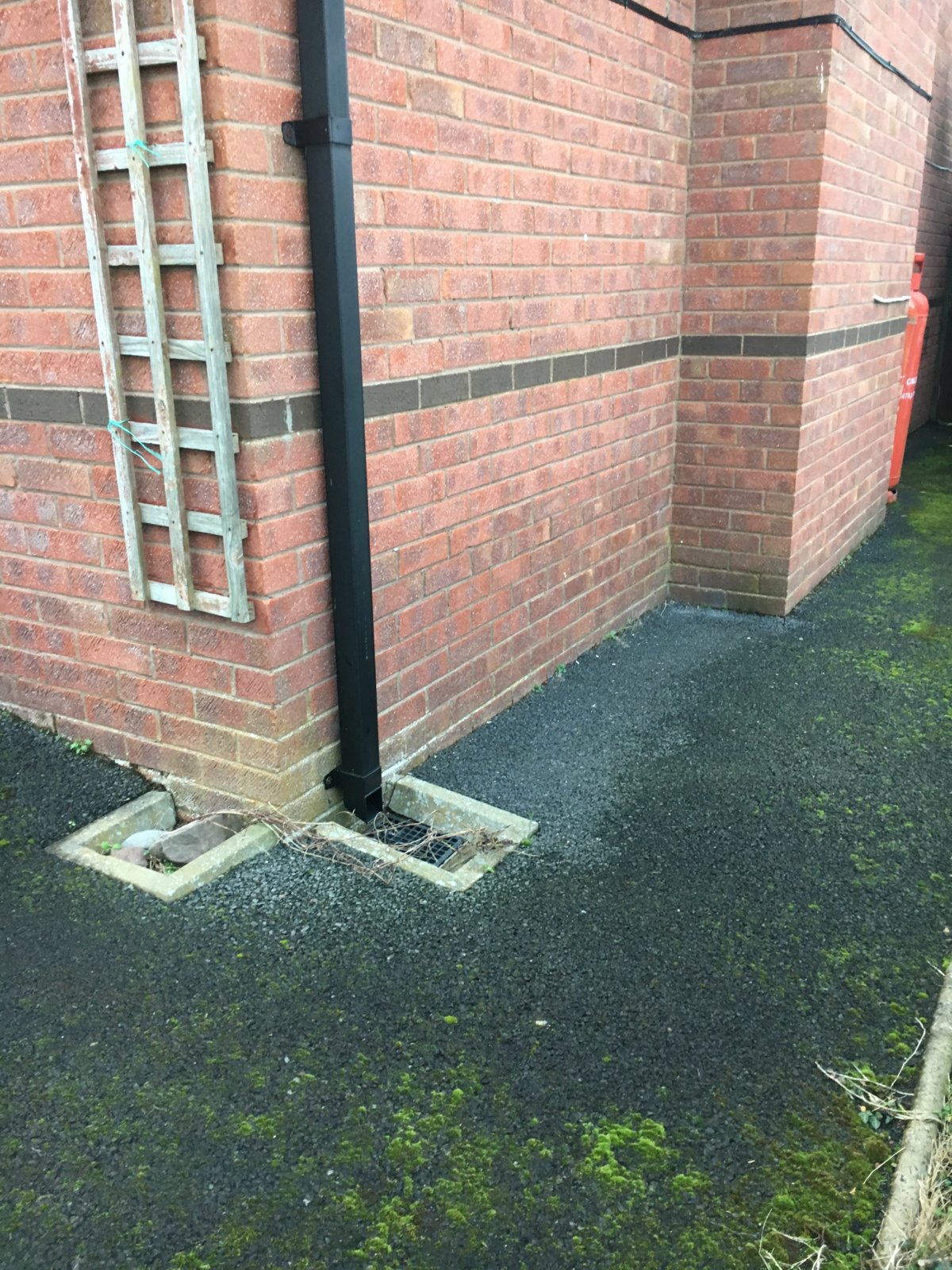

I can only see 1 rainwater gully at the side of the house, how will a sort out drainage?

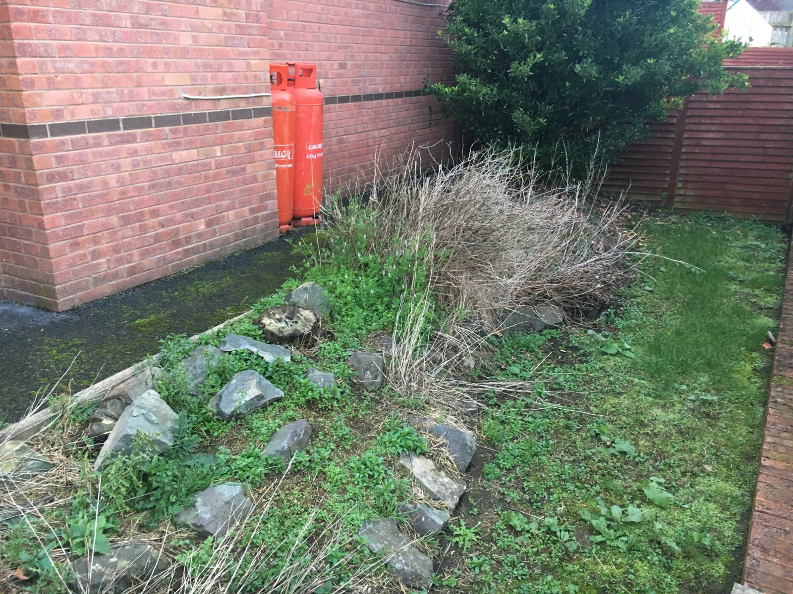

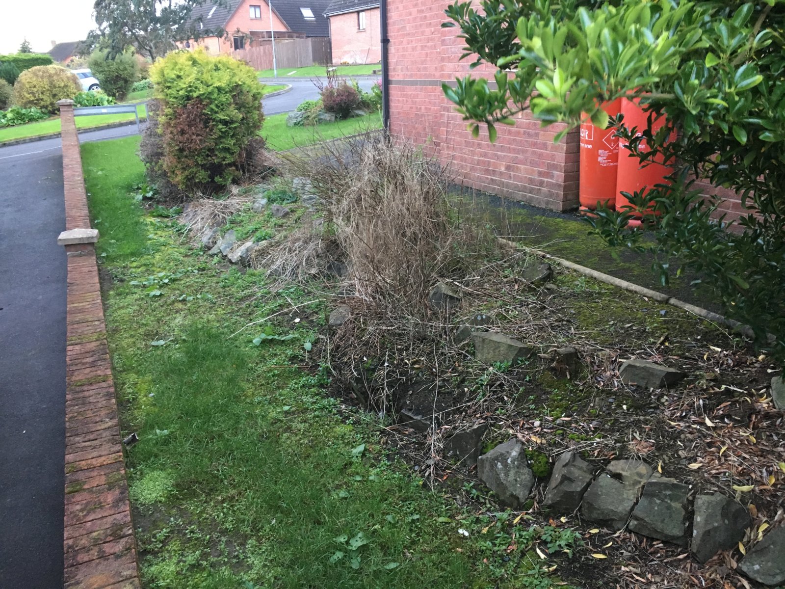

Have more photos taken from different angles including in the neighbours side looking back at the wall.

Building control have no obligations to you, so you cannot rely on them to ensure the works are done properly. There are a wide variety of wall solutions and it will to some extent depend on what you want the finished product to look like as much as the function i.e. hardstanding areas rather than soft landscaping. Having only one gully is probably not really a problem as additional drainage can usually be added if and when necessary. The levels ot the existing drains could be an issue and some excavation may be a good idea to establish the inverts of what is there now.

With regards to drainage I have manhole covers at the front of my property at the top end of the drive so I'm assuming there must be a pipe in there somewhere for gravity to do it's work.
Do building control have to be consulted about this type of work in a garden? I assume they do due to the nature of the wall.
Any change to the drainage is usually a building control issue anyway. Although you have manholes they may not be to the drainage you need. Generally there are two types of drainage in use, foul and storm. Surface water drains go into the storm system.

I think you have the gist of it. The safety of your neighbour is the most important aspect of what you propose as a collapse of the wall for whatever reason and injury to person or even damage to their car are what you are safeguarding against. Personally I would be inclined to build a 215 dense concrete block retaining wall your side with a cavity then a tied in brick skin in front (on the line of that existing face) for appearance and reduced to brick on your side where it becomes exposed. The foundation needs to be wide enough for all that and possibly a toe to the foundation. Having seen such walls built on sites I have worked, the back can be thickened by further blockwork the taller the wall needs to be and then stepped back as it rises. The cavity with weep holes at the bottom ensures the facing bricks are not subject to ground water and so remain dry and looking good.
That wall looks ok to deal with that small bit of ground.
Don't overthink things. The land bring retained is a 45° slice from 1/3 up the wall and a one brick thick wall is fine for that purpose.

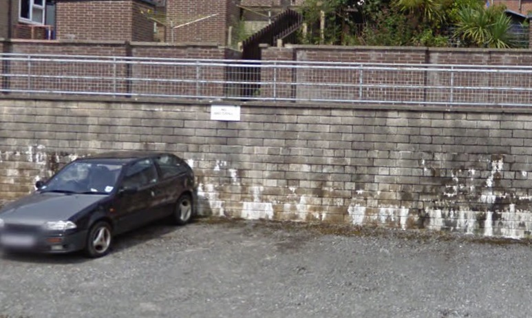

As an example of a pure block retaining wall without a skin of facings I managed to locate one of the first sites I worked on about 40 years ago! The top of the wall is thereabouts at road level topped by handrails. You can see the top 5 courses are a single thickness of 215mm thick blocks (I know because I was there!) then the next courses down from there are blocks laid as headers and futher down the wall gets even thicker. As the steps are in the back of the wall you just see the single vertical face. That was the engineers design there. If also shows the mess of water coming through over that period of time. The ground there was a hillside of shale just on the outskirts of plymouth. Horrible stuff to excavate though as one side of a trench would be vertical and the other side at 45 degees where the layers of shale slide into the trench.
OK bigger than what the OP needs but the principle is good as that one is still there.

First thing to do is to dig down beside the wall, often these walls look like they are just 9'' brickwork from the top but are actually backed up by blockwork and so at their base they can be 13 or even 18'' for a course or two and step in towards the top.

I know this one isn't as the level it is at now was from soil removed from when a concrete base was put in around the rear of the house for a shed 3 or 4 years ago.
