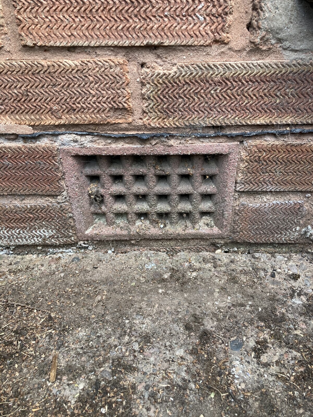

I want to lay a patio over an existing concrete bed in my garden which will but up to my house however I am slightly concerned about where the slabs will finish in relation to the air bricks.
The concrete currently finishes 185mm below the dpc and 20mm before the start of the air brick (40mm before the first vent) and 170mm to the top of the air brick.
The slabs I am looking at are 16mm porcelain slabs and I plan to lay them on a 40mm bed. This will mean they finish at the start of the air brick but 20mm before the first vent.
Do you think this will be fine or should I remove the sections of concrete below the air bricks and fill with gravel? Or build a barrier with a grate? I’m just a bit concerned re. Flooding or rain splashing particularly after reading the NHBC 75mm recommendations.
Ideally I wouldn’t remove the concrete bed to lower the level as it’s 100mm thick and 5x3m.
