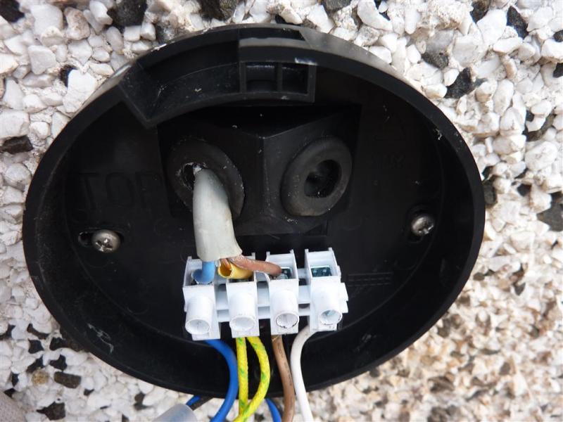

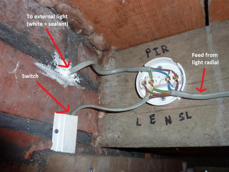

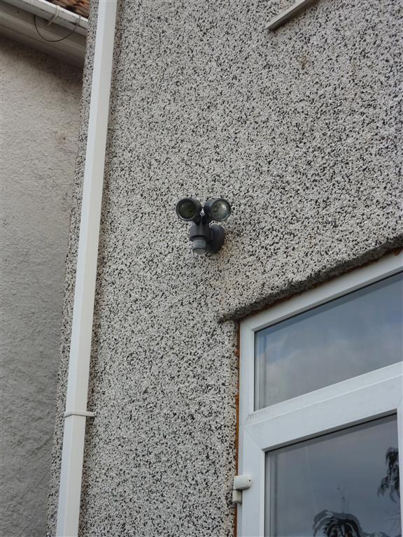

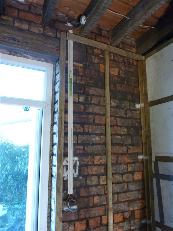

All,
Had a busy today and managed to fit the external light, supply and switch cabling and wire the junction box.
None of it's connected to the light ring yet and won't until I get a spark in to connect and certify it all along with the remaining lights that still await installation into the room but I just wanted to thank everyone for their help in this thread.
I used 1.5mm cable throughout, the junction box is a 20amp max unit. The switch will be mounted at 1200mm from the floor which I believe is the requirement by building regs.
Do let me know if you spot anything glaring, besides the state of the room :D
Here's a few pics.
Inaccessible JB.
No protection for the cable through the wall - I use 20mm conduit.
Is sealant likely to damage cable?
The switch height does not apply to your property.
New build it will be between 450 and 1200mm from ffl.
Inaccessible JB.
It is accessible, once the ceiling is up, the floorboard directly above the JB is lift-able for servicing the radiator connections.
The wall of this house are non-cavity 11" solid brick, would protection for the cable through the wall really be necessary? However I have some conduit and so will use that instead for the rest of the install :)
No, its of the non-corrosion type specifically for electrics/electric cabling.
The switch height does not apply to your property. New build it will be between 450 and 1200mm from ffl.
Ahhhhh well, its a good height to stick with to be consistent throughout the rest of the property :D
