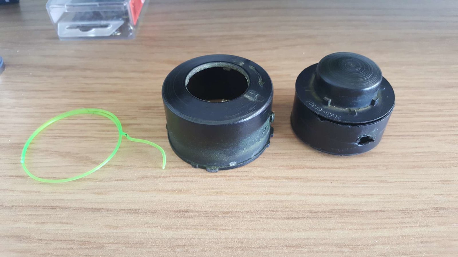

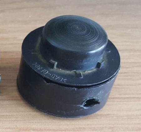

Here's a photo. So I can just buy wire to push through the holes as you say? It doesn't look like it dismantles anymore although I have tried hence why it looks a bit battered!

No I can't get the belt off and I can't see the make in order to buy the exact same one again. How will I know a pre loaded one will fit?
Got the belt off at last. Is there still hope? Seems bad to replace a whole strimmer just because of a small part!

For yours, you wind it all on and then poke it thorough the holes of the belt as you replace the belt (swearing as it suddenly unwinds).
Then you poke it through the two holes in the carrier as you insert into that.
Suggest you use shorter lengths of wire first time you try (say 2 x 1.5m).
