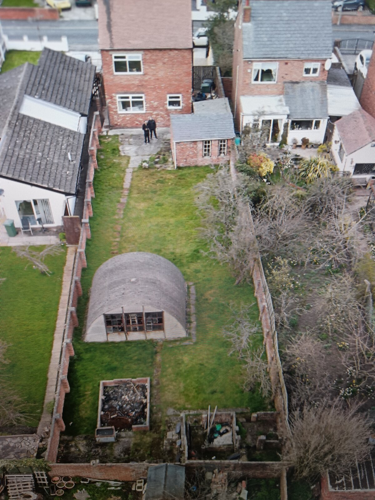

I will soon be demolishing the garage at the front the rear garden in the photo attached as we will be extending the house and the garage isn't great structurally anyway. I need somewhere to store a couple of motorbikes and my tools.
My plan is to knock down the old pig sty walls that are falling down and build a 4.8m x 3.6m workshop / motorbike garage at the back of the garden (bottom right of the photo). I cant decide what to build it out of. Almost all garden workshops I see when I search are either shed type construction or timber frame, but Im thinking single skin concrete block with timber battens screwed to the inside face (with a damp membrane behind them), then insulated plasterboard would be a lot cheaper?

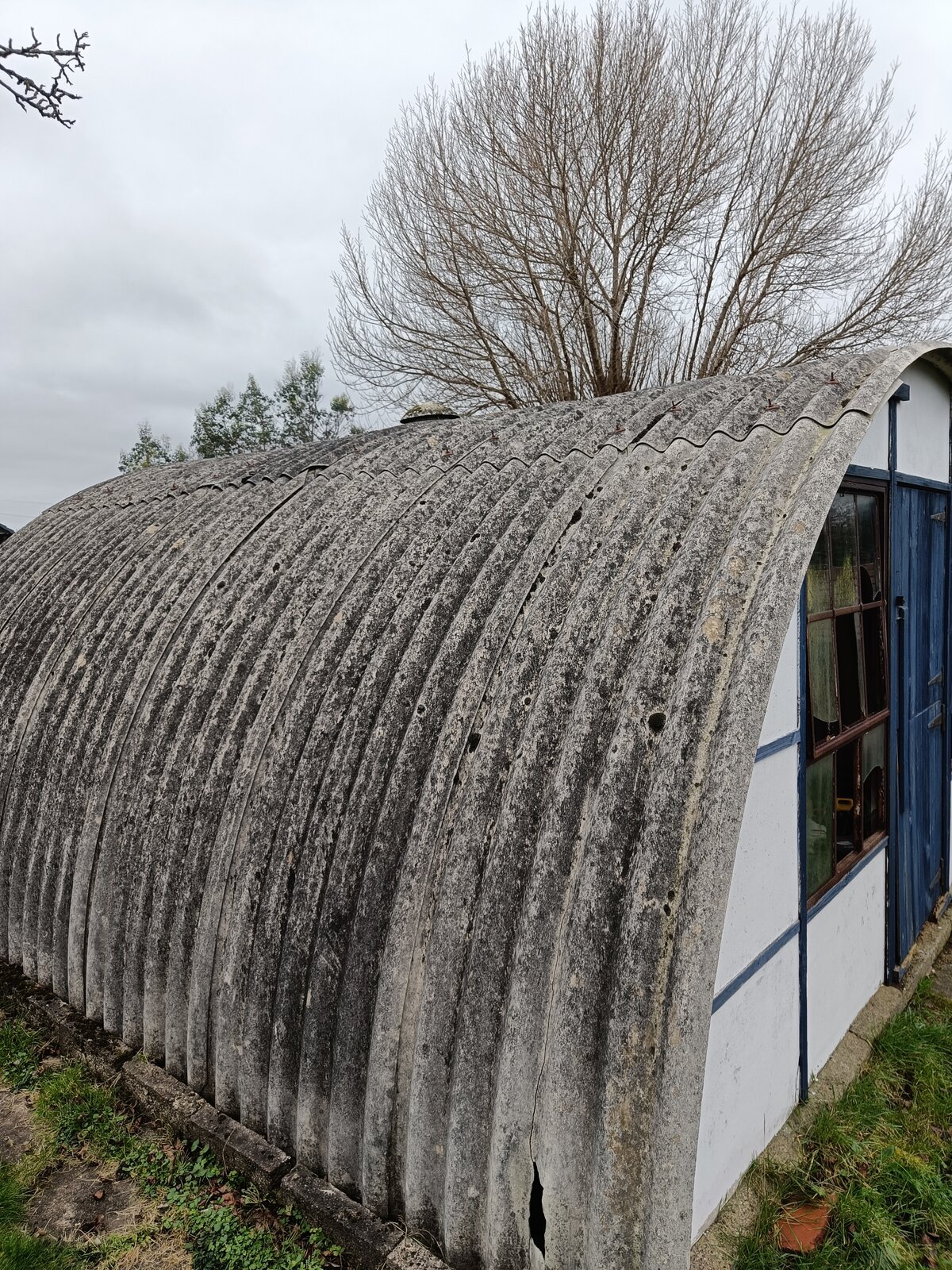

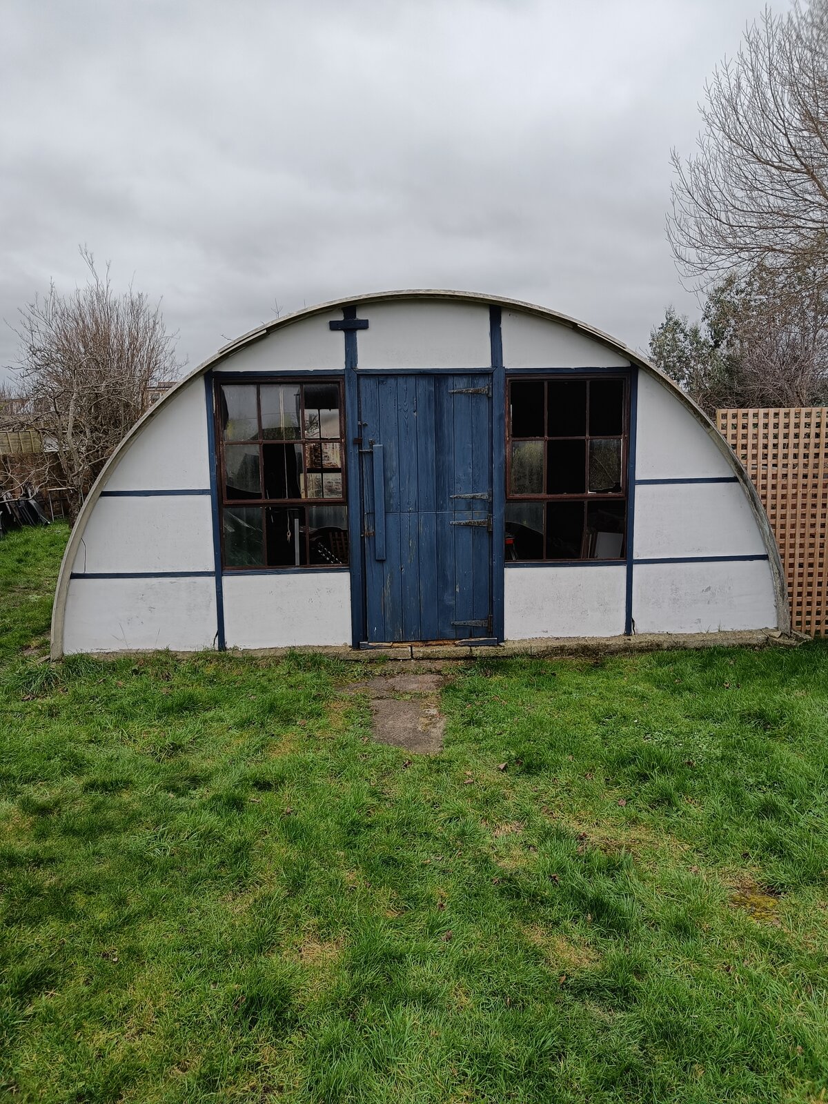

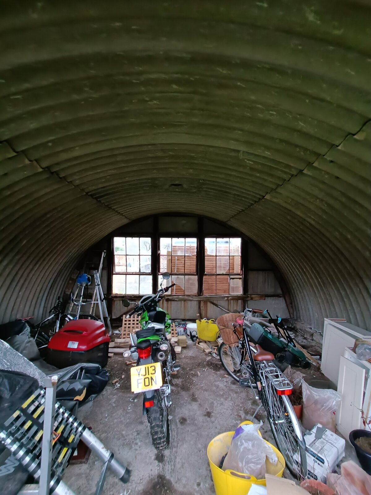

I believe it's from a RAF campsite from the war. The family that owned / built the house was in the army so I think they gave it to him. Maybe he lived in it whilst he built the house. It's got a boiler flue. Pretty sure it's asbestos cement

She's both ugly and beautiful! (y)
Can't believe there's so little to it, you would never think it would survive wind or snow, but clearly it has.
The bolts going between the sheets must be doing all the work

You'd never think it's 80 years old. There's a few cracks but it's very solid. If it was at the back at of the garden I'd keep it but because it's almost in the centre it will be replaced with a garden room most probably
