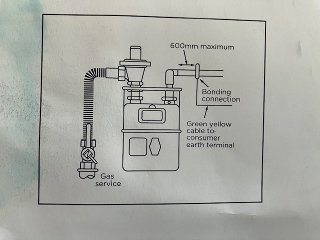

SGN engineers left a card in the box stating that 'the installation pipework fitted at your property may not have Bonding correctly fitted' with a sketch showing the 'traditional' bonding arrangement with the bond a maximum 600mm from the meter.
Can we have a picture of the sketch please? Just interested.
The 600mm only applies to internal meters and is actually not electrically correct.

It is irrelevant. If bonding is required it should be connected at the point of entry into the premises.
