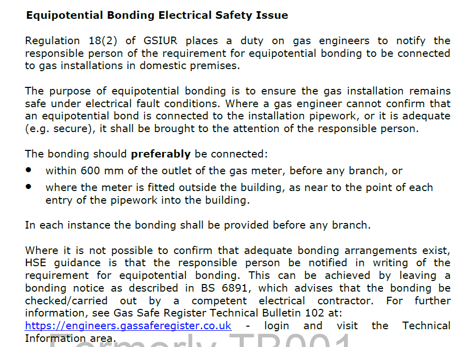

Gas bonding regulations
Note for information wiring regs not a legal document whereas GSIUR is.
Electricians argue come what may the above is a requirement gasmen have to comply with.

The purpose of equipotential bonding is to ensure the gas installation remains safe under electrical fault conditions
... makes little sense to me, since it seems to me that the opposite is the case. As I have said, the effect of bonding a gas pipe is that, under certain electrical fault conditions, extremely high currents could flow in the gas pipe, potentially leading to considerable local heating or even sparks in ther gas pipe, particularly in the vicinity of joints/unions. I would therefore have said that bonding a gas pipe does quite the opposite of "ensuring the gas installation remains safe under electrical fault conditions"!
As has been said, the gas pipework will almost always be connected to earth via the CPCs ('earth wires') feeding boilers, CH pumps and motorised valves etc., so the risk to which I refer already exists to some extent. However, adding bonding will, as far as I can see, make the situation appreciably less safe (gas-wise) by increasing the fault current.
If, as is commonly the case, the gas supply pipe does qualify as an extraneous-c-p then, electrically speaking, bonding is essential (to reduce the risk of electric shock), even if the result is to make the gas installation less safe.
I suppose it depends whether they mean safe electrically or gasly:).
Is there any danger gasly in an electrical fault situation? The gas won't burn/explode inside the pipe without a lot of oxygen.
You do have bare electrical contacts submerged in the petrol in the car.
I have to say that I read it (and still do) to mean "gasly". The only sense I can think of in which the gas installation could become 'electrically unsafe' by virtue of the absence of bonding is by leaving an unbonded extraneous-c-p in the property - but that is surely of no concern to a 'gas safety inspection', is it? Would you expect someone doing an inspection of a 'water installation' to comment about the absence of electrical bonding?
I suppose I should have been a bit more cautious, and written something like "if the presence/absence of bonding has any effect on the safety of a gas installation ('gasly'), I would have thought that it's presence would tend to slightly decrease safety of the gas installation ('gasly') ". Whilst the risk is clearly very small, I don't think it is zero - for example, a slightly imperfect gas union can result in both small gas leaks and sparks (if fault currents are flowing) - and, perhaps more to the point, local heating of unions due to very high fault currents might actually result in such imperfections of unions arising.
My main point was that I could not think of any way in which bonding could "ensure the safety of the gas installation" (gasly) - with the only effects I could think of beiong a (very small) risk of it doing the opposite.

No. That's true but as you say the gas would presumably be 'safer' gasly without bonding so why instruct the inspector to verify it is there?
Well, that was essentially my question. I see three possible answers ... Firstly, maybe, as you suggested, the 'safe' is meant to mean 'electrically', rather than 'gasly' - but, as I've said, I don't see that as a concern of a gas inspector (or what he is instructed to inspect). Secondly, maybe we are missing something. Thirdly, as I've already suggested, maybe those who instruct the inspector don't know much (enough) about things electrical! I may be doing those concerned a great injustice, but I have to say that I have some inclination towards the third of those possibilities!

For it to be a check on a GAS safety check list, it must be their opinion it is required for GAS safety.
... For it to be a check on a GAS safety check list, it must be their opinion it is required for GAS safety.
It must. However, as EFLI has said, when they say that bonding is necessary "to ensure the gas installation remains safe under electrical fault conditions" they might conceivably be talking about 'safe' in an electrical (rather than gas) sense - but that would seem odd, and unlikely, to me.
Beyond that, if we are talking about the gas installation 'remaining safe' gas-wise, unless we are all missing something, if bonding makes any difference at all to 'gas-wise' safety it would seem that it would theoretically make the gas installation slightly less safe.
So, either we're missing something, or the appearance of the item of the gas safety check list is the result of someone who does not understand the electrical considerations.
