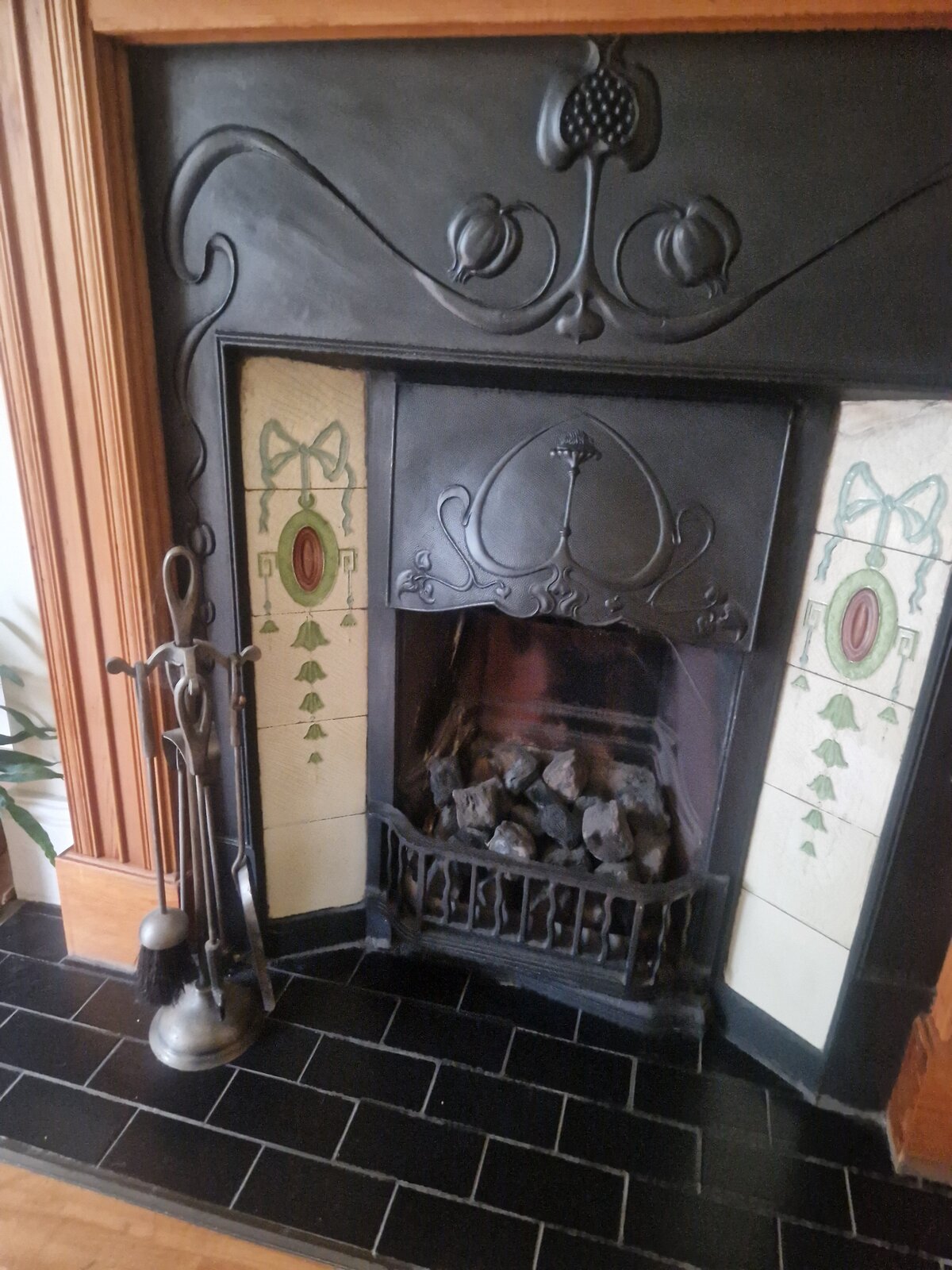

Hi,
I have recently moved into an old Edwardian property and the original open fires were converted to gas.
But the elderly lady we purchased it from says they were all capped off and doesn't know why.
I just wondered what my first step should be in finding out the issue?
Is it a gas engineer or do I need to chimney looked at?
So what is there now .
Old gas fire or a hole in the fireplace .
If going to use again get a Gas Safe engineer to inspect first .
Could be a number of things ,ventilation, chimney structure ,condition of appliances.
Sometimes families get gas appliances capped off as they were worried about parents using them .
Get a gas safe person who is approved to work on and install fires to check.

Thanks. The woman lived alone but said they came to look at it and decided it had to be capped.
I will get a gas safe person to check it out.
I have never used a gas fire before, its always been real or electric. Do they even put out much heat?

Thanks. We would use it as a backup really. There are two and apparently original, so I am not going to rip them out.
Thank you. We have a gas safe engineer fitting a new basket and doing the checks.
From the photos we sent apparently we have one where you turn on the gas from the side and throw in a match.
So we are going to update it with all the checks needed.
That fire is approx 25% efficient look nice but cost a fortune to use as a heat source. And when heating is on a lot of the heat in the room goes up the chimney so can cost you more that way as well
In reality the fires and the gas supply should be removed and disposed of permanently.
Fake nostalgia for open fires is not a valid reason to keep using such things.

The fire is original from when the house was built, they took the mantle off and stuck on the ugly wood surround. Then converted it from an open fire into gas.
So I am going to replace the basket for a new one. The ones I have seem have varying heat output. One I saw states 6kw, which would be fine for me..
6KW check that as it sounds more like input for a basket fire .
