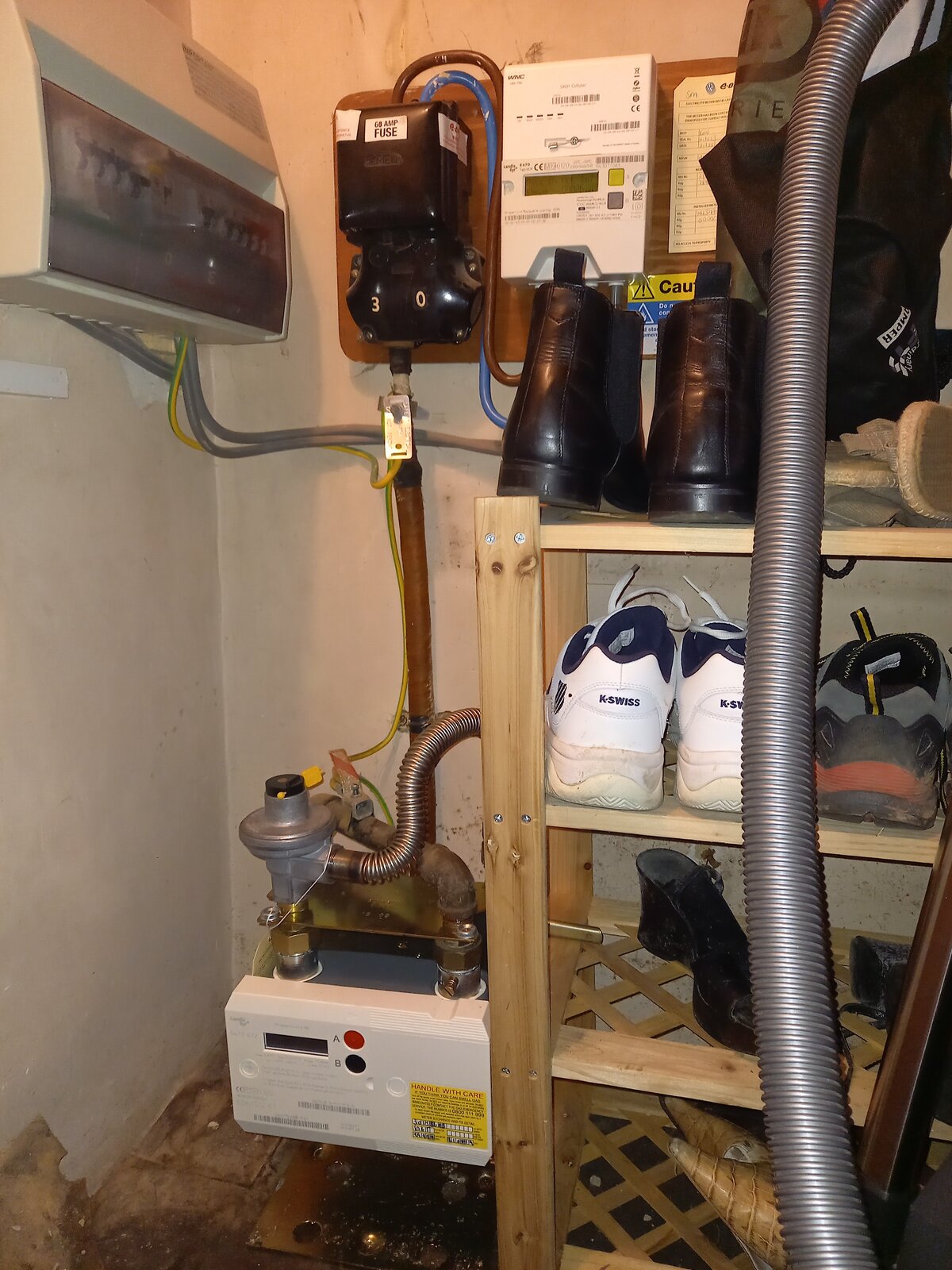

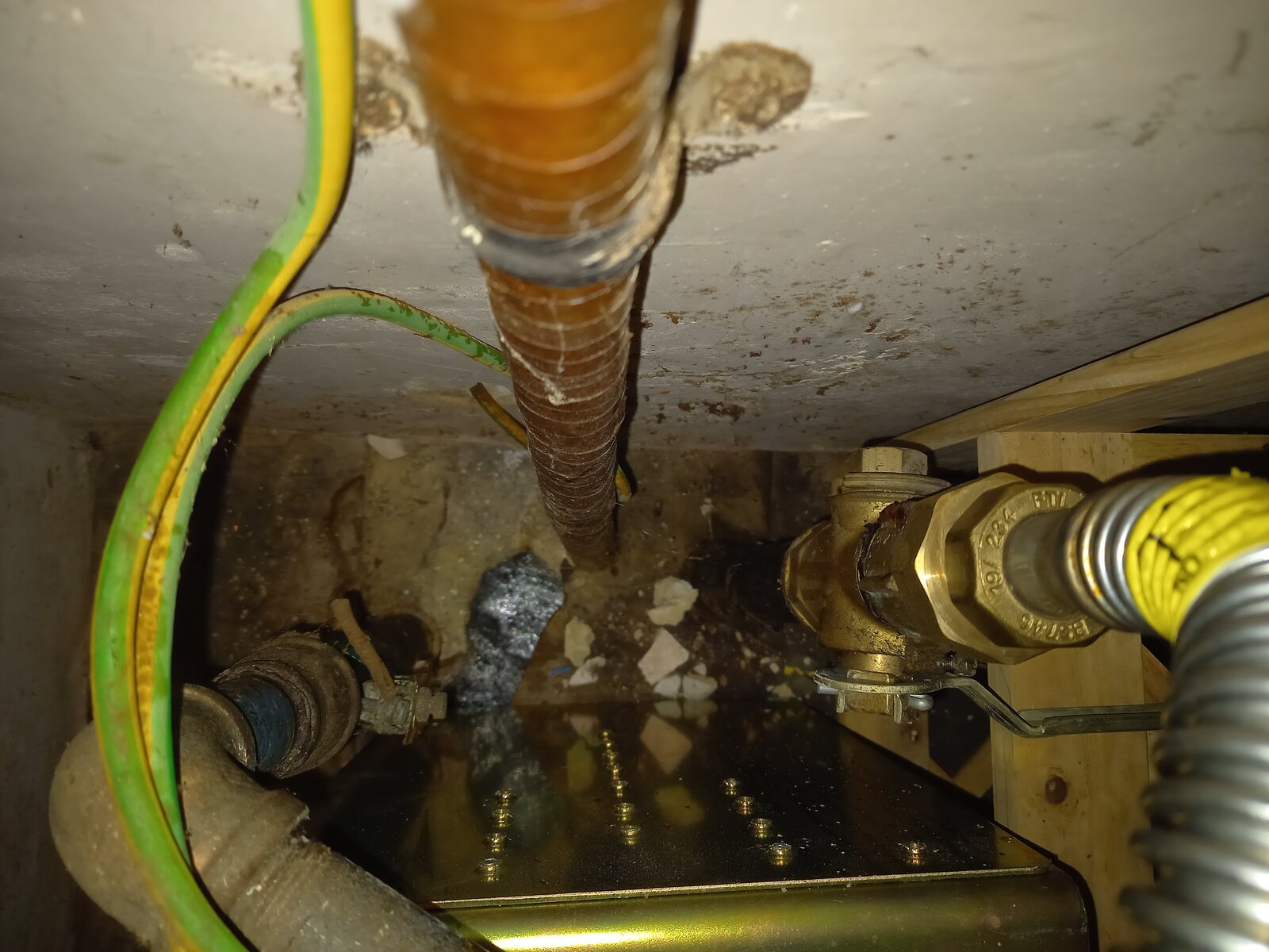

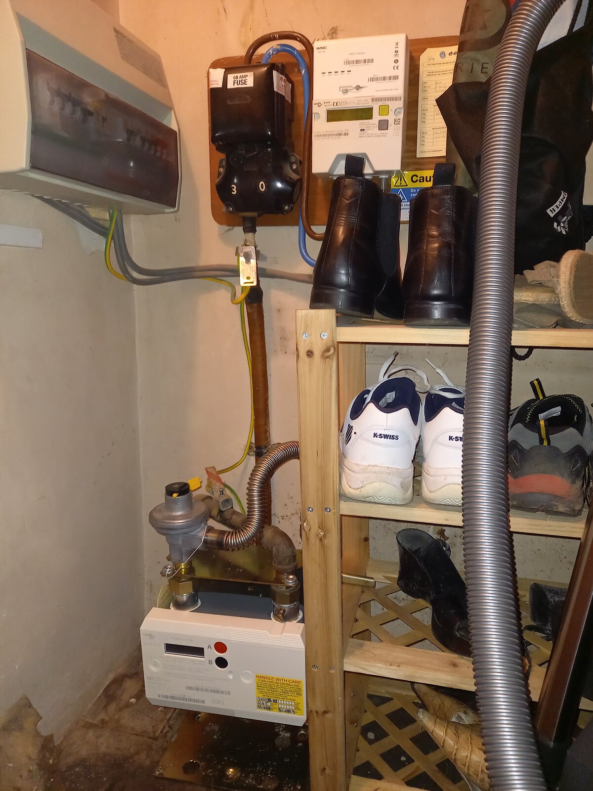

What is that lump of copper behind the meter doing- is it water or something else? Like gas to the boiler?
I have no idea.. do you mean the thing behind it? Here's a pic of the whole cupboard, and a slightly clearer one of the back. Any good?

I have only just noticed pics! Are you BC sure that he could not do it simply because the square shank of the plug has been cut? It would have been cut to level it to the floor.
With the correct tool and possibly removal of timber it may be possible to grip the body and turn it

That's a very odd looking piece of copper- I was hoping it connected to the iron somewhere visible- now I'm not even sure if it's pipe :)

Ahhhhhhhh. Plenty of room to drill a hole and put a stud extractor in there- if that's the only problem (ie that cap is passing rather than underfloor pipe rotting) then that would be one way out.
Sorry don't think I sent the pic of the whole cupboard before.. I'm not sure what copper thing you mean so hopefully this helps
So assuming it is the cap rather than the underfloor pipe rotting, do you mean the cap could just be replaced/resealed without having to dig beneath the concrete?
Hah. I was looking at what I thought was copper tube rising behind the gas meter. Those 2 straight down shots made me think it wasn't a tube (plus no visible connection to gas pipework), that shot confirms it as electrical and definitely not gas :)

Yes, assuming there is nothing else wrong. Go for it, but get your gasman back to reseal and test

Quick update - I wrapped some tape around it and put the gas back on to test - really can't smell anything at all! So at least I know that it's definitely just the cap and not a bigger issue with the pipes. I have someone coming tomorrow to see if he can replace the cap, and I'll ask him to do the pressure test thing on the meter first (because right now it doesn't seem like anything is leaking!)
