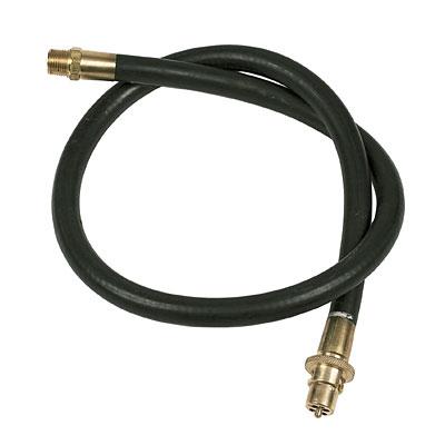

the freestanding cooker was connected via a flexible rubber hose as in this photo:
My gas feed is a 15mm copper pipe and the fitting on the gas hob is a 1/2" size.
The hob instructions states a rigid connection is required.
Can I verify that this is what the corgi man will do:
1. Cut the 15mm copper pipe.
2. Insert an isolation gas valve from 15mm to 1/2"
3. Then, insert a 1/2" copper pipe from valve to hob ?
Not sure of step three.

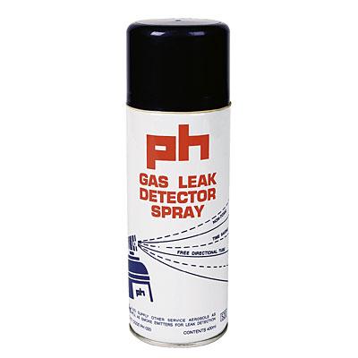

I've got a gas leak spray tester, you spray on the compression connections and if no bubbles appear you are ready to rock !

Thats not your diluted fairy washing up liquid mix per chance? :lol: :wink:

Dont you have to do a gas tightness test at the meter?
That does not meet the requirements of the Gas Safety and Use Regulations 1998 !
