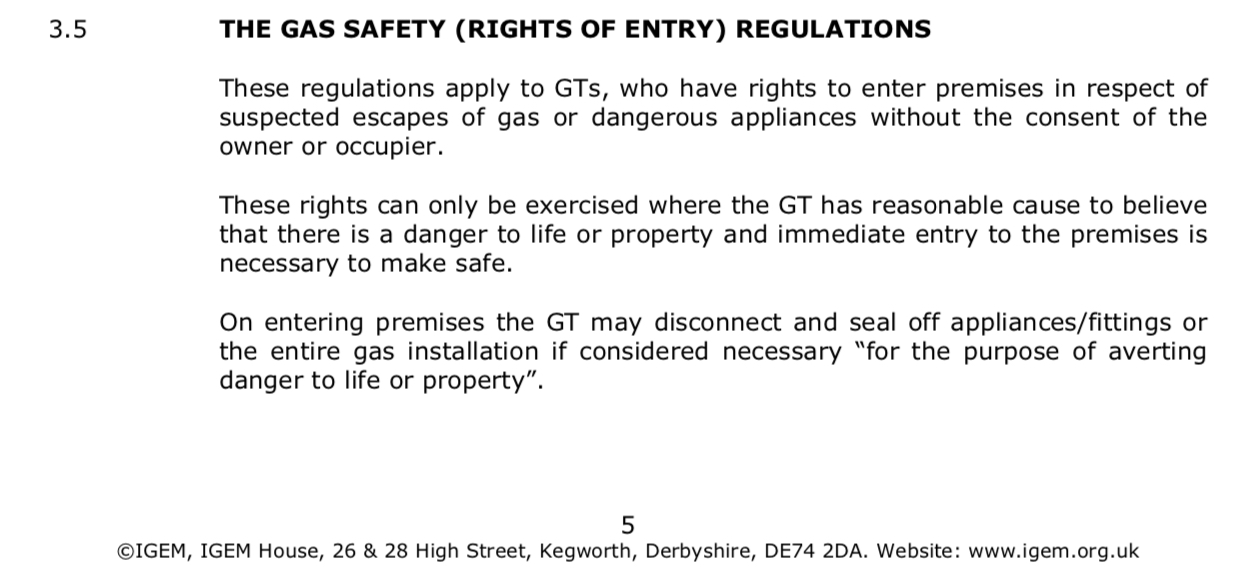

If the installation was classed as immediately dangerous, then the esp has right of access. If it’s a general inspection then as per @ianmcd they would need to be invited in or an agreed date when convenient for all parties involved. I would like to think, if someone has had a new installation they wouldn’t mind a free inspection for peace of mind.
Not strictly true mate, if a RGI classes a situation as ID and permission to disconnect is denied, the Transporter will be notified, they have no right of access , but will terminate the supply outwith the customers premises usually at the service connection at the gas main, but even the transporter does not have any legal access rights
Sorry mate, but I was only going off the giusp/igemG11
wrong ian they have rights of entry ID card that hangs around there neck gaining access can be quicker than waiting for a team to turn up to disconnect outside if owner of premises refuses access in an ID situation ,
99 times out of a hundred it wont need to be used after threat of it is used to customer
