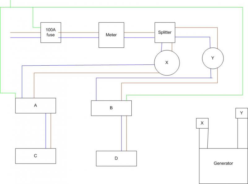

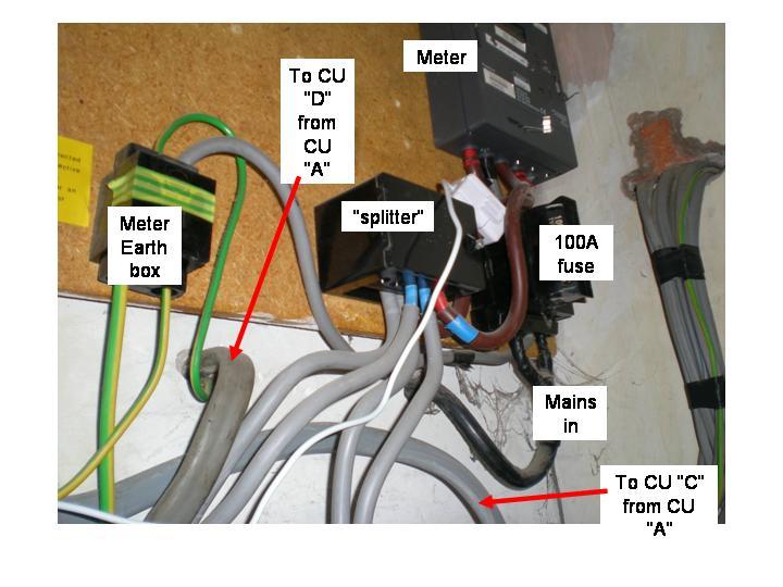

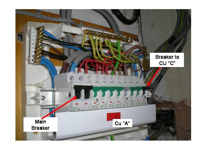

Please find attached a VERYbasic layout drawing of my house circuits and some photo's
The house was fully brought up to standards 3 years ago, requiring some rewiring of the original house section (old rubber wire), new CU’s with RCD’s and trip breakers rather than the original wire fuses, and some new circuits.
Due to how the house has evolved and grown over the years (it is originally 1948) with many extensions and now stands at nearly 3000 sqft area, there are more CU’s than the std 3 bed house.
Without major rewiring the original fuse boards where replaced in the existing locations with new CU’s hence why we have 4 CU’s list as follows
A- Lighting in main house, etc, and main breaker powering board C to main extension inc boiler

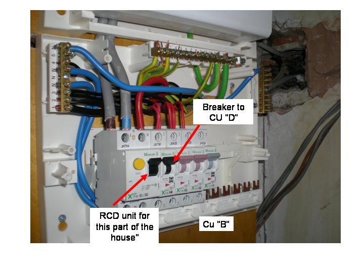

B – RCD sockets for main house + breaker powering CU for board D (kitchen)
C – Main extension with boiler circuit
D – Kitchen inc oven and hob lights and kitchen sockets
My thought now is to break after the splitter shown with the circles X and Y, there would be interlocked sockets (i.e they can not be unplugged without turning off.
So power goes, turn off isolators, remove plugs which come from CU’s A and B (and also supply power to CU’s C and D) then plug into sockets X and Y which are feed by the generators 2 x 16A 240 v sockets
Does this make sense?

I think the generator may struggle with all the circuits connected (if energised).
If you have circuits you want to run on the generator in the case of a power cut then it may be best to have a fifth CU installed and the 3/4 essential circuits moved to this.
You could run a set of tails via another Henly block (splitter as you call it) into a changeover switch (with generator connection) and then the new CU.
I think this has already been suggested but i'm not sure how else it could be done if there are essential circuits on several CU's.
EDIT: Just seen your post while I typed - board C/D aren't too near. :cry:
Although it may be possible to run boards C and D via your proposed generator location and have the c/o switch there instead. This would miss out board A and B though?
ie - A and B supply C and D via the generator and c/o switch.

thefore is it not just simpler to take off rom the Henley (Splitter)? And in effect give power to the whole house but using a bit of common sense not turn the oven on?

But back to my latest question, would I still need a 100A rated switch or plug (isolate before disconection) after the henly box (Splitter)?
If it's before the CU's then yes, you still need a 100A rated c/o switch.
