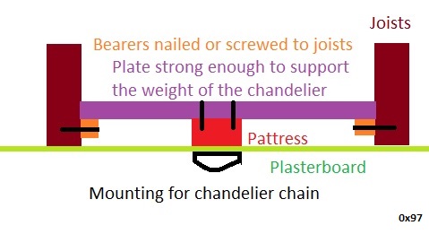

Need to put one up but as the weight will be pulling directly down don't want to mess it up. I suppose there's a risk of going through electrics etc any tips?

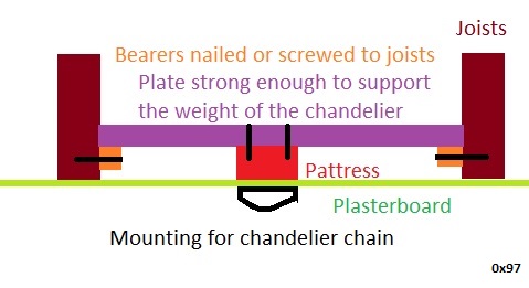

Work from above ( lift floor boards ) if possible and fit 25 x 25 mm bearers to joists. These then support a plate which takes the weight.
I guess plate could be 18mm ply
