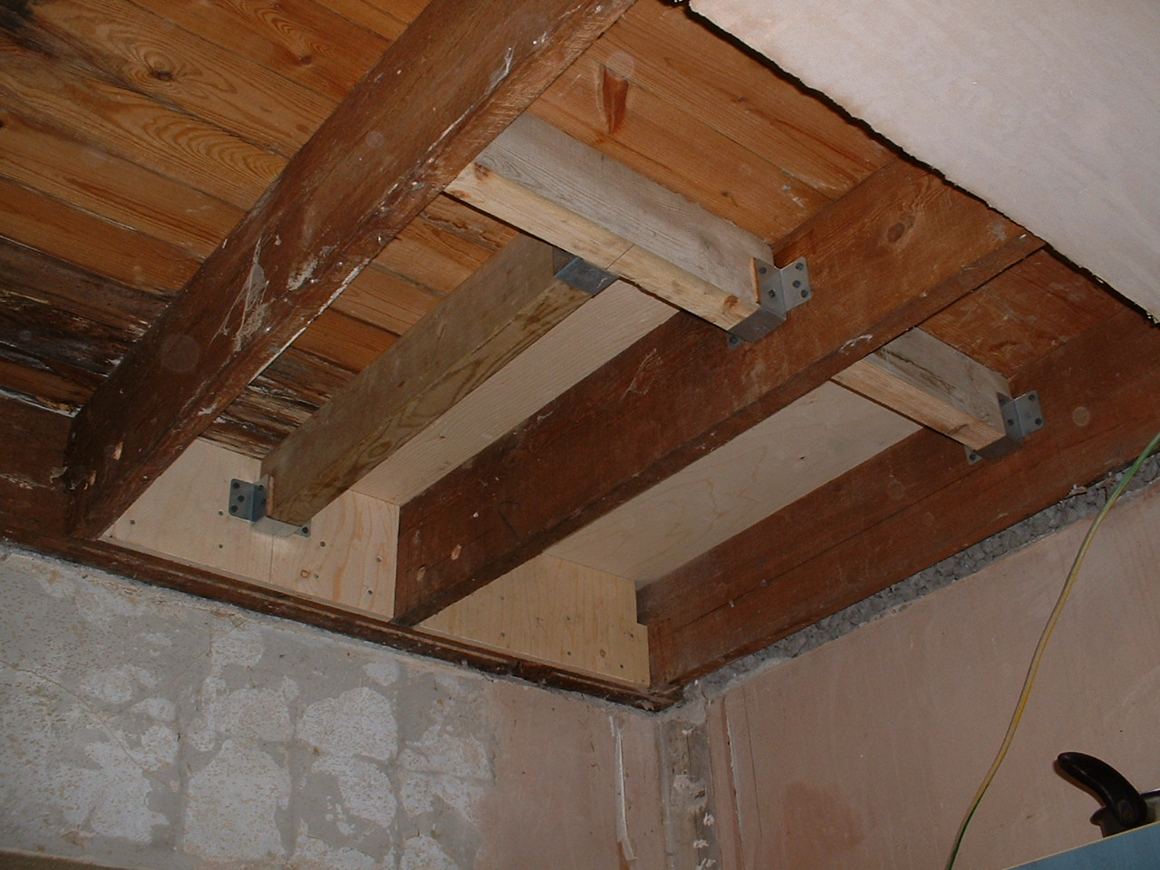

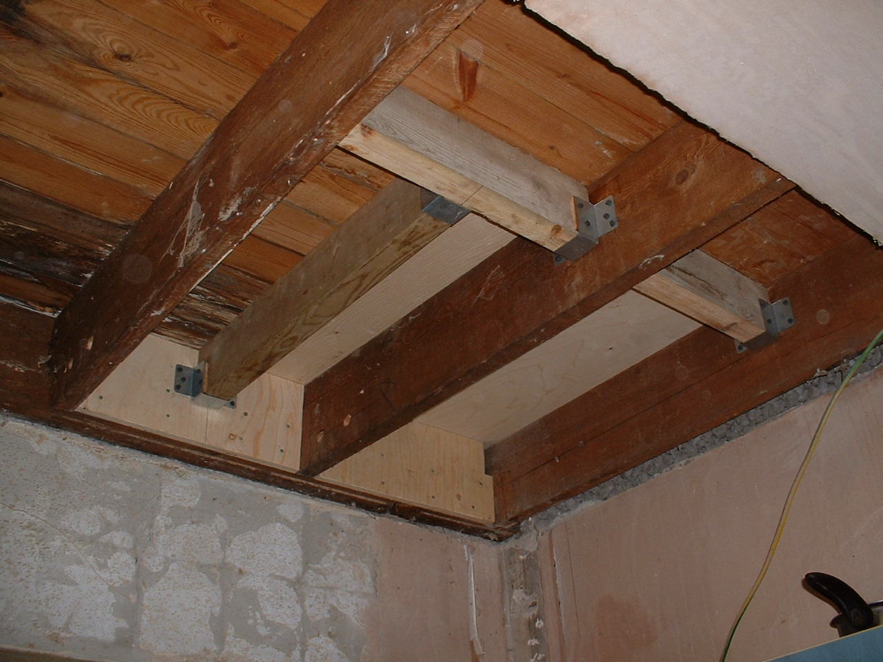

Off the topic of waste piping: I aim to install a 700mm x 700mm shower tray, it's made by MX and it is part of a line called "Elements". I think it's also DucoStone. It's very lightweight and it has to be laid upon a layer of cement. I suppose it won't take much flexing of the sub-base for the tray to crack.
I've put in an 18mm thick plywood sub-base. And it's supported on it's periphery. The arrangement at the moment is per the picture.
Is the support satisfactory as it is? Or is there a need for noggins crosswise of the joist which would make a kind of cross arrangement. Thanks.
EDIT: I suppose I could add the noggins, just to be doubly sure.that the plywood won't flex.

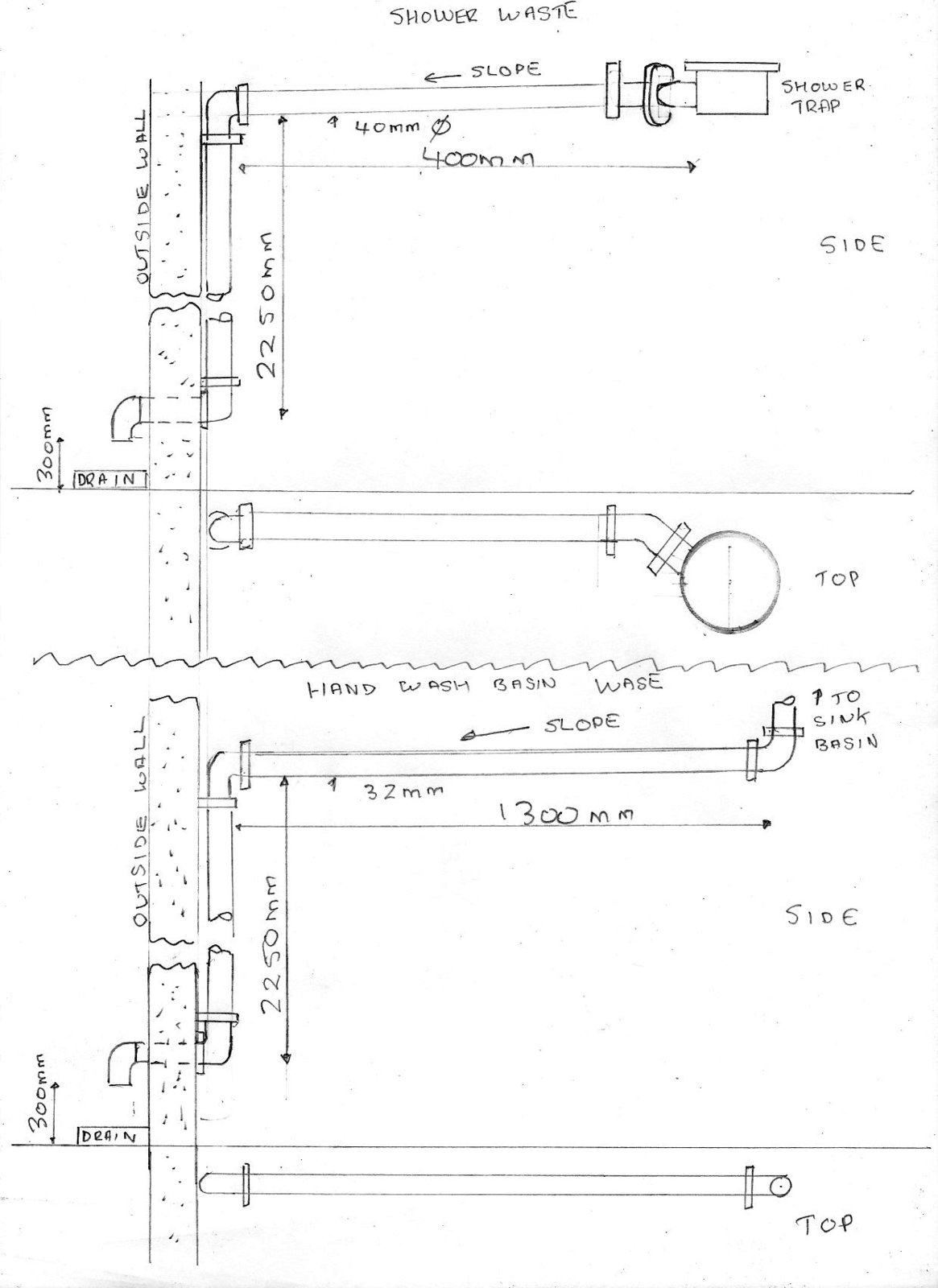

I think I will have two separate waste pipes, one for the shower, one for the sink. On the drawings I have made (See below), is there anything missing? Thanks. There will be the usual trap just below the hand basin. Just a hair trap in the shower waste fitting. Hope this suffices and no fumes get through into the house.
Nothing wrong with your drawings, and keep them separate if you can. Why the 300mm air gap to the gully? Ideally you want the waste terminating below the gully grating but still above the water line of the gully trap.
Around 45mm per m fall is the ideal, max 90mm, too much horizontal fall on the waste pipework can create self syphoning/gurgling at the trap.
Your support looks fine but extra dwangs for belt and braces is never a bad idea

Hi. Okay I feel confident now I'll be doing right having had my plans looked at. That 300mm really should have indicated the height above the gully where the pipe comes out of the wall. I will make sure the end of the waste pipe is much closer to the gully (by gully I presume you mean the drain), about say 3cm above it. I will also take steps to support the longer hand basin / sink waste pipe. I am also minded to use solvent weld components except the first bend at the shower waste trap.
