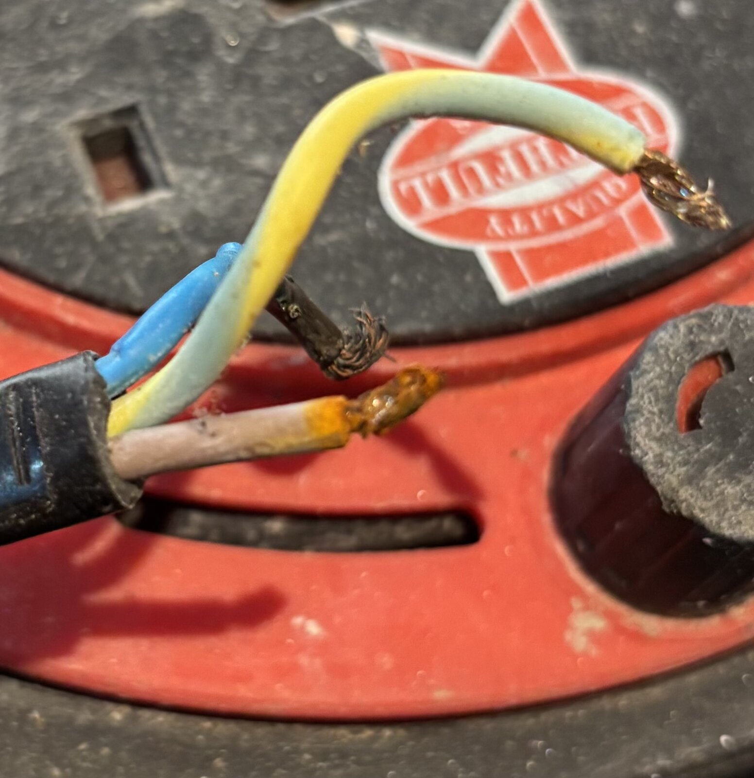

I was given this..
"It does work, but it's a bit temperamental" they said
Anyone else been gifted something that makes you think "Jesus wept.."? :D
Image uploading seems broken for me at the moment, still trying to edit the post

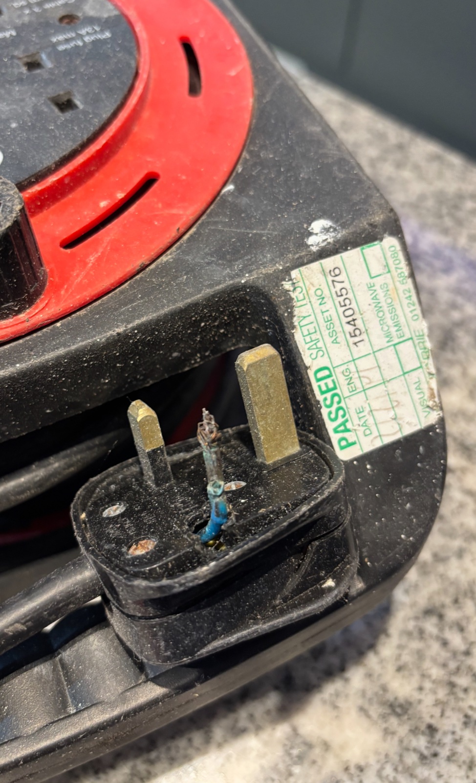

i would check the cable for any splits or melting and the insulation - also for continuity - insulation resistance may be useful
i would cut the plug off and replace it and also check the sockets - looks very used and probably abused
personally i would bin it my self and get a new one - as you do not know the history and last thing you need is to be using it and anything happen like a fire , or someone getting hurt etc
Yes it didn't get much better inside; cable is now 6 inches shorter
Aye, I've assessed the rest of it to be serviceable enough for what it will be used for, so happy to save it from landfill..
But it's a reasonable point that if someone is going to treat it like that one has to wonder what the rest is like!
