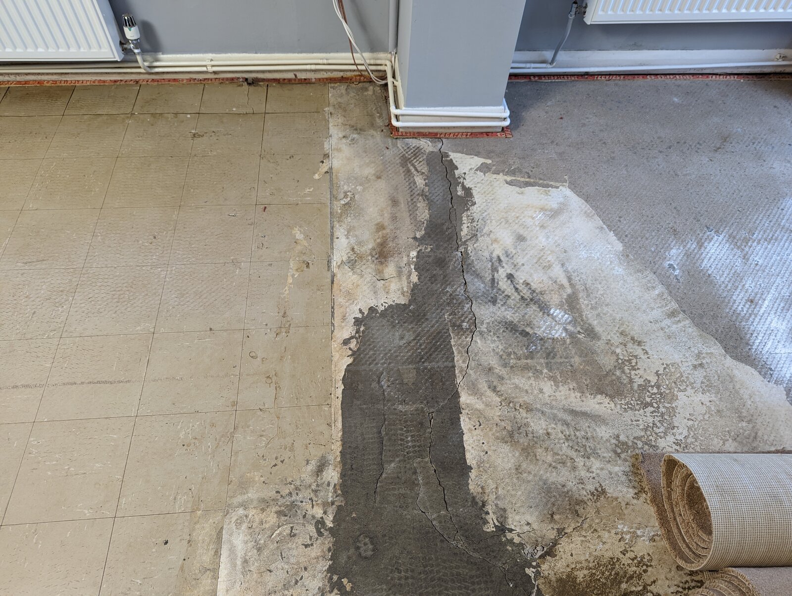

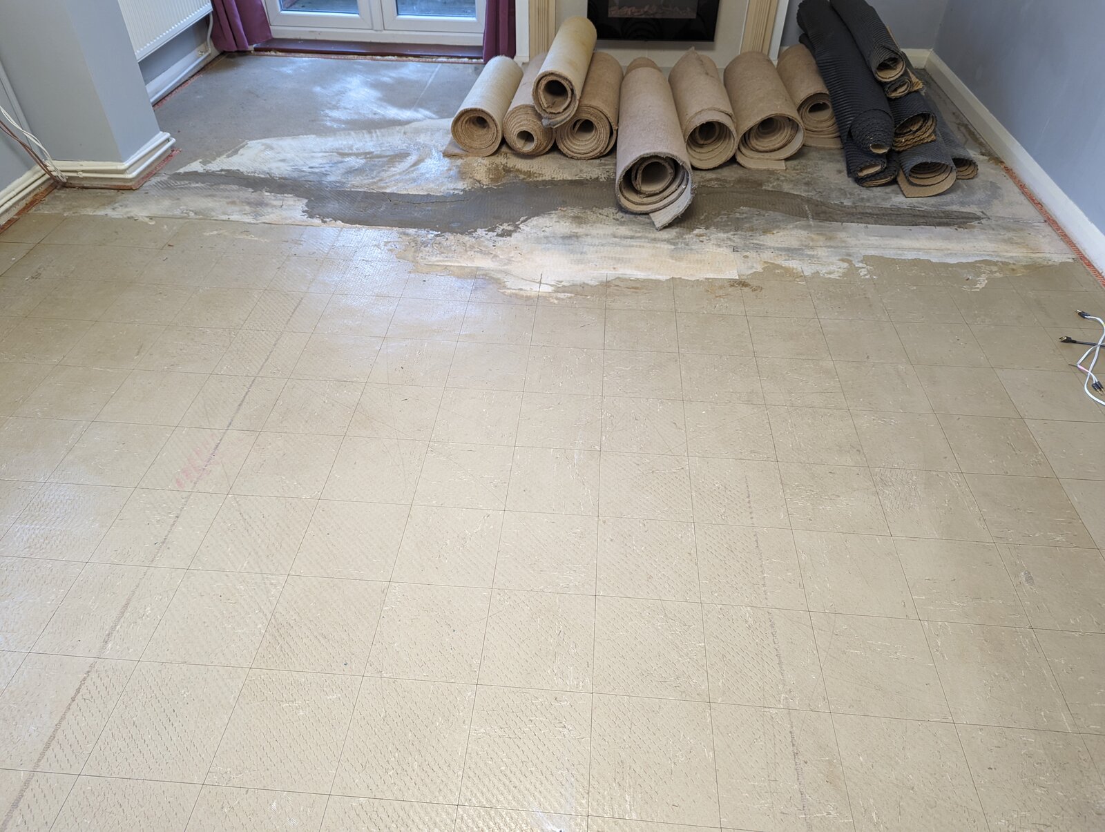

Well turns out that only half the room was concrete (the new bit that got extended) and the rest is this weird ?plastic/rubber? tiles that appear to be glued with bitumen I think. The tiled surface appears to be nice and evenly flat across the whole room while concrete bit has some dents and overall seems to be a bit lower.
What should I do now to prep???

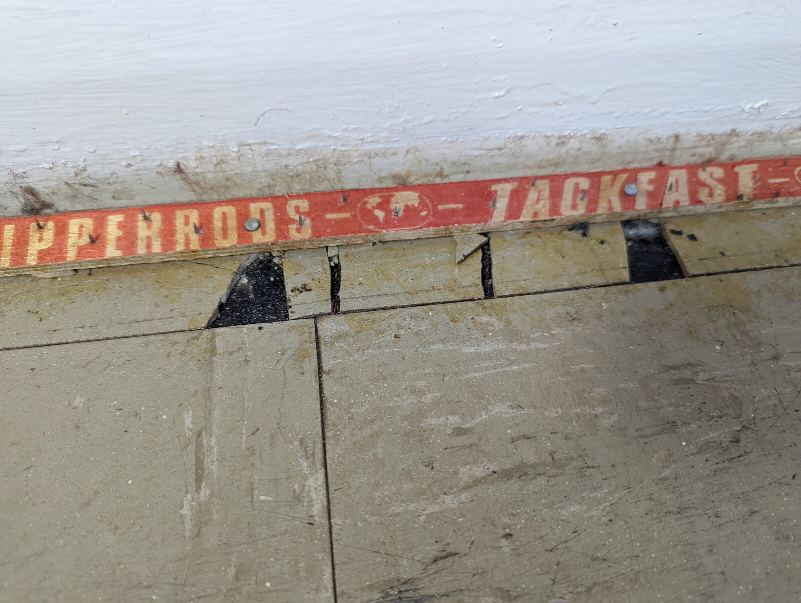

Not sure on the adhesive front to those old Lino tiles... please have a read up, but I’ve a feeling the tiles may contain Asbestos fibres... But this is depending on age of them.
If you are thinking of lifting them, perhaps you should get a small sample tested.

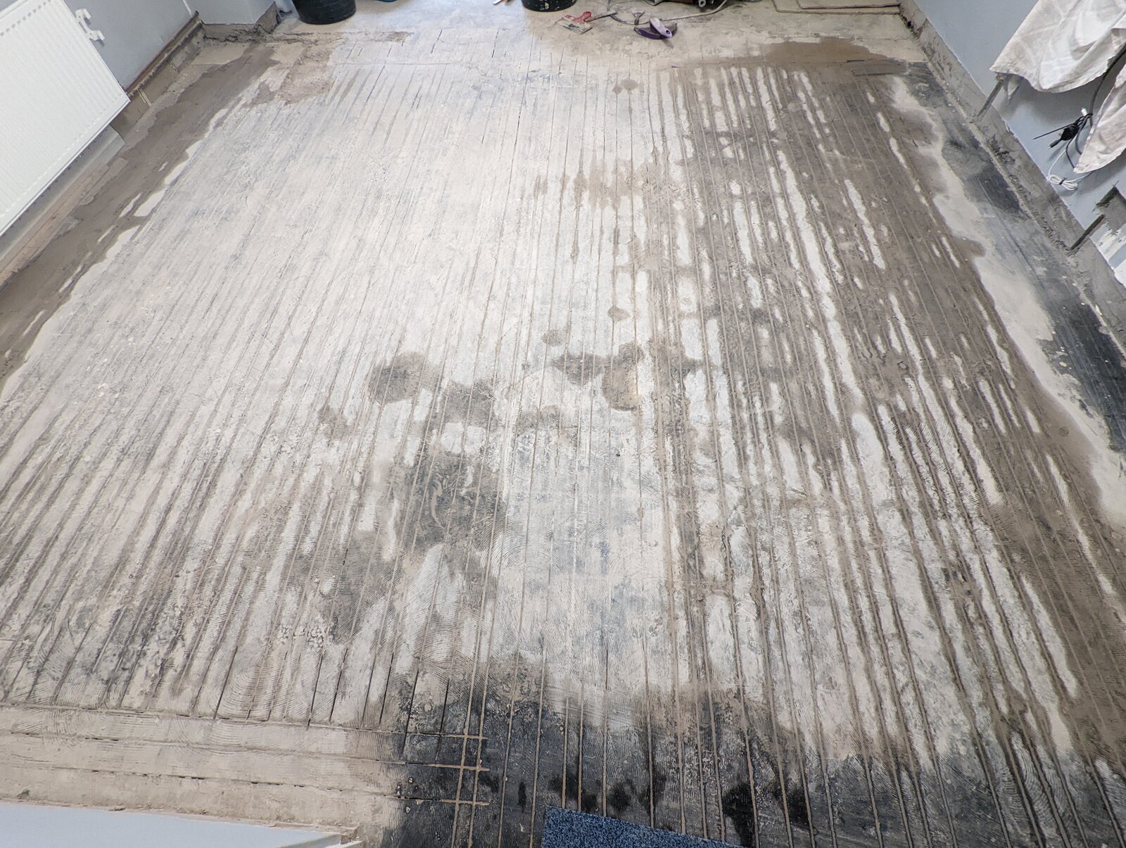

So you need to remove the vinyl tiles.
Grind off the adhesive and any loose screed.
check for moisture. The screed needs to be under 65%RH
Apply a smoothing compound if needed.
Apply a epoxy Dpm if needed.
Glue the wood.

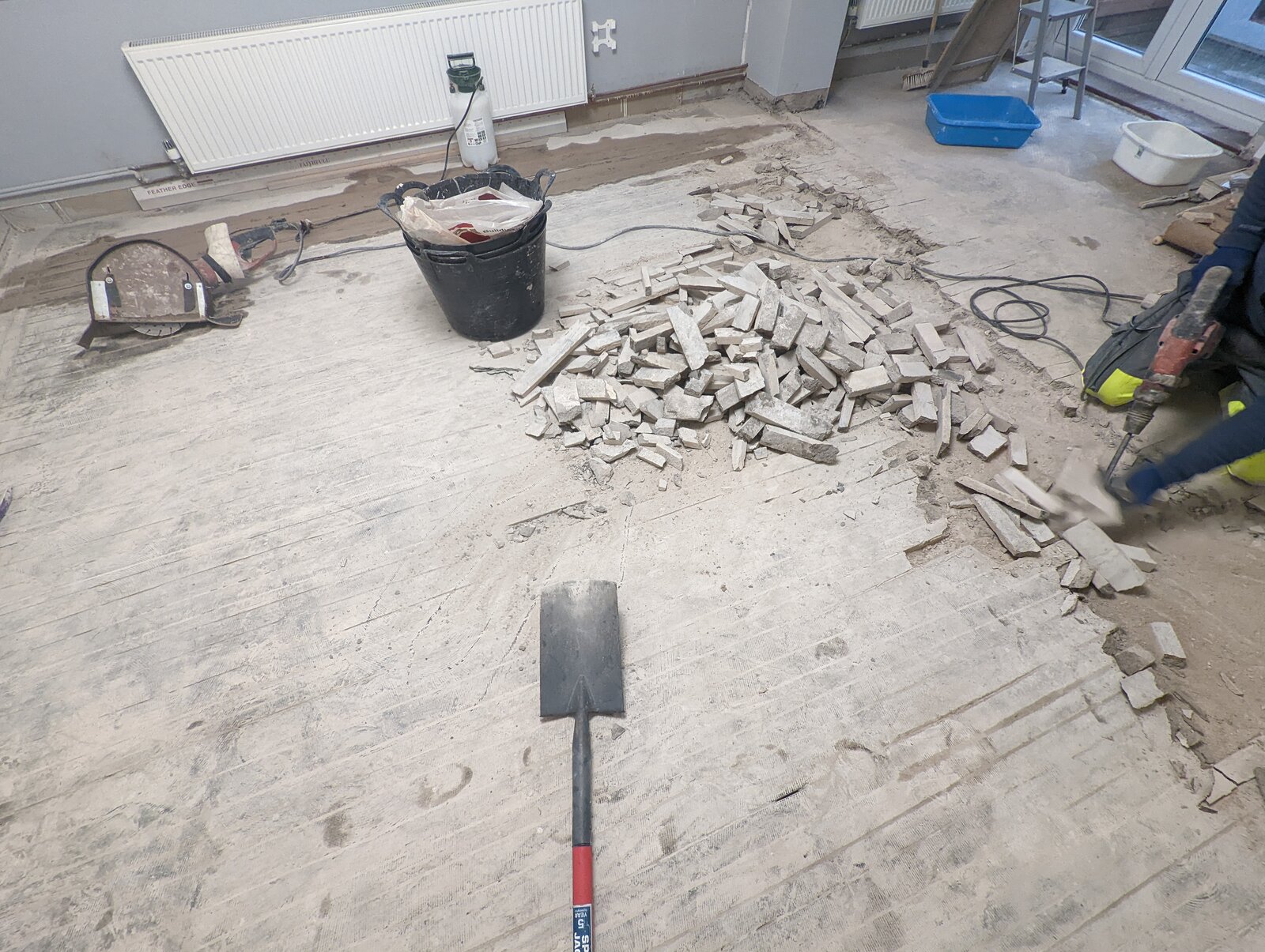

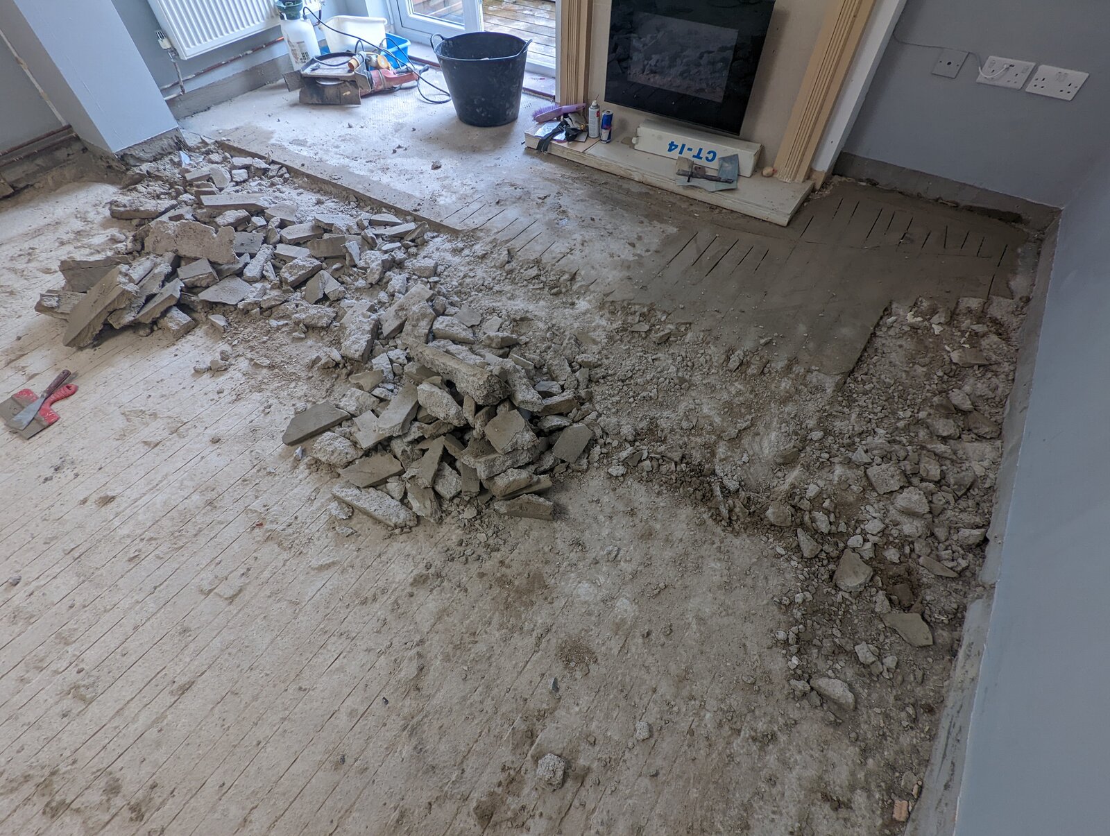

Small update. Did some cutting and chiselling:
NOW my question is how deep are water pipes meant to be? Would they be in the concrete or under the concrete floor in the soil? I am cutting into the concrete around 50mm, to chisel it.
