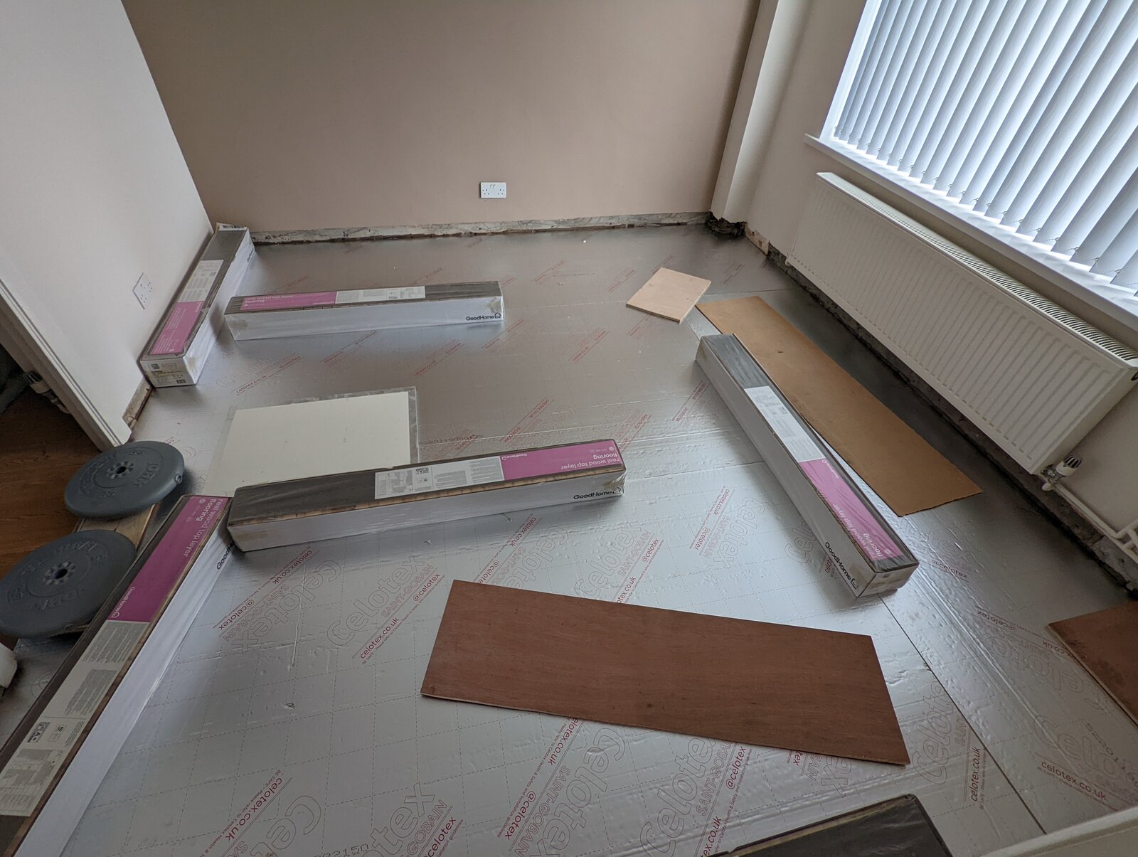

Resurrecting this thread, I’d be interested in how you got on with insulating and then glueing the floor down. I’m looking to do something very similar, replacing carpet with glue down parquet engineered planks but would first like to lay a thin layer of insulation to help battle the cold in my early 70s build. I appreciate the thin insulation won’t do much but I’d hope it’ll help.
Did you glue your flooring direct to the insulation or first lay ply/chipboard/OSB?

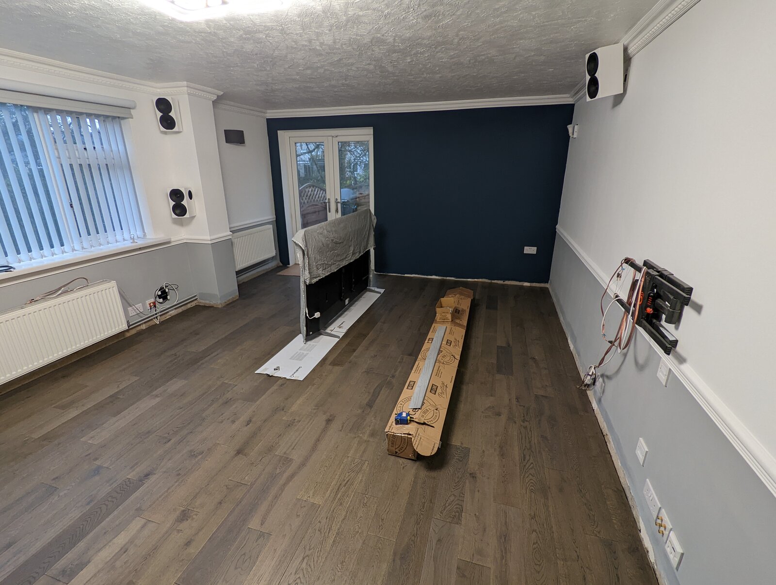

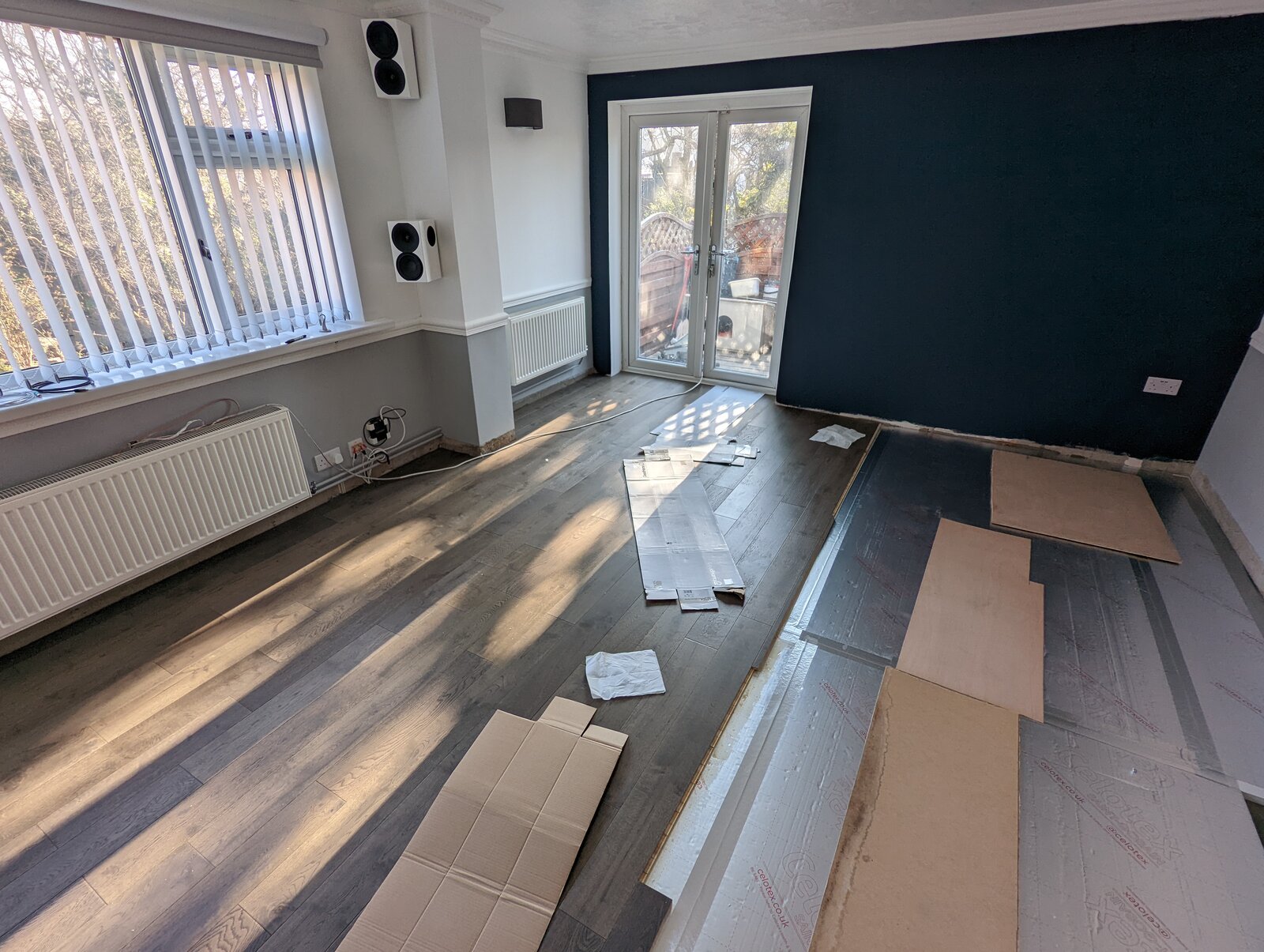

Hi, well it's been close to two years now and it's gone really well I would say.
I used Sika wood floor glue and first glued insulation boards to concrete then applied the same glue on the insulation and put the floor down. It's all been stable, noise free(no creaking ) and I feel no cold coming from the concrete underneath :)
thanks John, that looks really good.
What kind of thickness celotex did you settle on in the end?
I'll likely be looking at 10 or 20mm max xps board
I went for 25mm, if you're going with xps then 20mm should be just fine. I used 20mm xps for my underfloor heating in other rooms and that was perfectly sufficient.
