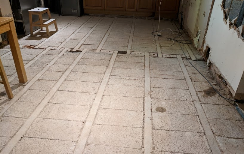

Hi.
Is there a best way to "Glue" PIR to a concrete floor. I have an existing screed of 70mm that I am replacing with 20mm PIR and 50mm flowing screed, just wanted to make the boards a little more secure while installing UFH pipes, etc.
My plan was for a few blobs of spray foam with a few heavy blocks on top of the board while it goes off, that stuff seems to stick to everything, even the stuff you don't want it to stick to!
Cheers.

Agreed with the above you'll need more like 80 to 90mm boards, but to answer your questions if you tape it together andand dpm on top that should help stop it floating away
Thanks all. The 20mm is being retrofitted into the existing kitchen diner. The actual extension has 120mm insulation. The 20mm was the max I could get given the existing screed depth. Do building regs have to be taken into account for the existing but if the house? 20mm is better then the zero that was there before. Thanks again.
Apply a brick stabiliser to the concrete floor, then use adhesive foam such as everbuild or illbruck

The flowing screed will be between 40mm and 50mm. Existing house isn't that level :(
Building regs plans were submitted and approved for the extension. The perimeter will be insulated. Only 1 wall will be external, about 4.8m.
No UFH heating beforehand.
