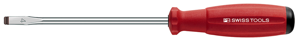

PB Swiss gets my vote for quality - especially their slotted screwdrivers, because of their parallel tips and flawless build quality.
Parallel-tip screwdrivers engage better and with less chance of damage. Regular screwdrivers with tapered tips usually engage at the top of the screw slot, where the tips are thicker, which can deform or damage the slot. Since parallel-tip screwdrivers instead have straight sides, the turning force is better distributed across the entire screw head’s slot.

However, to answer Woody's question: I've found that high-quality screwdrivers can make a world of difference when it comes to a partially stripped a head or badly rusted screw. Companies like PB Swiss put a lot of extra R&D into getting their bits to fit much better into screw heads, so there's less cam-out. They also tend to have a comfier grip and feel more balanced. I notice the difference, but YMMV.
Also, I find that PB Swiss slotted screwdrivers can be easier to use. They tend not to slip as much as other slotted screwdrivers and rarely chew up the heads of screws made from soft metal like brass. YMMV.

True. PB Swiss screwdrivers start at £3.
I wouldn't buy 15-20 of them! But I've never regretted buying a couple of PB slotted drivers to supplement cheaper PZ and PH screwdrivers.
