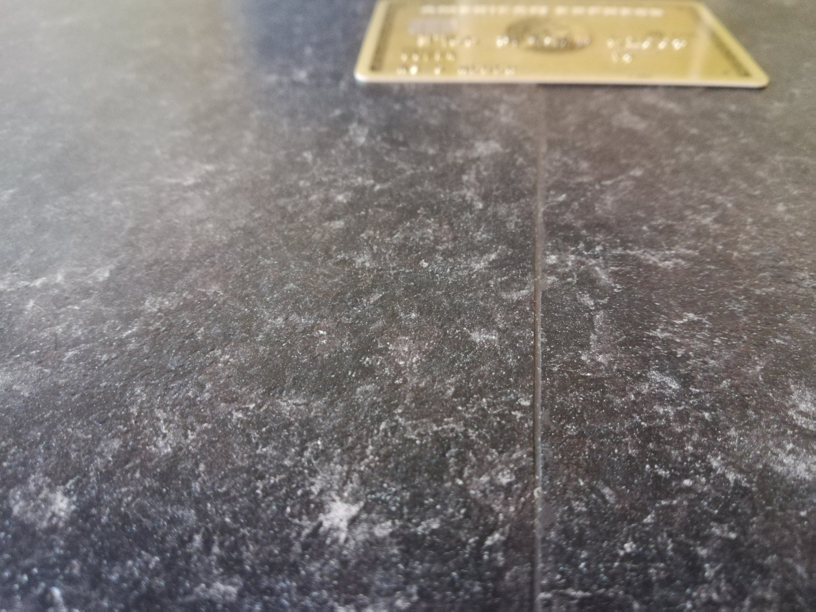

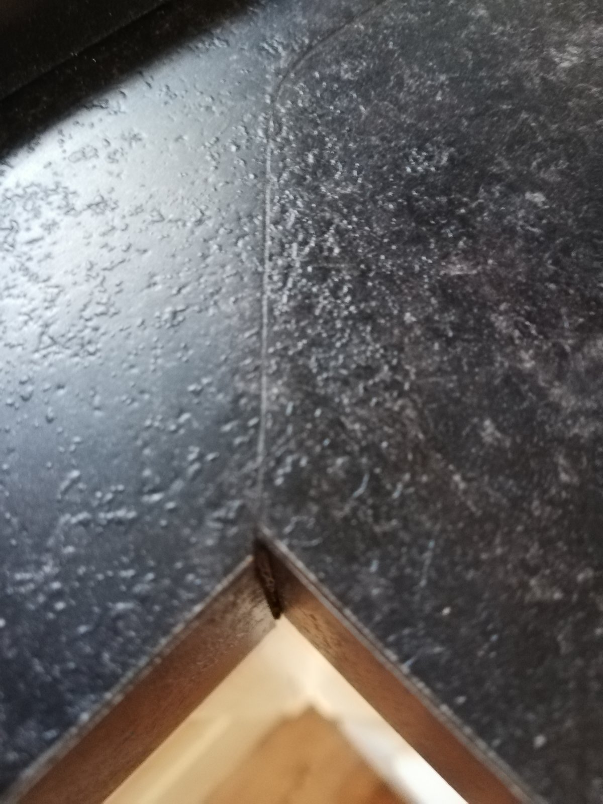

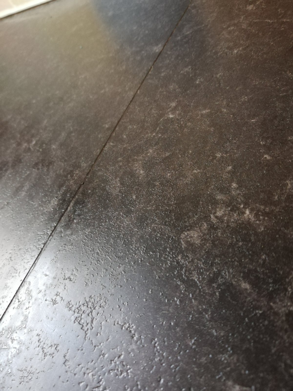

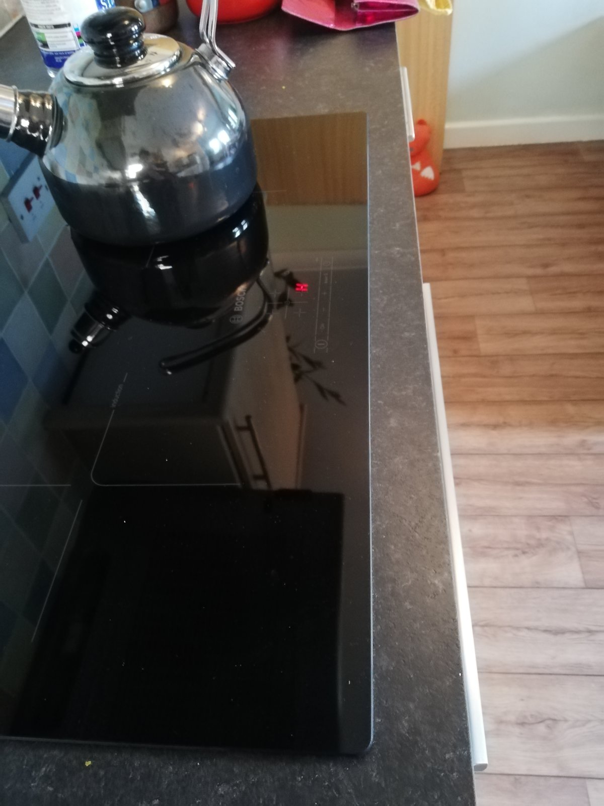

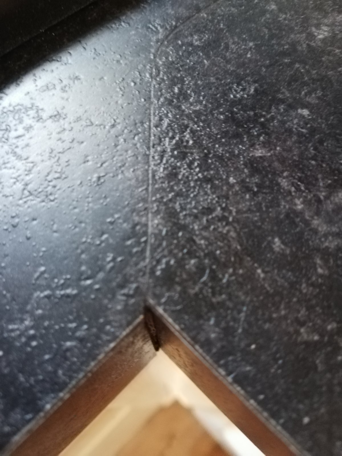

I've had a nice new worktop just put in but am concerned as it doesn't appear to be joined properly. One is slightly higher than the other plus there is a visible gap between them. I can see in one part it stack very tightly bit then it separated. The difference is noticeable and this is not the finish I was looking for. When I put a credit card on top I can see a gap. The hob was not fitted straight either. It is slightly off and at an angle, which is noticeable. Is there a way to remedy these without the need to purchase another worktop and without the damagee to the existing one? The fitter who did this is someone I know, which makes it awkward.

You are bound to be able to see the joint between sections, but the corner misalignment, step in levels and particularly the hob not being square is really very poor. Was this work done by an amateur, done as a favour for you?
I doubt it can be anything can be done, without buying new worktop and starting again.
It may be possible to take out the worktops and re trim. That all depends on if there is room in the set out to lose the adjustment.
It can be a reall bugger to get worktop joins flat -especially if the worktops are at all cupped. Its annoying because the worktop bolts are often behing cabinet rails and are wwkward to crank up tight.
Its not a disaster just not done with enough finesses. The quality would be fine for a rental apartment -but not a dream kitchen!

If the electric hob is like the hob I had fitted recently, there may be enough 'wriggle room' to square it properly - or at least improve it. The fastening clips beneath should be loosened, the hob rotated slightly (if possible) then the clips re-tightened. Not sure much can be done to correct all worktop problems though.

It's a real shame. I have been waiting to change the worktops and install new appliances for ages. It was such a disappointment. But the saddest thing is that when I've pointed the faults out to him he completely refused to take all responsibility. I began to think that maybe I am exaggerating or being too picky. His excuse was - 'it must have moved over night, it was perfect when I fitted it!' to both the worktops and the sink not being aligned properly. So I paid him only half the money as I just couldn't bring myself to accept all the faults. He tried to rectify it - he shifted the hob and put a lot of filler into the gap that was cut to wrong size. Still, there is nothing that could he done about the worktops being different hight and the gap and now the sink misalignment, apart from ripping it all out and starting again. Interestingly, he doesn't seem to think there is anything wrong with his work.
