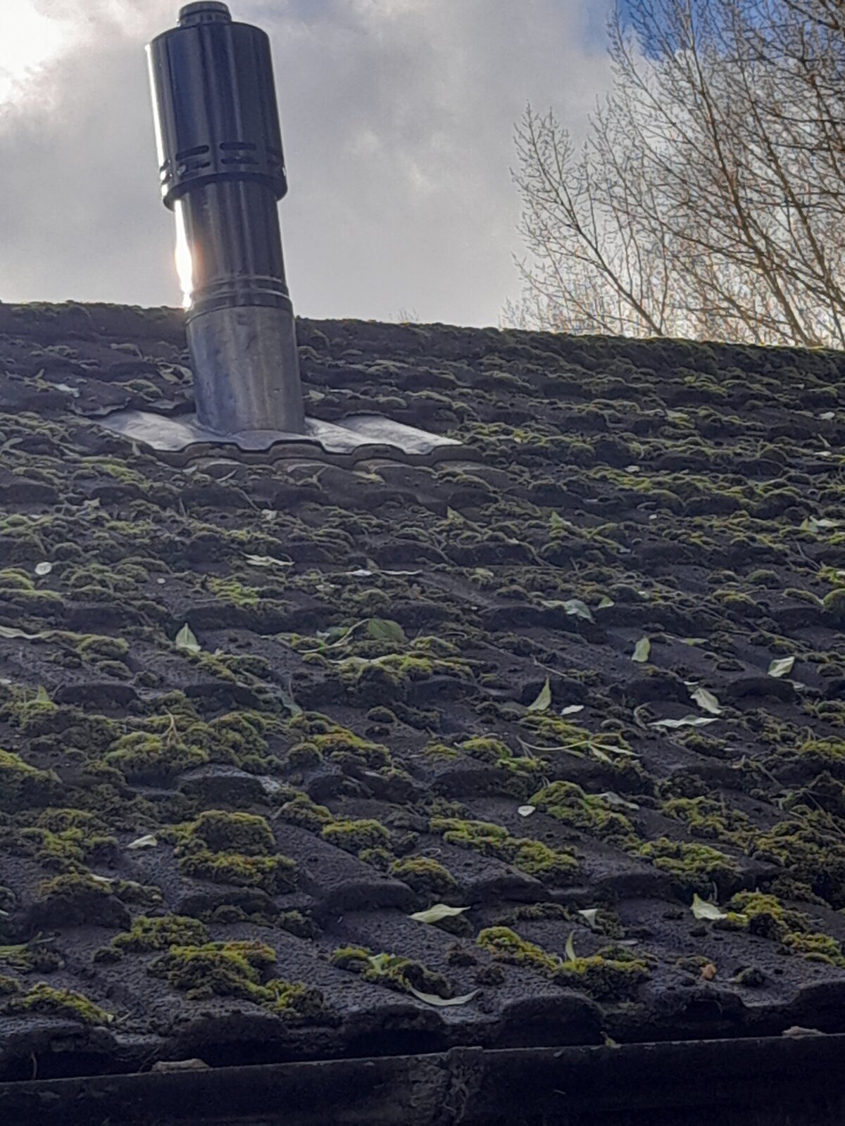

Hi everyone.
I'm completely new here and just looking some support and advice for a problem that is well beyond my knowledge base.
We had a new Grant boiler installed which is running our heating perfectly well around the house.
However every time I connect the snorkel tube, the boiler chokes up and shuts off. I have at present ljust left if off to keep the heat on but I know this needs properly fixed.
We also have a leak from where the flue meets the flat roof which drips down considerably when it rains heavily. This has started again today.
We did have the rubber part on top of the roof resealed initially but this problem continues to raise its head.
There were issues fitting this flue at the time and I'm not convinced it was all done correctly.
I have had someone else out to look at it but he didn't have any answers.
Any ideas? I'm convinced it is a poorly fitted / incorrectly set up flue (and likely boiler too) but I don't know much about these things at all.
I am trying to get another professional out on the case too.
Any thoughts or help very much appreciated.
Trying to help my elderly mother get this sorted once and for all because it really is upsetting her.
Sounds like the flue has not been install properly and is sucking polluted air in, which will cause the syptoms you have when you connect the snorkel to the burner. Get the installer back to check it out. I imagine it wasn't commissioned correctly, as this would have been picked up.

Grant registered installer here
Which flue system do you have ?
There are any amount of different options!
Clear pictures of all of flue from in boiler to termination please.

That is to be blunt an appalling install difficult to see anything good about it.
The flue is a Grant white system vertical flue.
The terminal should be a minimum 750mm from any surface, all in manufacturers instructions.
No white flue should be on show externally the flue terminal should fit down onto a correct roof slate.
It's possible the flue has been incorrectly assembled causing the issues your experiencing, only way to check is take it apart.

And with my very limited understanding, this also looks like a pitched roof flashing kit and not the flat roof one that is required. Would that be part of the problem too?
Totally wrong flashing the attached pic shows how the terminal/flashing should look just think flat roof not pitched!
Your boiler should have a 5 year warranty if correctly installed and registered with Grant.
