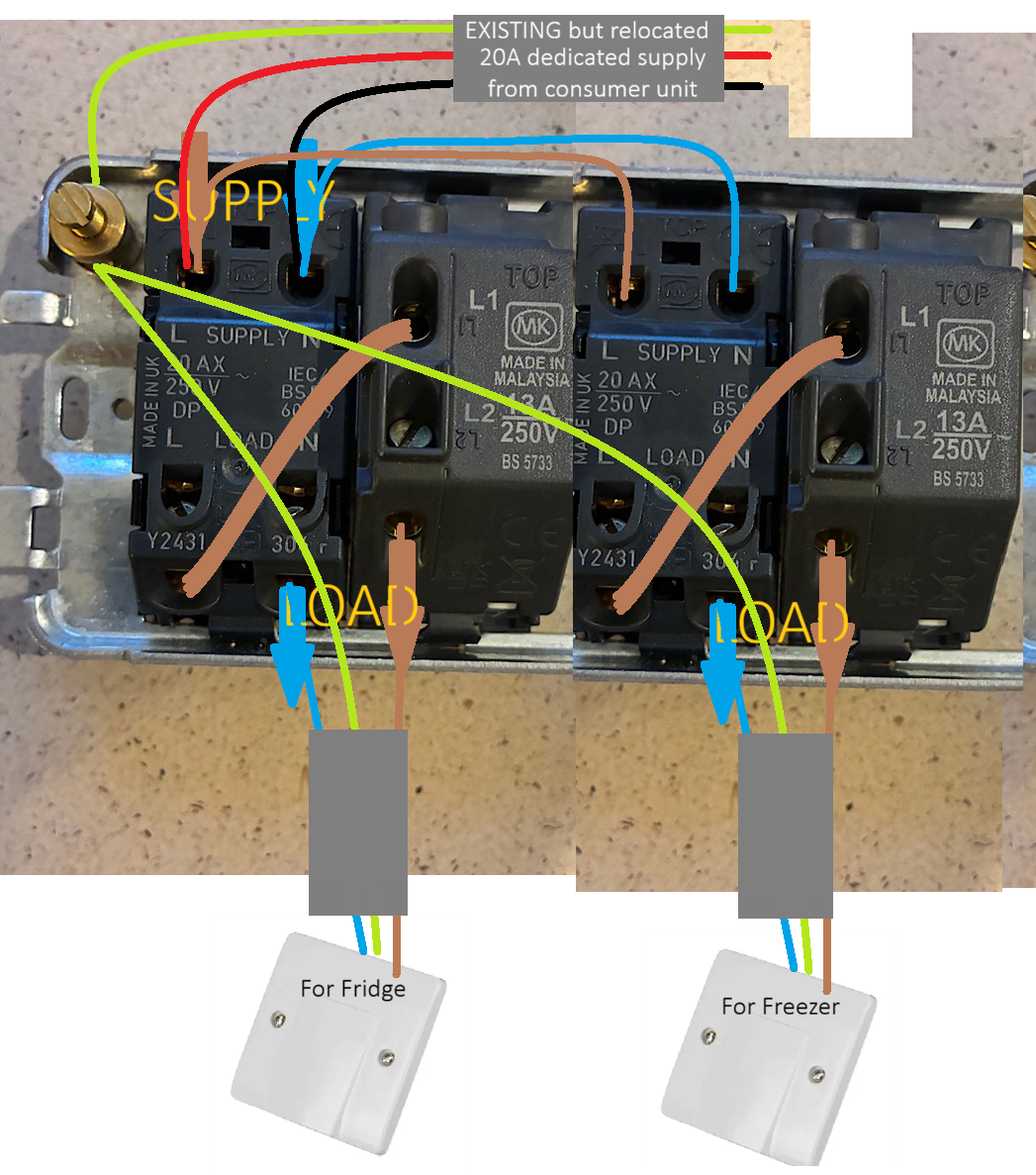

Grid switch fuse wiring help
Now you have lost me, what is this 'flex outlet?'
I have a dedicated circuit for the fridge freezer with 20amp rcd. I needed to relocate the original socket/supply so I reran this to where I needed it to go, and then used a 20amp unswitched flex outlet plate on a recessed back box.
Will this be the final circuit?
I've shown the existing circuit as red/black wiring only to distinguish it from the new work.
