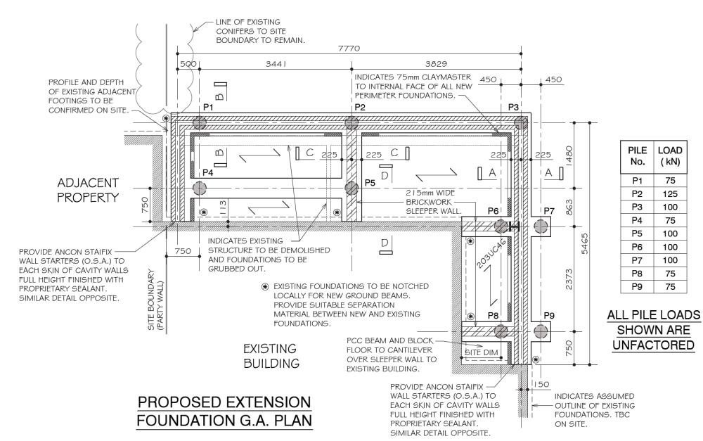

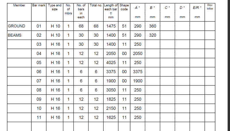

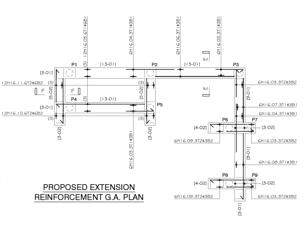

May the drawings below will give you an idea of what needs doing :)
