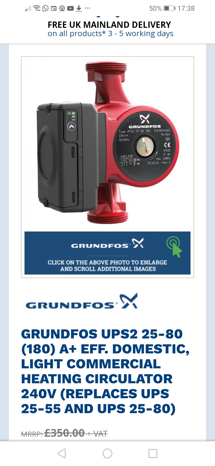

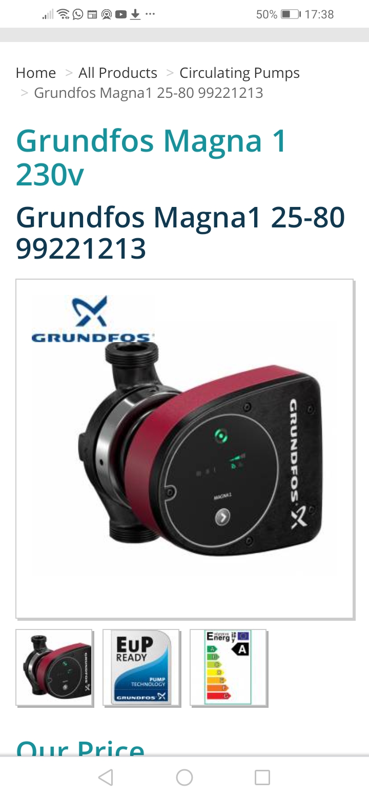

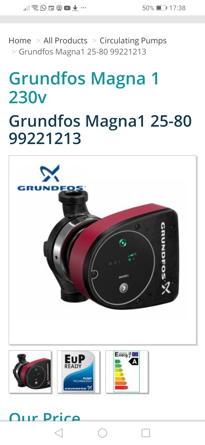

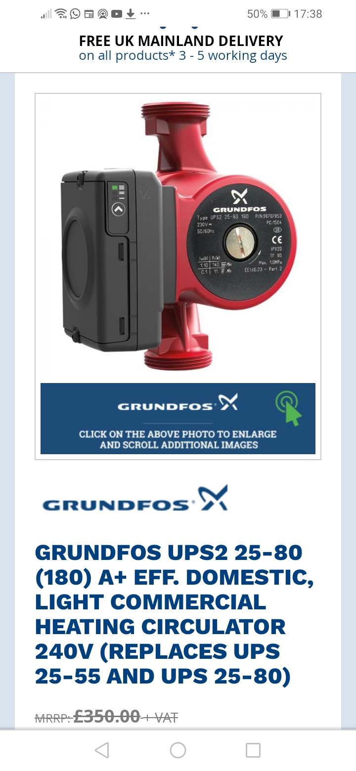

What's the difference between these two pumps. Guessing ones more of a 'smart' pump?

Correct yes. Is it worth the extra money for the magna one?
Quiet an old system all copper 28/22mm with 15mm to the rads.
I take it the grundfos magna is a smart pump? That will adjust its pressure of its pump to the system demand?
Both pumps have been discontinued by Grundfos, so what you have found are end-of-line stock.
With 35 radiators, you have a very large system. Has anyone calculated the system index (max head and flow rate), so you know what size pump to buy?
Sadly not. The pump is the highest point of the system really. So not sure what this means with regards to max head. As its at the heightest point. Any help. Would be greatly appreciated. The pump on the old heat only boiler that was in was only a 15/50 60. Grundfos.
UPS15-50 is 130mm long.
Those two are 180mm long.
Be a tight squeeze!!
Google index circuit, the position and height of the system is irrelevant...head refers to frictional loss in the system when circulating the water at the maximum required rate. So a 6m Grundfos can create a 6m pressure drop across the system when the flowrate drops to zero...you'd never run the pump like that obviously.

If the old system worked OK with a Grundfos 15-50/60 (which model?), you shouldn't need an 8m pump.
