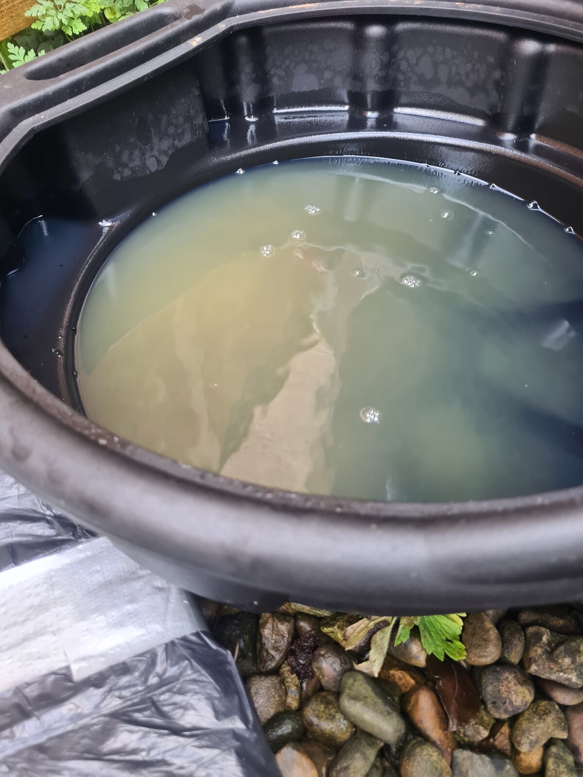

Took some time for myself today and visited an old friend.
She's been stood idle for 2 (probably 3 or more!) years and needs a bit of TLC.
Drained tank down, purged fuel lines and filled with Long Life Petrol.
Manual rotated crankshaft 4 turns as they have a habbit of jumping timing.
10 seconds cranking and fired straight up!.

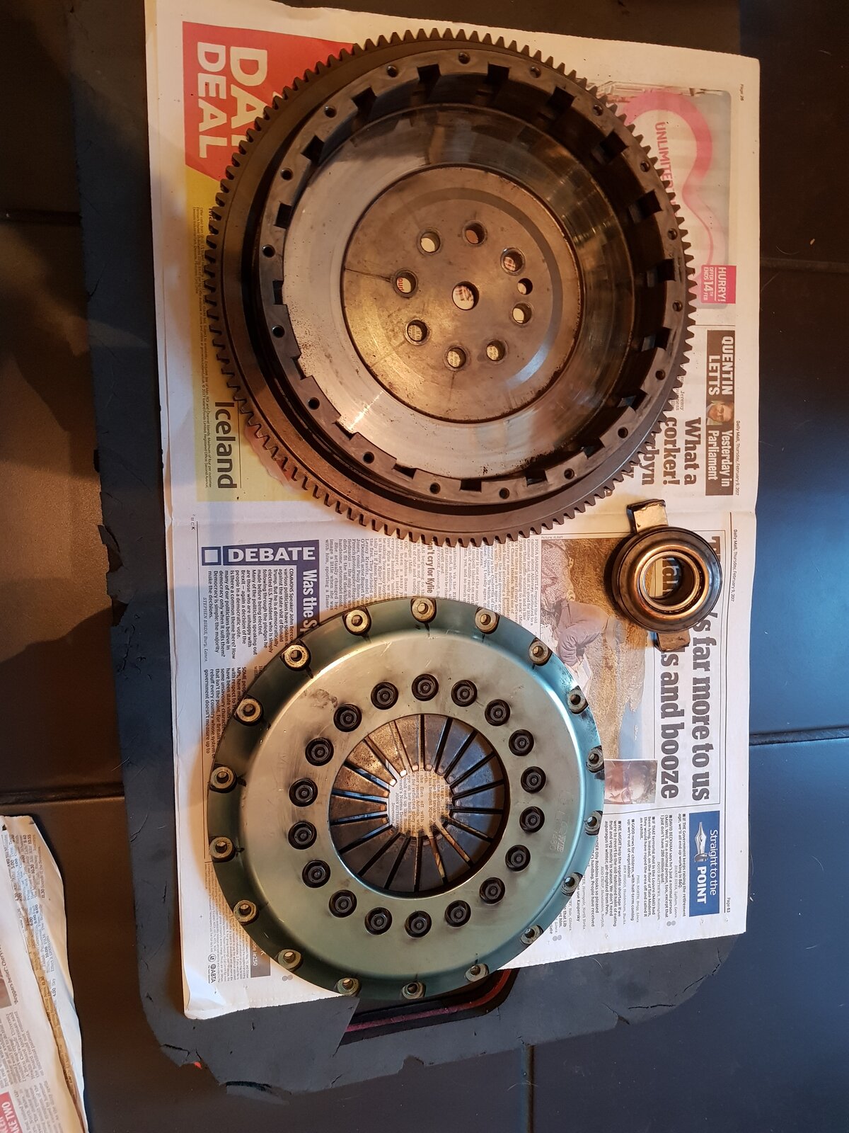

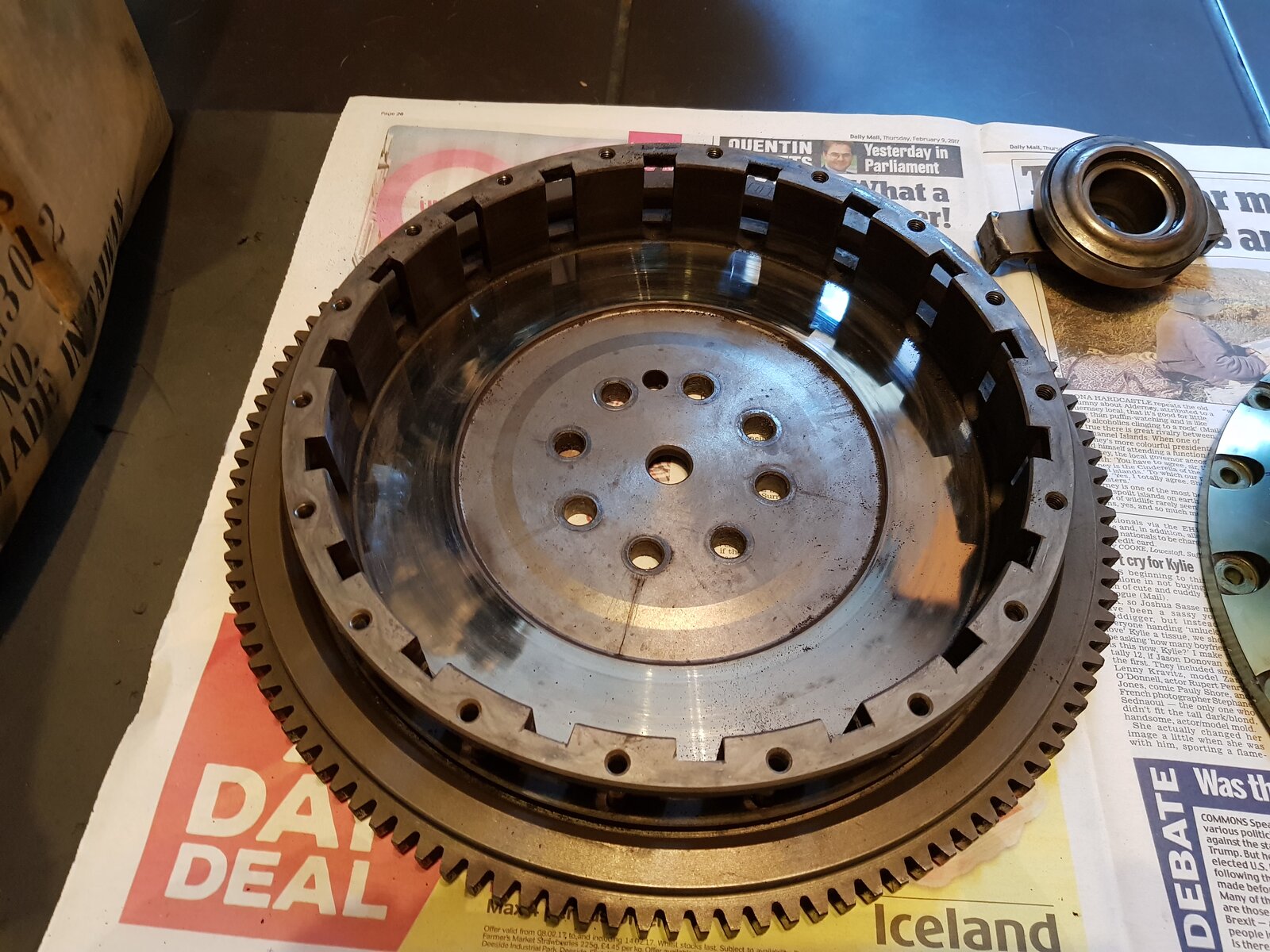

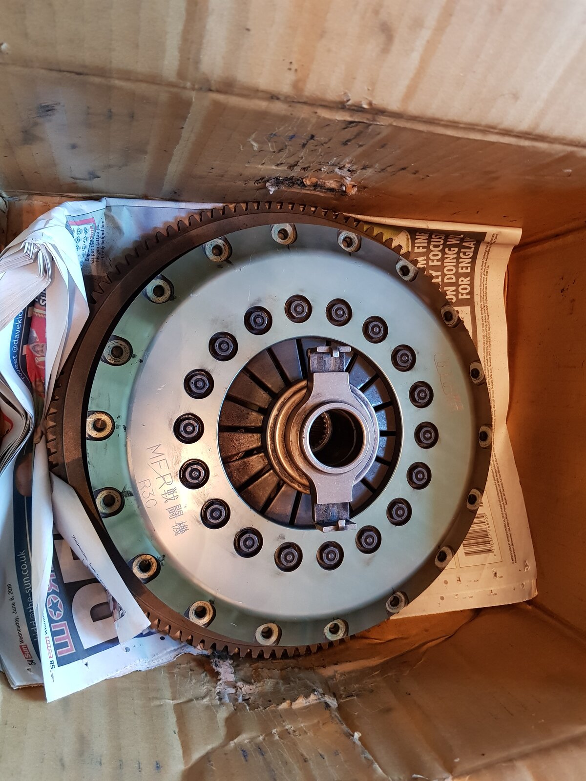

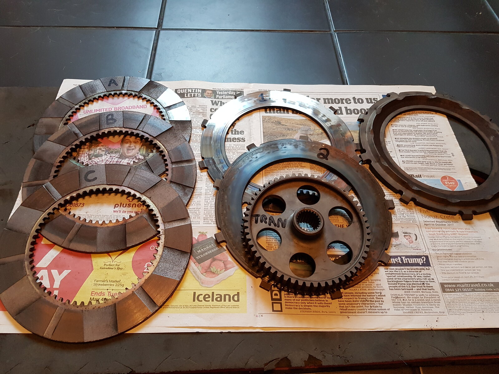

I'm putting it back to a useable road car, had an OS Giken R3C tripple plate billet clutch in but that was horrific for road use, looking into getting some carbon plates made up for it at some point rather than the cerametallic ones it comes with.

Thought the point in the multi plate clutches was that they weren't as hard to drive as a paddle clutch.
I always wanted an os giken in my starlet, but the exedy paddle clutch I ended up with was significantly cheaper and lighter and could handle the power, although it was about like a switch it was either on or off, which made traffic driving a bit crap, but lucky it was a 2nd car so tended not to drive it in situations of traffic too often
The pedal us very light on the RC3, it's designed to put up with repeated launching and abuse.
The Green cover (mine) is rated to 1500/ 2000 ftlb I believe.
Driving it is fine but it chatters when setting off normally.
I've been through a fair few clutches drag racing, managed to melt a 4 puck paddle clutch..
I'd like to try the R3C with carbon disks eventually, but not top of my list at the moment..
If you look at the friction plates you can see how it's been cut to promote more pressure, but unfortunately for normal road use it's too good!.
