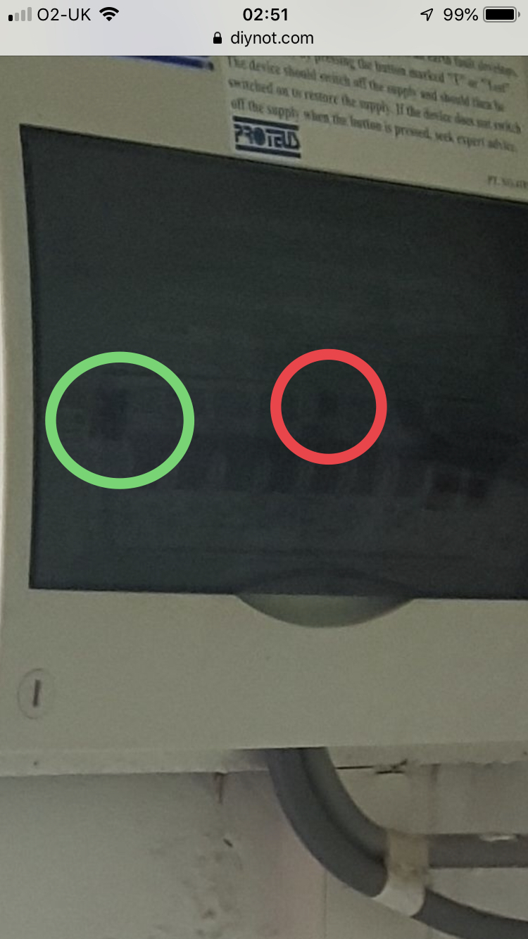

Buying an old house. 1920 ish
No electric safety records avail, although, its not the original owners selling (they passed away, this is their kids selling)
Surveyor suggest full electrical safely check and budget for a rewire. Although most of the survey suggests to replace things, that I think is just arse covering.
The house has been unsympathetically rewired at some point - all light switches are fed with cables in wall mounted upvc trunking (with gaps cut through the original ceiling coving and picture rails). Same with plug sockets. All are the cheapest, bulkiest white plastic switches and sockets.
Not sure if the plastic light switches were used because there's no earth, or, if the cheapest possible job was done on the rewrire. It was paid for by pensioners.
The consumer unit has RCDs, and a notice warning that both old and new style wiring cable colours are present.
The new cable colours was made mandatory in 2006, so the rewire was before then.
Anyone want to hazard a guess as to when the house was rewired?
Doesn't really matter, as I'll get it checked, and if it needs it, we'll do it.
Still curious to hear what you experts think age wise.
That consumer unit is from between 2002 and 2007 by the look of it, although you’re not giving us much to go on!
As for the wiring, who knows. A replacement CU does not automatically = rewire.
The best course of action would be to have an EICR carried out which will detail all the characteristics of the installation, and document what work needs to be done to it.
The CU is due for replacement.
Are you sure? it looks to me like it's a mainswitch only CU which would suggest to me that either it was pre 16th edition or it was installed by someone who was not current on the regs at te time of installation....
Edit just looked again at the photo and it looks like there may be a RCD barely visible at the far end from the main switch.
Are you sure? it looks to me like it's a mainswitch only CU which would suggest to me that either it was pre 16th edition or it was installed by someone who was not current on the regs at te time of installation.... Edit just looked again at the photo and it looks like there may be a RCD barely visible at the far end from the main switch.
Indeed, and although almost two blurred to read, the large label on the front of the CU appears to be talking about regularly testing the RCD.

I was working off it the fact there’s an RCD test label, and I can’t see a two module RCD. It looks to me like way 3 may be an RCBO which would suggest 16th edition with RCD protection on the ground floor sockets only so up to 2007, and proteus changed from the older style boards to this newer style proteus geyer range around 2002 if my memory serves me correctly.
I think that is a test button in the red circle, and the square in the green circle is just a reflection on the Perspex flap
Yes it is. Good eyes! "Test quarterly, seek professional help if it doesnt work etc"
