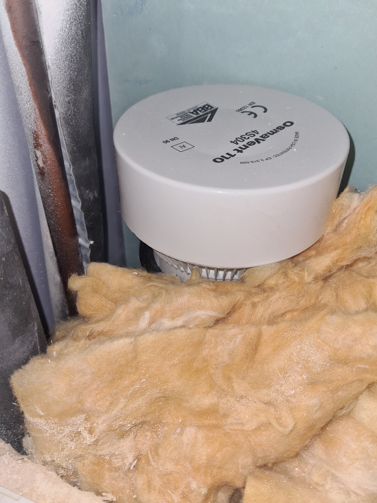

Hi, I'm on the top floor of an apartment. Next to the kitchen there is a communal area for pipes. That is making a gurgling noise. If I use the sink it makes it. It also makes a noise ramdomly. Assume people at the bottom are using the bathroom etc. But the noise is constant. Attached is picture.
The plumbers have said it is because of the osmavent 110 that is fitted there. It allows air in so we don't get nasty smell. While it allows air in it can make that sound.
I've tried to insult it. Assume if I insult too much it will block the vent and not allow air in and il have trouble with the smell.
Hope I've explained this well but not sure what I can do on this. There is nothing wrong with my sink. It's the communal pipes fitted in my kitchen which run down to the bottom of the building. This gurgling noise runs for hours and it's like water is boiling.

Don't insult your AAV- it's trying its best. They're sensitive things.
Certainly don't block its access to air.
Rather, try pulling it free of the soil pipe (it will pull out) and see if the noise stops.
You'll get some drain smell while doing this.
Then you'll know if the problem lies with the soil stack/drain, or is entirely unrelated.
You could try replacing it with e.g. https://www.screwfix.com/p/floplast-push-fit-air-admittance-valve-grey-110mm/78150 but I suspect that if the noise is constant you may have partially blocked or poorly-designed drainage.

AAV=air admittance valve. Clue in the name. Needs air to admit.

Test first.

An AAV should be practically silent in operation, it certainly shouldn't be making a gurgling noise. Any reason there isn't a vent up through the roof? A soil stack in a multiple dwelling/flat/hi rise building should really be catering for positive pressure release as well and the stack should be designed for such. That would either be using a normal vented stack or a secondary vent design.
How many properties are in the building below you?

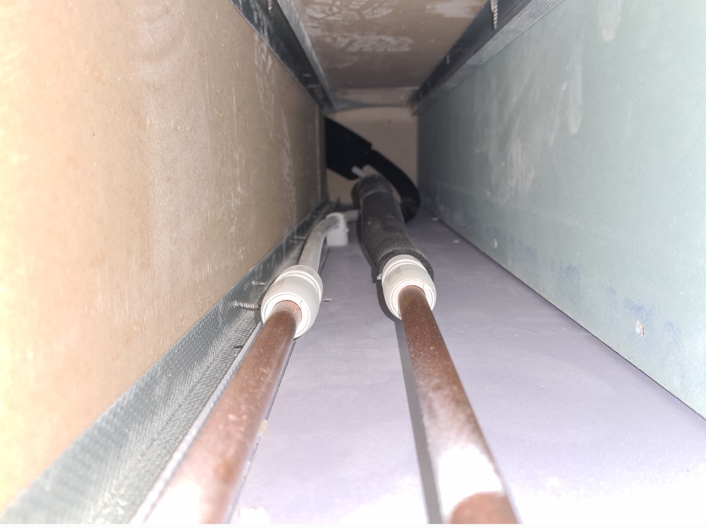

This is what it's at the top attached pic . I'm not sure why there's no vent at the top. I can ask for it to be moved up.
There should be around 6 properties directly below me and no one has complained of this problem. Seems like only me.

If there are 6 properties below you and they're all on the same soil stack and if there is the potential for toilets as well as other outlets to evacuate into that stack at the same time then it should be properly vented to cater for positive as well as negative. That's a pretty basic design/installation flaw.
It just isn't right and shouldn't have been passed like that with an AAV on it.
Is it a new build?
