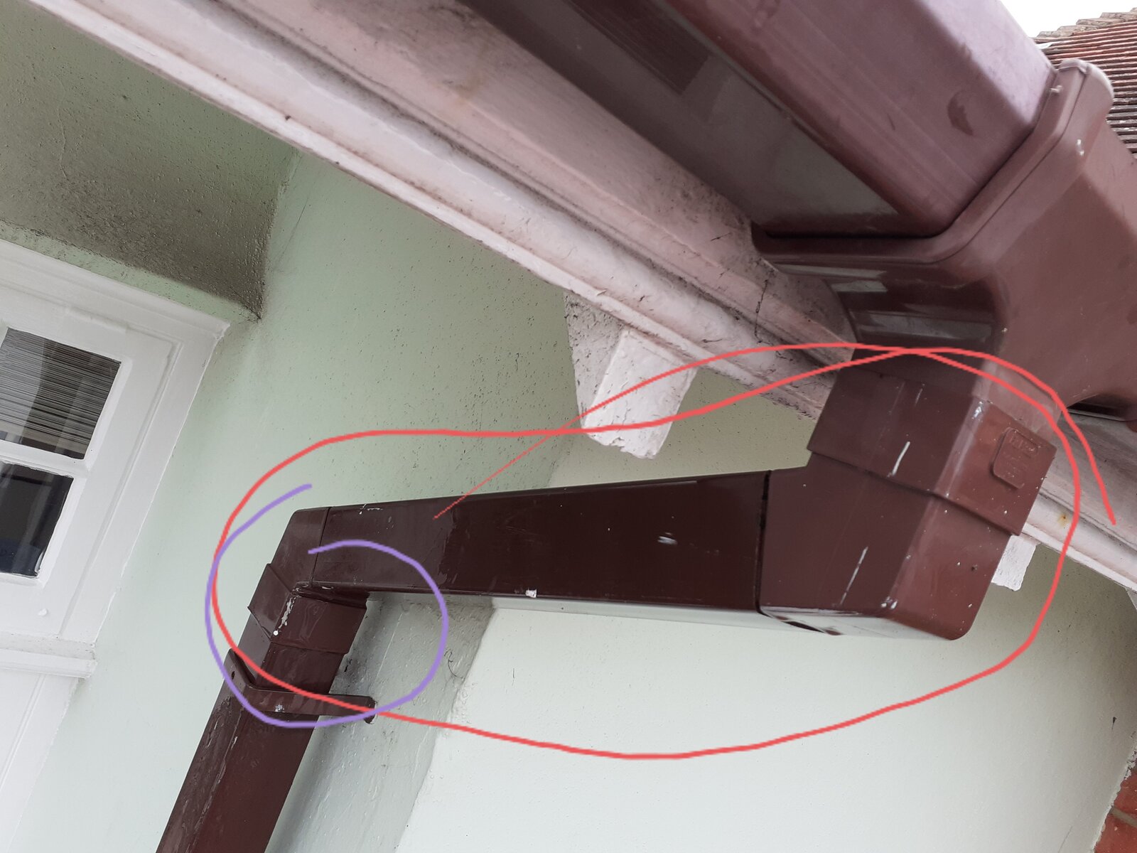

Calls out tradesman to fix leak. Wraps tape around it.
Probably but now you have turned the short length of pipe upside down.
I turned the whole bit circled in red around which shouldnt make any difference. IF I can get up there I'll rip off tape and switch the little bit circled in purple around I guess

I turned the whole bit circled in red around which shouldnt make any difference. IF I can get up there I'll rip off tape and switch the little bit circled in purple around I guessView attachment 225452
I was under the impression you had taken this section off and had put it back upside down/or just put it back together wrong.
Nah. Turned whole section round which I guess makes no difference. It was always wrong way round going into top of downpipe. I guess get up there and put it male into female like it should be. Bloody high though
