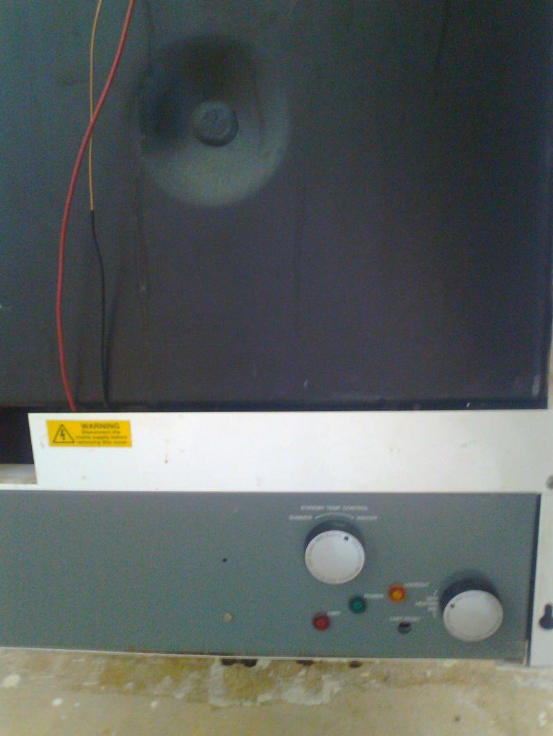

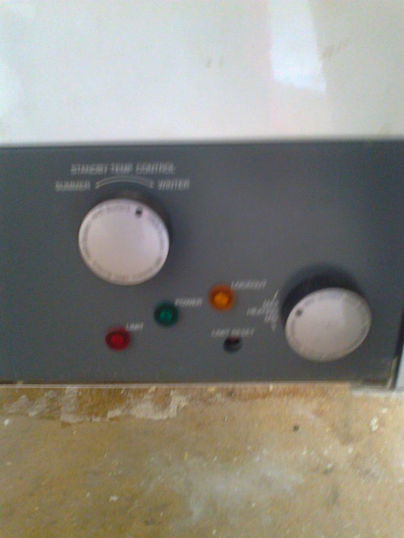

Hi,
THe h/w and central heating in our rented house runs on fuel oil, controlled by a Wallstar boiler. As of last night, the h/w and central heating have stopped working. We have plenty of fuel oil. There are no lights on the boiler, but it makes a noise, as if it's working, if we turn the heating on. It didn't make as much noise before when it WAS working properly. Any ideas/advice would be hugely appreciated?

If you can access the burner itself, within the boiler casing, I think you'll find the lockout lamp on. Can you check this, and press it to reset?

I remember taking the outside casing off to press a red reset button before after there'd been no fuel oil in the tank, but couldn't see a red light when I looked earlier - would this mean that there's no red light showing because it doesn't need resetting?

If the burner lock out lamp isn't illuminated, then the burner is ready to go.
Its therefore being held back by thermostat issues, either internally or externally fitted to the boiler. There may be a overheat thermostat within the boiler casing - I'll try to remember!
If your boiler is a combi, make sure there's about 1 bar showing on the pressure gauge.

I don't know which actual Wallstar you have, but with the front casing off you should see the red circulating pump and the pressure gauge (with one black and one red pointer) just behind.

No, we need pics of the boiler guts, really......
Have you found a switch marked Normal - Test somewhere?

I think there's one in the back bit of it that's attached to the outside of the building - that sound about right? can check it later when my other half's home/baby's asleep: bit complicated at the moment (!) - if there is a test switch there, should it be set to anything?
