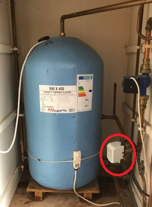

They are usually close to the hot water cylinder as per the example below.
Sorry I got confused earlier and thought it was you that said you had a ZA5 actuator. If you have an old system (40 years plus) you may not have motorised valve/s

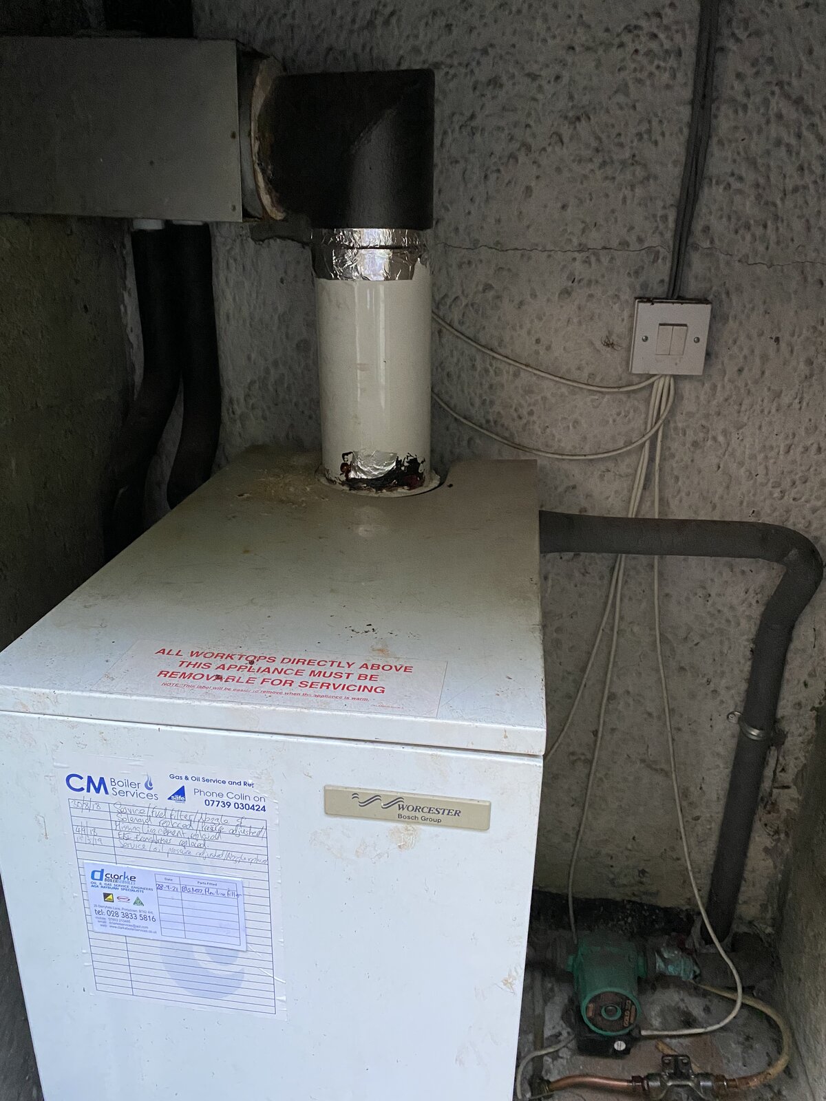

This is our set up. Definitely can’t see any motorised valves anywhere

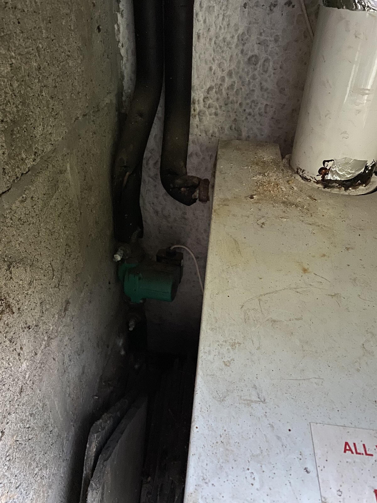

Electric feed to the boiler and two pumps (wilo gold 50). Other fuel line feeds the oil fired cooker
CH and HW set to come on at 4pm, only HW worked. Pipes connected to the pump located to the right of the boiler were cold to touch, pipes connected to the pump on the left were warm/hot - this might mean nothing whatsoever...
Two pump system fairly common system on older oil systems.
If installed correctly somewhere you will have relays so heating and hot water can work independently.
