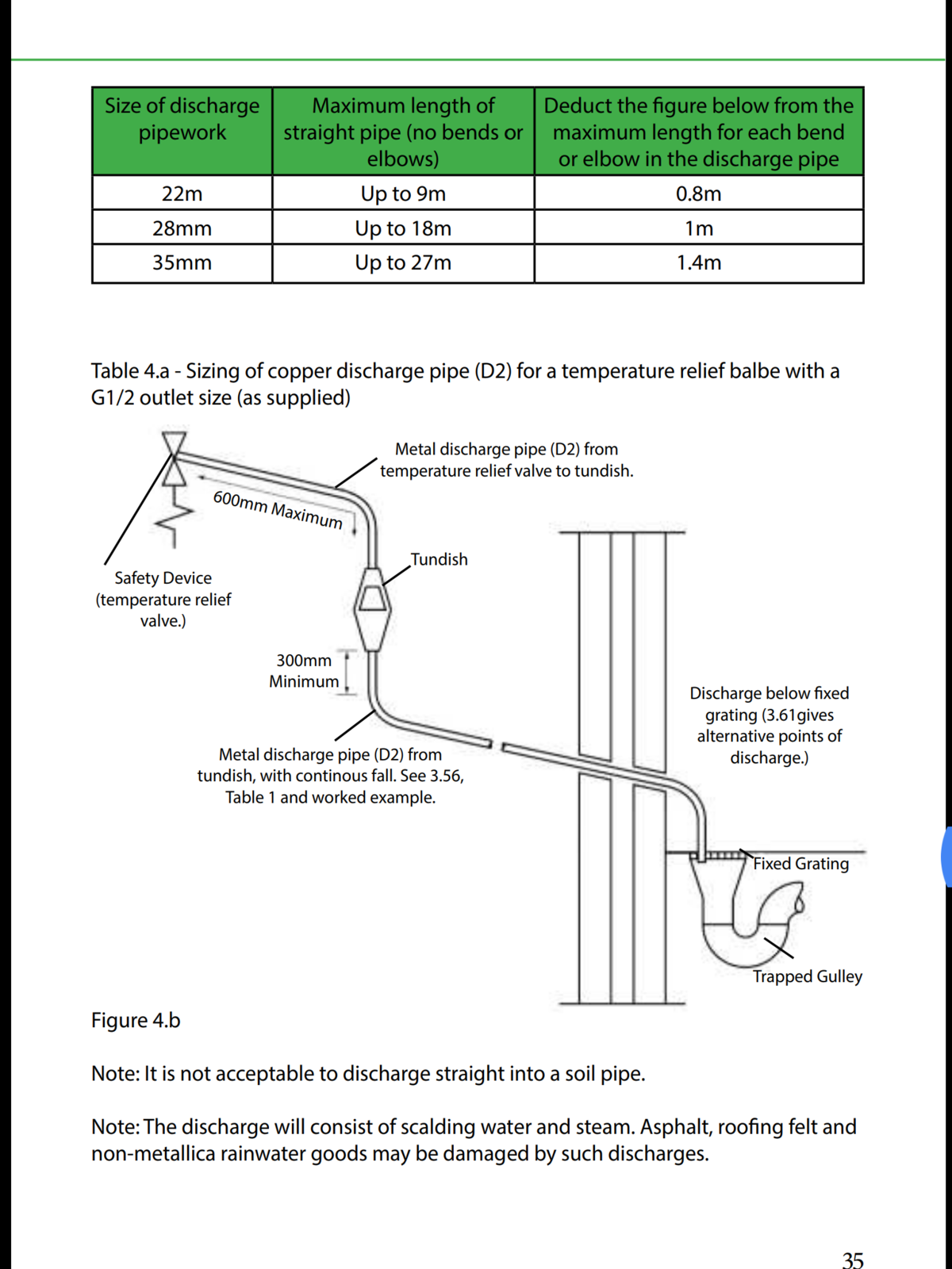

They install is a disgrace. D2 pipe is wrong as well as the mid position valve.
Can't see the cylinder expansion vessel. Is it a cylinder with an internal bubble?
Oh dear. Can I ask what is wrong with the discharge pipe, should it have been 22mm up to the tee off? I did think that looked odd.

What is a balbe ?
Metallica is an American Heavy Metal Band,
Lets hope the attention to technical accuracy is better than the proof readers attention to the text.
And what is there to prevent steam and scalding water coming out of the fixed grating and maybe harming person or property in the vicinity of the grating.
