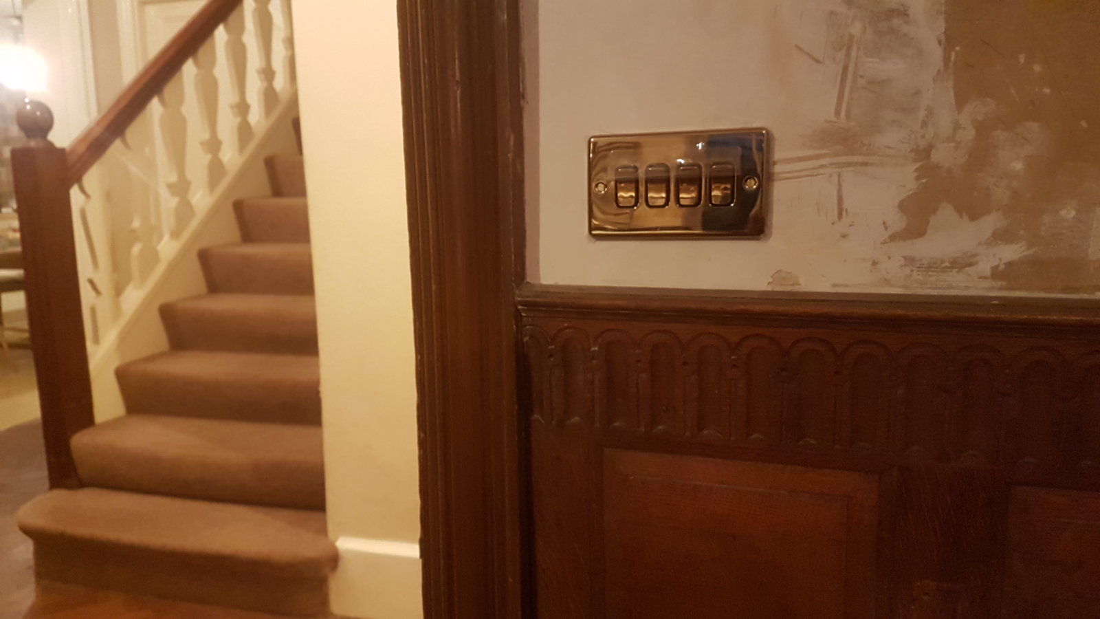

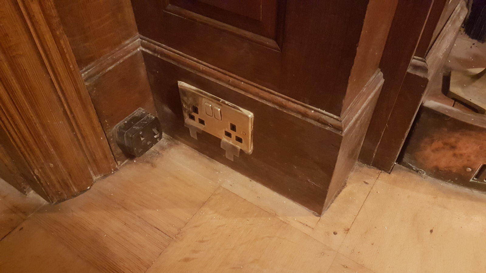

Epic thread recovery, but we have just used it throughout our re-wire project and are very happy with it.
White moulded throughout, bar the sitting room which is the polished brass, electrician seemed happy enough with it, other than lead-time issues on the brass at his local outlet which we ended up mail ordering from directtradesupplies.
The depression in the middle of the switches is slightly funny, and to get twin intermediate switch you have to use the grid switches, but otherwise no issues at all. Look smart and have a crisp action to them.
Used the euro plate, with modals (actually rebranded Triax) for speaker and network outlets, and for the inlet got MSGCustomAudioLtd to machine a double blanking plate to make a custom 12way speaker plate.

Brass! That’s as retro as your thread ressurection!
Aye, but it looks right with the oak paneling..... ...and positively modern compared to what it's replacing.
