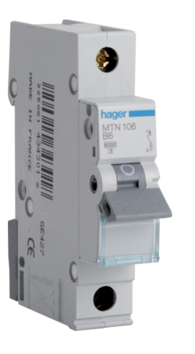

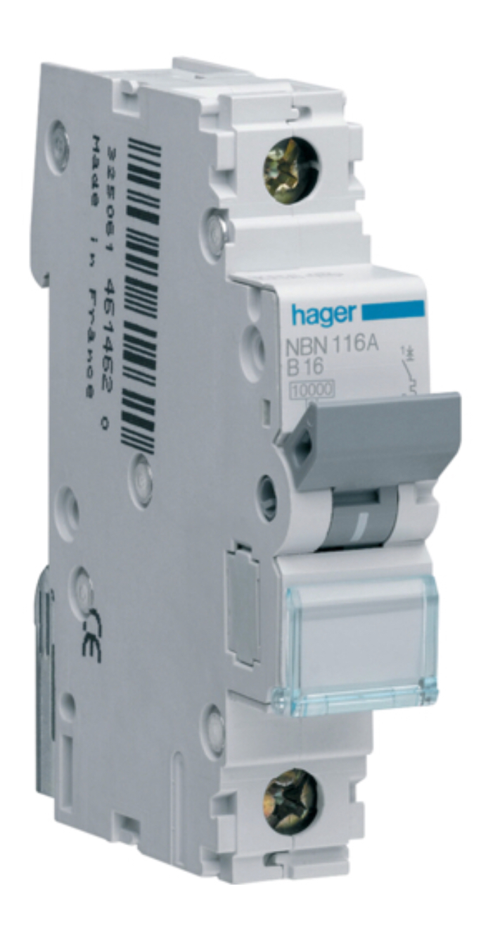

Hager mcb type MTN and NCN same bus bar.

NCN can be fitted into single phase domestic consumer units just as MTNs can be.

As for the mcbs MTN is a 6000A breaking capacity and NCN a 10000A breaking capacity, i always thought the profiles were the same
They are, save for some superficial notches around the terminals
