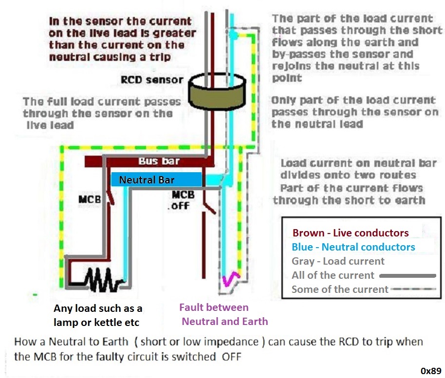

Cowboys who "work" on electrics and even some electricians are not aware that an RCD can trip even when the MCB for the faulty circuit is switched OFF.
Current from a load on a perfectly good circuit divides at the Neutral bar in the Consumer Unit and the resulting un-balance ( Live =/= Neutral ) at the RCD will cause it to trip.
This can make fault finding very difficult and time consuming. The only sure way to locate the fault(s) is for each circuit to be fully isolated ( Live and Neutral disconnected ) at the consumer and insulation resistance test and earth leakage tests carried out on each and every circuit.
