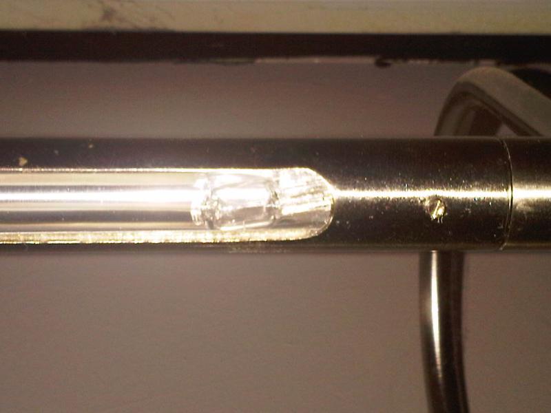

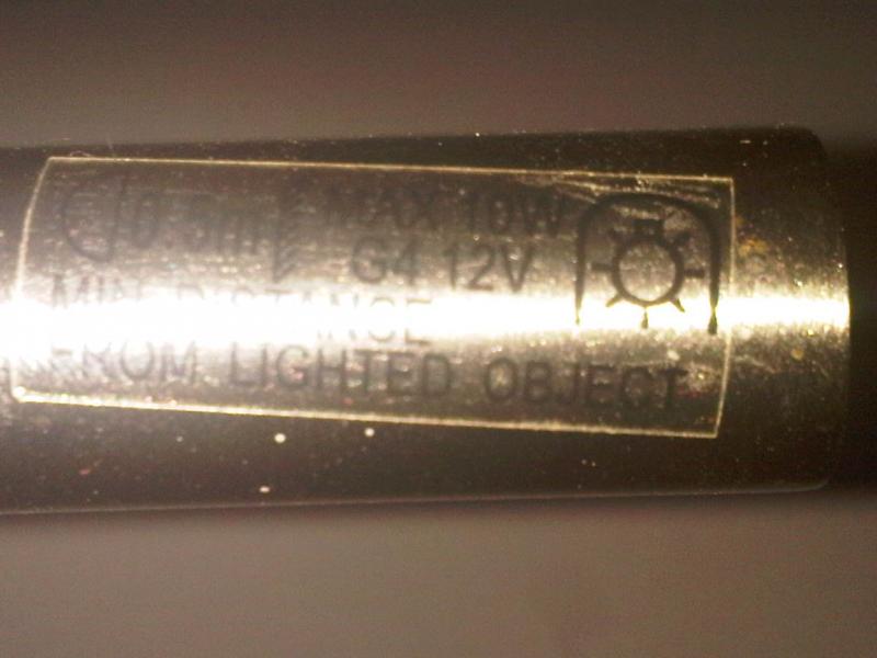

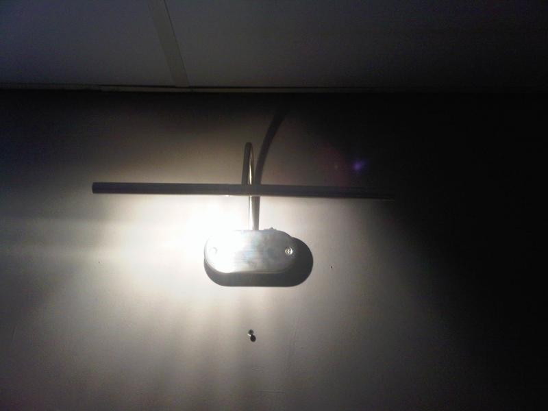

I have been back over to the place and it seems that 2 more of the same fittings are having the same problem that are on on the same wireing loom and even on a different floor. all seem to work fine with just 1 bulb in on either side of the fitting in exactly the same manner. the bulbs fitted all seem the right bulbs for the job so i took a couple of photos to see if any of you guys can spot something i am clearly missing. from what i can see the bulbs fitted look to be 12v 3w and of course the 2 pin push in type.
[/img]
Both bulbs should be similar to this:
http://www.screwfix.com/p/osram-eco-halosta-halogen-12v-g4-capsule-7w/82035
If these bulbs are all correct then the only other option as I said earlier is that the wring is wrong - either internally (the lighting unit's wiring) or the external wiring providing the power.
Next stage is to open it up and photograph the wiring inside the unit.
Given that the problem is the same across a number of the same type of lights I would plumb for the fact that the light unit's wiring is wrong.
Its looking like i am going to have to turn the power off and have a look inside. might be a while before i can do this as some equipment that has re start problems when shut down is also run from this supply and to be honest the bloke who labeled the fuse box up must have been drunk when he did it or had dyslexia or something as nothing seems to relate to the listed item.
