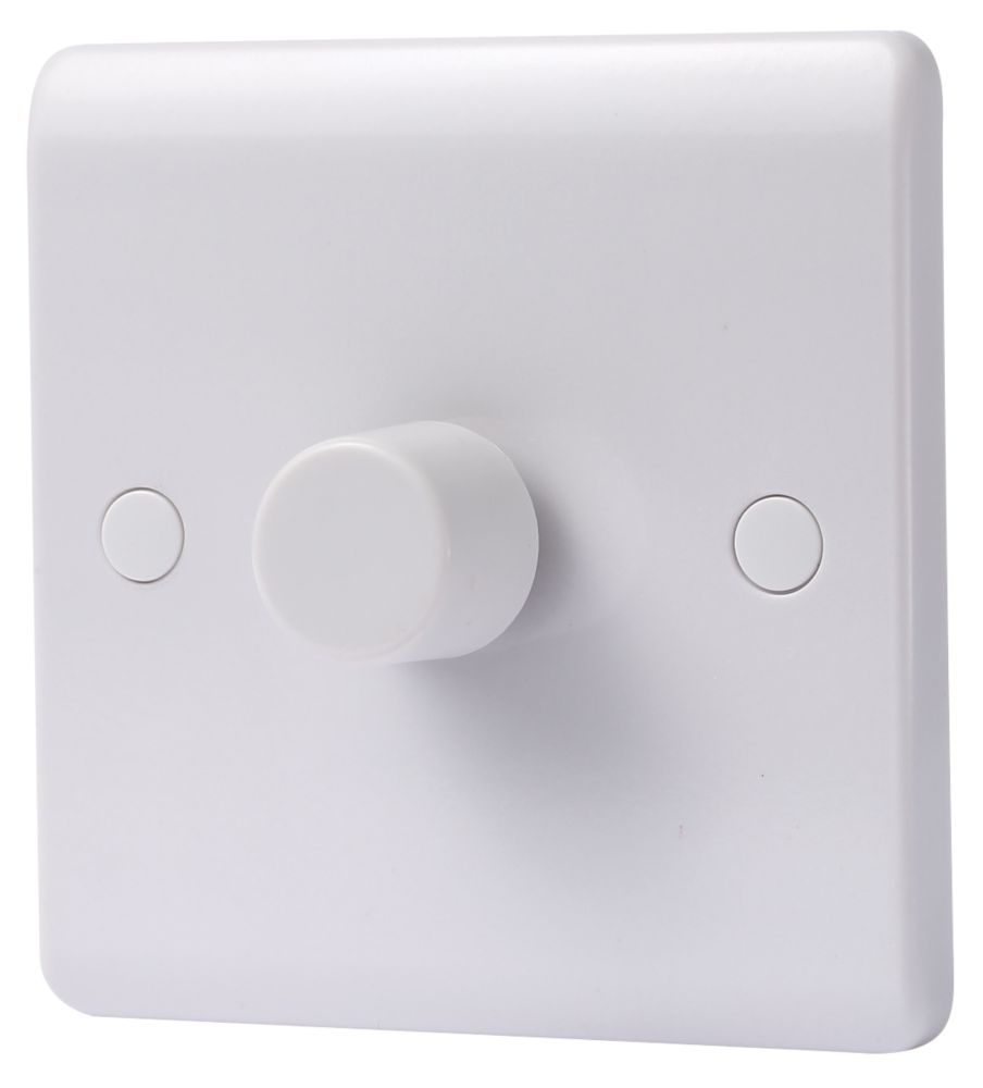

Hi
I have a 2 gang dimmer switch controlling 2 ceiling light, both halogen bulbs.
I want to change one of the ceiling lights to LED bulbs and leave the other same halogen bulbs.
Can I use the VARILIGHT V-PRO 2-GANG 2-WAY LED DIMMER SWITCH WHITE to control 1 LED ceiling light and 1 halogen ceiling light?
Don't forget, most dimmers can be dismantled, so you could remove one dimmer module from the plate, and fit a different module.
Very good point. I have a few gridswitches for odd needs.
You don't need a grid switch.
From your current 2 gang dimmer you can (often) remove one if the dimmer modules and directly replace it with a Varilight pro module (as suggested by sparkwright).

Will I be able to do the same with this dimmer?
Sorry, Cannot tell.
Normally I pull off white knob, and there is a nut under it onto the dimmers spindle.
So in most cases yes, but cannot be specific. (I changed lots of crabtree dimmers to take Varilight pro dimmer modules).

Why can't he use a two gang Varilight Pro to control a led on one Gang and a halogen on the other Gang?
I was going to suggest the following for this very purpose as I thought the Varilight Pro was suitable for both halogen and LED (when connected separately).
John
Not a problem - made me double check. :)
On re-looking just now the Screwfix link actually had a spec and shows that the Varilight Pro is suitable for the following:
Max. Dimmable Load (Halogen)200 W
Max. Dimmable Load (Incandescent)200 W
Max. Dimmable Load (LED)120 W
So I would also suggest using the 2 gang Varilight Pro I put a link to.
The Varilight will work with halogens, however when the halogen lamp fails you can expect the dimmer to be destroyed.
So the best thing for me is to buy the 2 gang Varilight, swap one of the LED modules with my current halogen. Then I can use the removed LED module in another light switch.
